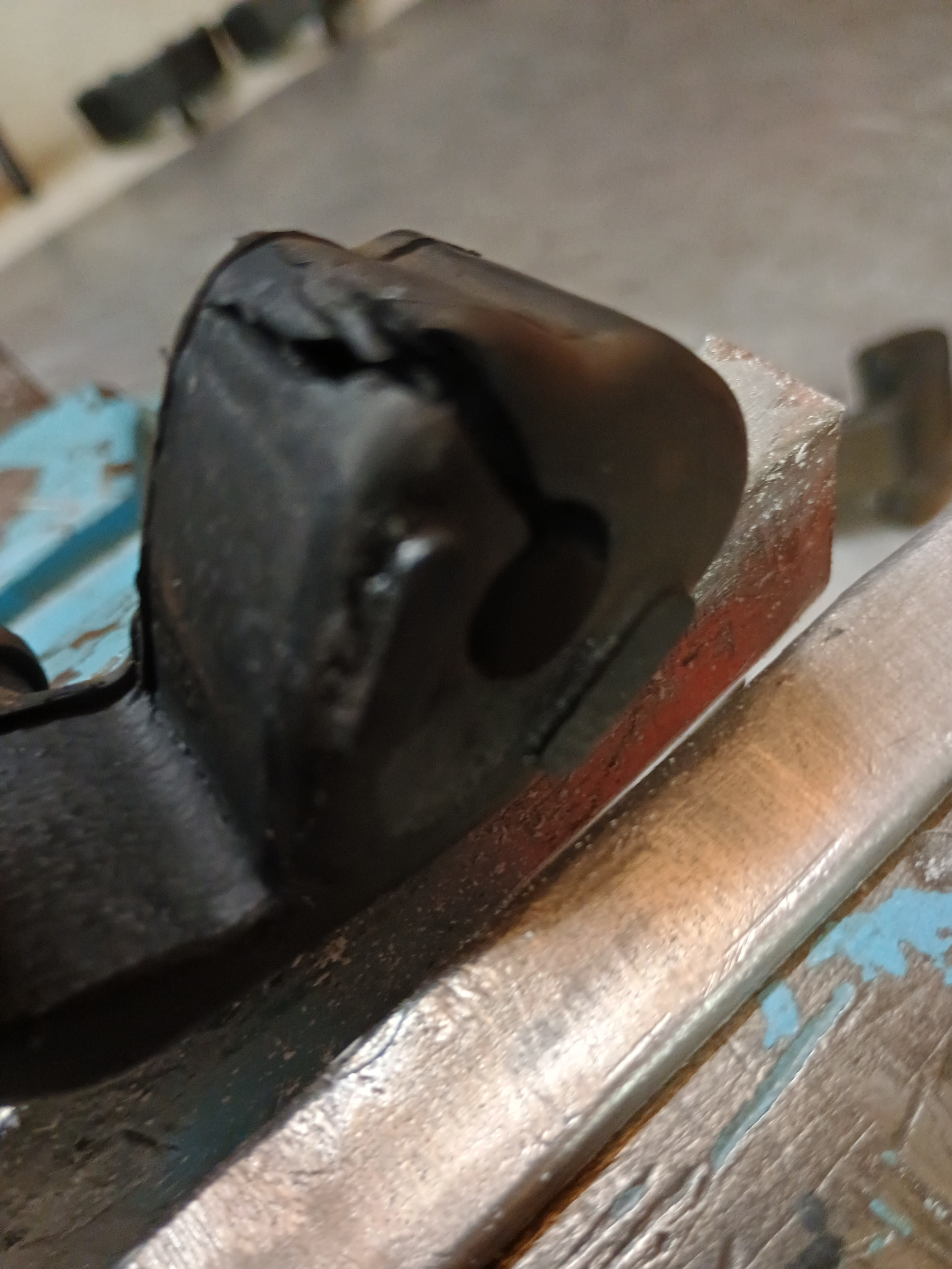

Evening All, just curious if anyone else has come across this issue ? I have just been carrying out some winter maintenance to my V85TT , greasing driveshaft splines etc .. and noticed that two of the five cush drive rubber blocks have completely failed!!? (These same blocks are fitted to several other models including the 850 V7 and 1400 Calis).I have never had to replace these in a bike before in 50 years of riding. The bike is a 2021 with only 11k on the clock! Next problem has been finding some! I have tried all the UK stockists Gutsibits, Fowlers, MSC etc.. and they are on back order with expected lead time of a month! Luckily Stein Dinse in Germany has two on the shelf (which are now on the way to me) What is it with Italian parts? I can get spares for my Enfield interceptor within 5 days from India!? I wonder if they fail because of the hole in them? Most cush drive rubbers are usually solid. I’m curious! Cheers Bill

It just seems odd to be breaking up at such a low mileage, they are around £17 each to replace (that’s if you can find any :joy:)
baldrick told me (when discussing my cali) that making a cut in the rubbers can make the drive a bit softer. I assume that, or just saving rubber for cost reasons, is the reason for the hole.
with the low volume of bikes made by guzzi I doubt it is cost reasons really.
@ Sidthedid, it will be done to provide additional cushioning in the cush :slight_smile: . It was common practice to drill holes in the solid rubber pucks, as otherwise they became hard as steel and didn’t do much to prevent damage to driveline splines. I don’t know if other Guzzi models had rubber pucks with ‘factory holes’ or if this is a new feature on the more recent models? The V7lll rubbers are solid so it’s been introduced with the 850s.

On a very long trip - Greece, Balkans and more - V85 had gone incredibly jerky with a load of lash in the drive train. It was getting difficult to ride it giving a real kick in the seat when closing the throttle. On return the immediate problem was a couple of broken spokes but after removing the wheel to have a look see I spotted the very worn out Cush drives. Loads of free play, they were sticky and horrible. I ordered from Teasdales which took about 2 weeks in the end, along with the spokes. Bike transformed afterwards.
