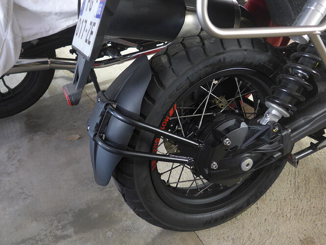

Another alternative is a generic rear guard that looks a bit like the BMW ones. It’s sold on Ebay as ‘for Honda NC700’, is fairly cheap, and can be adapted (some hacksawing, and some new holes need drilling) to fit the existing threaded holes in the Bevel Box. But beware - they must be positioned carefully, and relatively close to the tyre, as they will otherwise foul the tail (reflector)!
I personally am quite happy with the Aprilia front guard as an additional one, I’ll post a piccie once I am finally finished with sanding and painting it.
I am also quite happy with the generic Chinese NC700 guard in the back. No painting required (though I did have the bracketry powdercoated after adapting it), so it is installed already. I re-post the pic, as the other one is hidden in the ‘Sump Guard Bolts’ thread…
And believe me, it works! No more mud on my back, or on top of the luggage!!

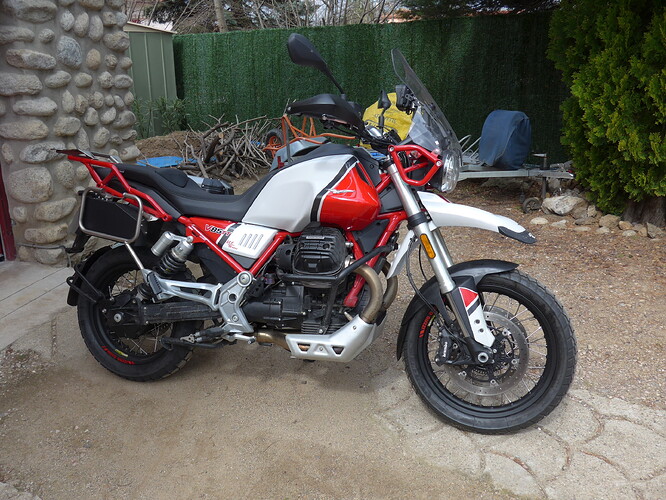

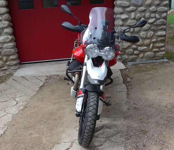

… and here finally my take on the Aprilia front guard.
Please note:
  1. Yes, I know she’s dirty - I encountered 10 miles of wet road last time we were out. And I am not overly fond of cleaning.
  2. Yes, I know I’m abysmal with sanding, masking, and spraying.
    So don’t look for the details, this is merely intended to give a general impression.
(The colour used is not a 100% match, but close enough for me. It is “Nissan ZHJ Arctic White Effect”. The triangle and stripe come as transfers, together for each side, as genuine Guzzi spare parts (cost was €8.- each side)

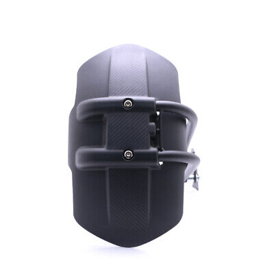

This one looks like mine:
Sorry, cannot find the one you mention.

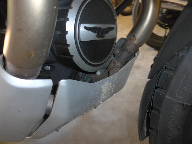

For the first time since fitting the Aprilia mudguard (with the cheap Spanish extender), I’ve been out and encountered some wet spots on the road. As one can see, despite me going rather slow, the bash plate is still covered up to its top, but the alternator cover has remained clean - which was the main intent of fitting the additional guard.
I personally find it amazing though at how steep an angle the moisture is getting thrown up, and as anything that gets thrown into the ‘beak’ will be driven backwards through the slots by the air, I’ d suggest to be careful when considering all the different options and designs… The engine front plate has by now proven in multiple cases that it’s finish is NOT up to the abuse it gets without adequate additional protection!
