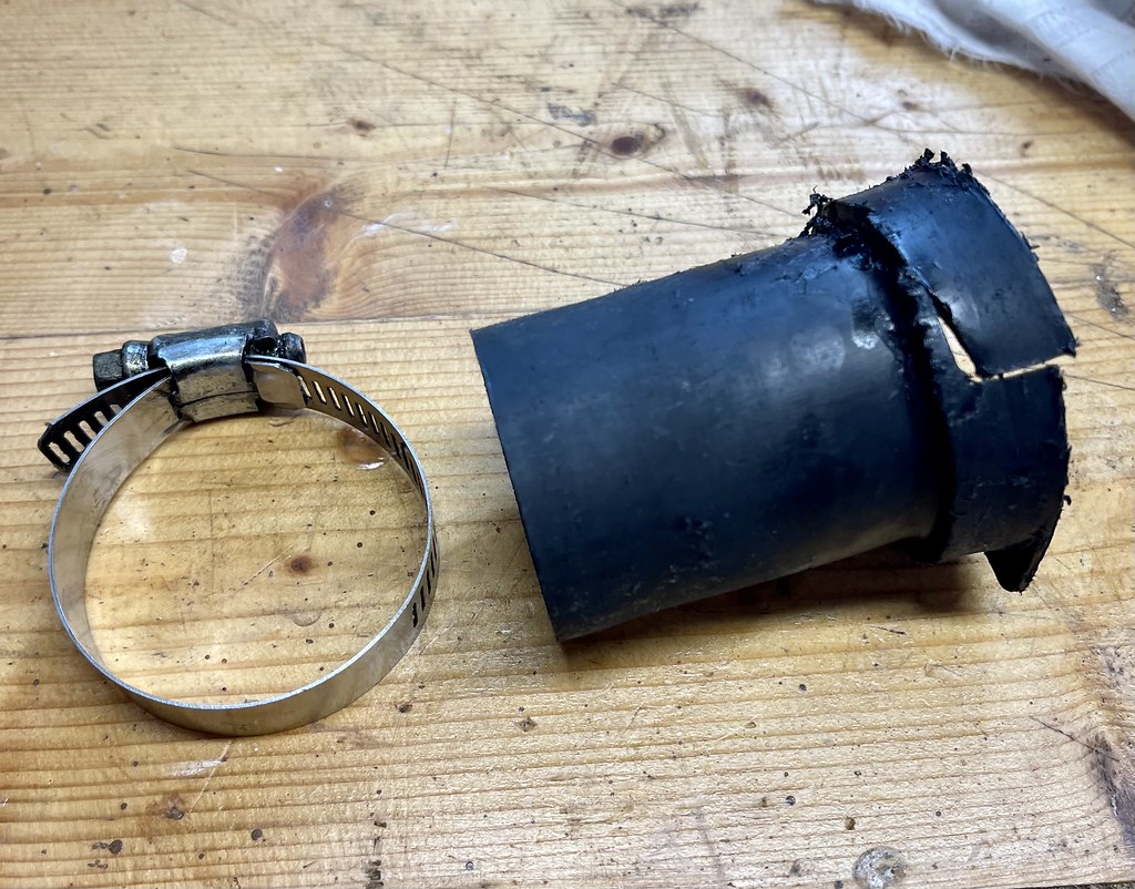

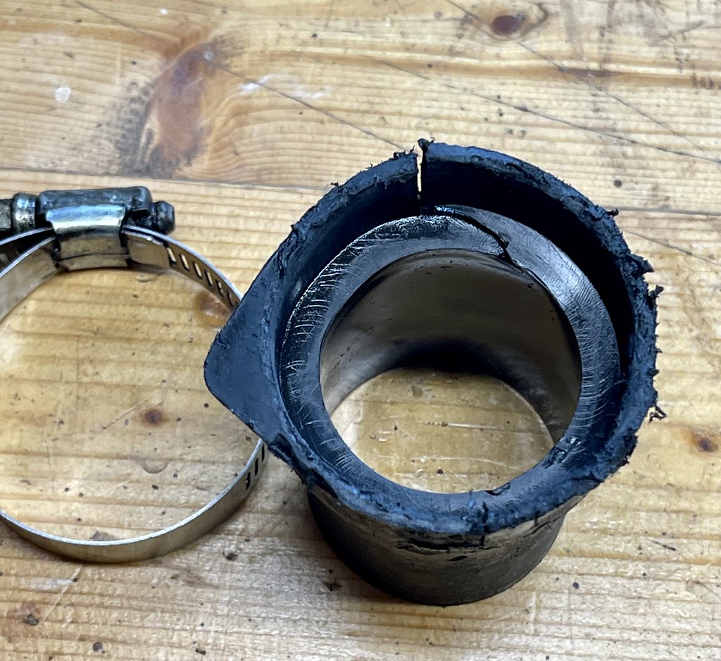

The inlet pipe to the air box (part number GU19114460) is in a bit of a sorry state. The flange into which the carb face fits is fractured, and the rest of the tube looks like it has been hammered all over with a little help from a screwdriver or a small chisel. With the retaining jubilee clip loosened right off, it should be a firm sliding fit into the air box, but of course it is well and truly jammed in there.
The inlet pipe:

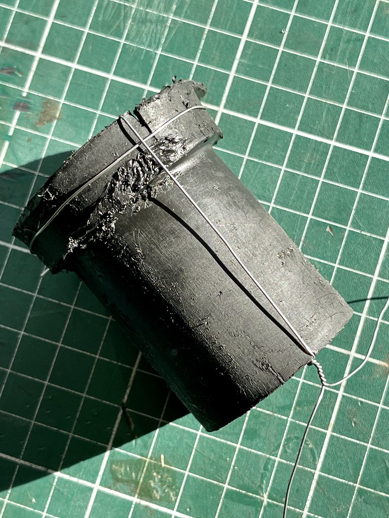

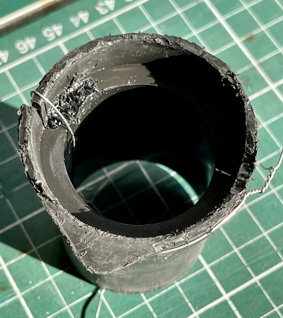

Oh dear. I scanned the usual sources for a replacement, but didn’t find any. I got some advice from a guy called Barry on the MGCGB forum, but the ones he found on eBay were in the USA, and the p&p price was twice the price of the tubes themselves. So I decided to have a go at hot welding the inlet tube myself. The tube appears to be made of a hard plastic, so I set to with some wire to pull the broken part together, and an old soldering iron.
The result doesn’t look great, but it was effective and looked better when cleaned up with a craft knife after I took the photos:

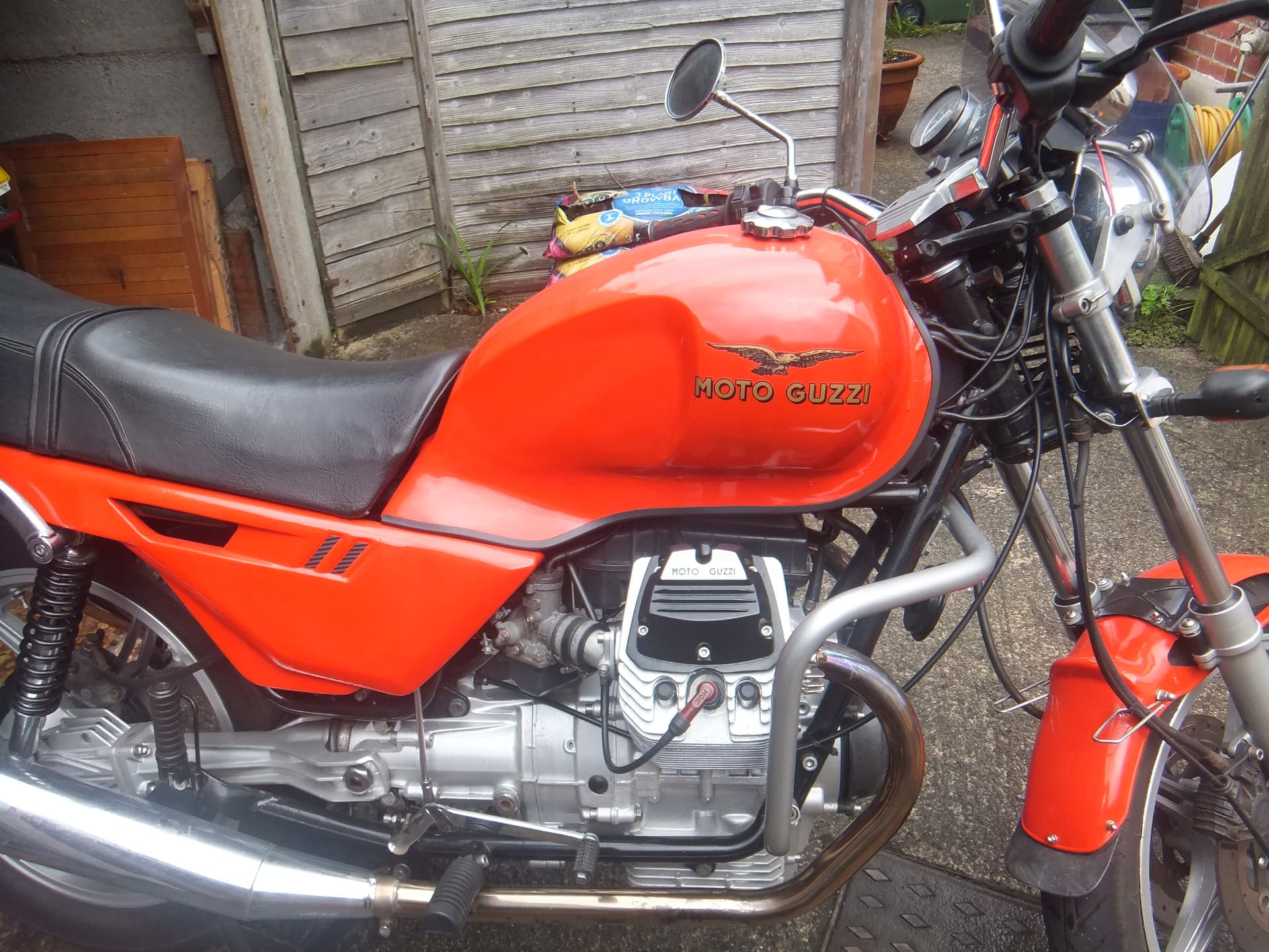

Hi Bob, I see you are having some issues with your 750 T, I have a 750 Strada 1994 and not dissimilar to yours. I too had a tank that serve better as a cullender than a tank, having made many attempts to braze the holes up it finally cracked so I gave up and purchased a Snell Bobber fuel tank raw for £68,99 , it comes with a locking fuel cap but only one outlet, if you are handy with a blow lamp fit another outlet, I added some u shaped fittings and extended the skirt to match the original, I will try to send a picture, if it doesn’t work send me your email address and i will send it that way.
I found that using BPR 6ES plugs work so much better, they are the ones with the extended electrode. Does you bike have electronic ignition or points ?, timing I found very critical.
If it has electronic ignition then you need to properly earth the pick up plate at the front of the engine at the end of the cam shaft, you may need to give me a call as I can explain it better. My bike is now sorted, in fact it goes better than when I had it new, i took it out the other day and it easily topped the ton. Bob Smith 07989 612877.
