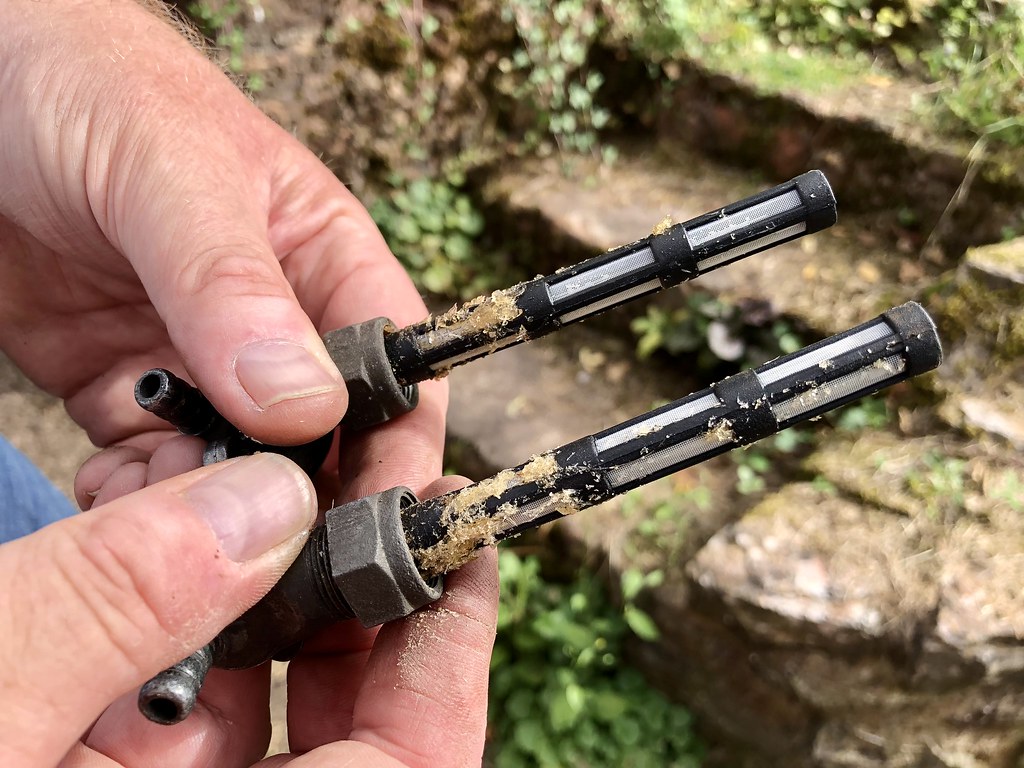

- check the petrol filters on the fuel taps - I may have imagined it, but I thought I heard a rattle when I removed the fuel tank…
