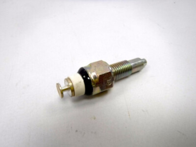

The switch is a plunger that sticks into the gearbox and touches on a bump on the selector drum when it is in the neutral position. It has either got mucky and so is not making contact. It looks like this … It should be possible to remove it and test it out with a continuity meter

I tried switch-clean, but nothing would make the switch adopt the “neutral” position, I e. connecting the terminal to ground. This was the only used switch that Gutsibits could sell me, for £27, so I’ve sent it back for a refund.

Is it possible that the sealing washer around the neutral sensor is too thick holding it too high to contact the ‘shift cam’?
It entirely is, and by adjusting washer thickness you can fix the thing temporarily. Why temporarily? Well, the switch should work as is, but when it becomes moody, it is question of time… and its price reflects the market demand, mind! I know one Monza owner far in Europe able to dismantle them and fix, but this is clock master, with tiny lathes etc. Would be great if somebody with relevant skills here in club would give us a wave - we definitely can provide plenty of faulty switches to play with!
It’s working now! I had to insert another washer under the switch, which then brought it into correct adjustment. Result!
