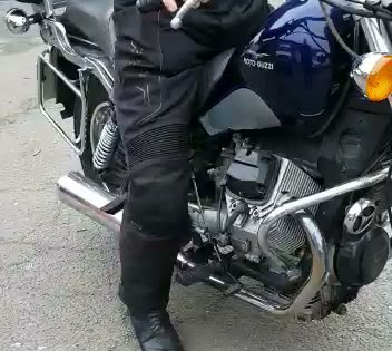

This is a crappy video of me on the bike trying to record the noise on a ride by in the car park. I’m not normally this grumpy looking (honest)
