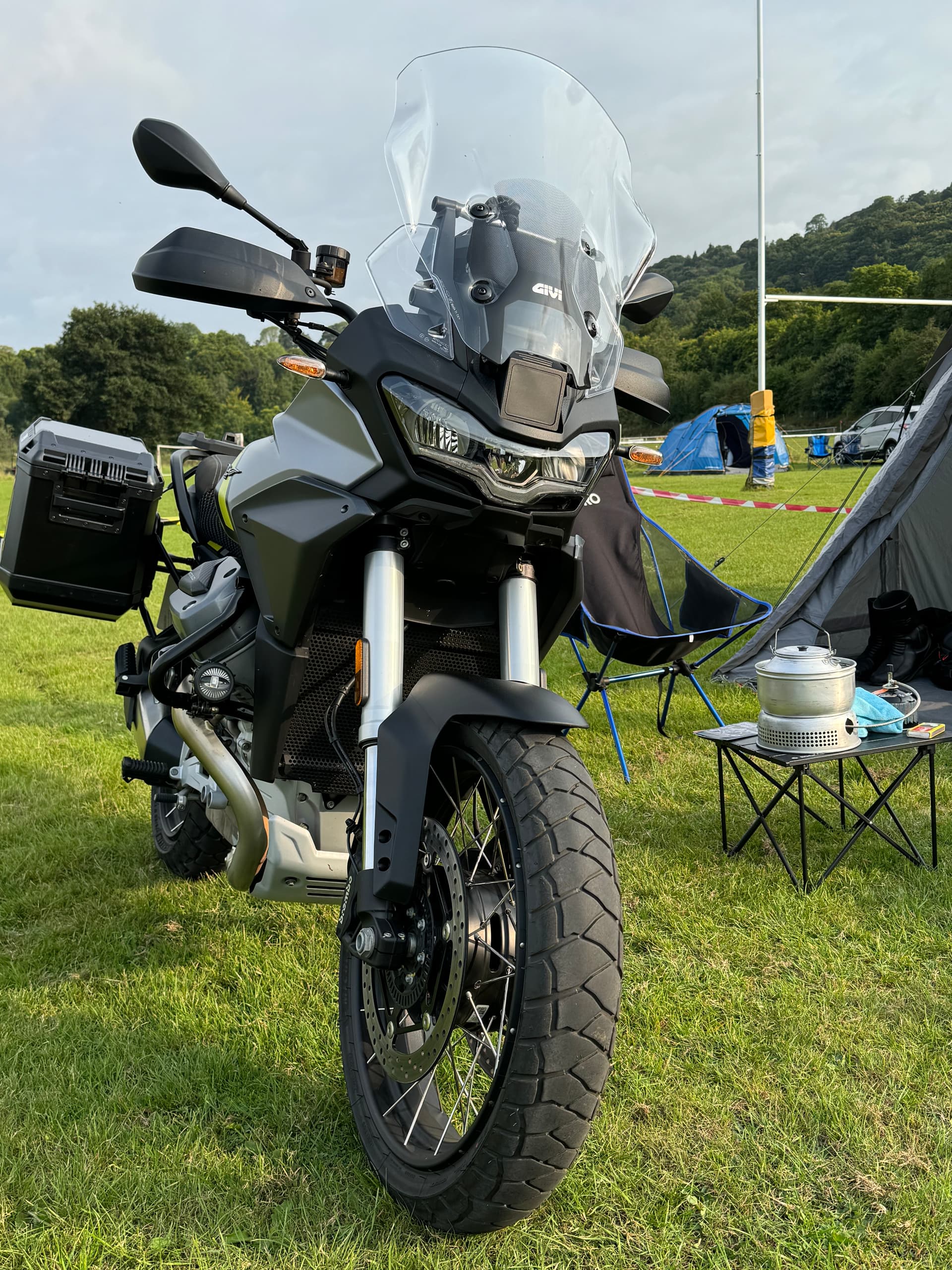

Hi GuzziEagles, what was the small adjustment you had to do to the screen? I see it’s a pff bike which the screen is not intended for. Has this caused any issues?
DavidP, the only adjustment made was to reshape the bottom of the screen to avoid the radar unit. see photo.
I used the original screen as a template to mark the new screen. Then used a Dremel to cut, shape and 1st sand the screen. Sand with 800 and 1200 emery paper. Finally polished with Brasso wadding.
Impressive! That’s a very neat job. I’m torn between giving it a go and waiting to see if a purpose big screen for the PFF comes in the market. Guess I’ll leave the decision until the spring. :blush::+1:
I have tried this and must admit, I’ve made a very professional job of adapting following your advice thank you. It works very well and does significantly reduce wind noise. My problem is that most of the bikes I ride either have bikini screens or none at all and I don’t think I’ll get used to looking through a screen on a bike, so I’ve removed it for now and may sell it if someone wants to give it a try? If you don’t mind looking through a screen (only when it’s in the high position), it does resolve the noise problem.
