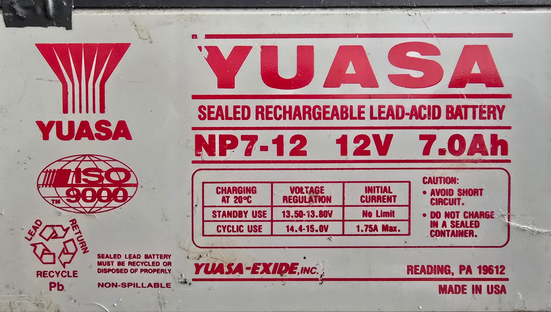

yuasa do good ones, i think the correct term for them is AGM, I’ll find one i have sitting about and check
I have a pair of these small ones i used with a spotlight, and I once had a bank of them wired in parallel hooked up to solar panels. they do a range of sizes, up to big beasts for motorhome use, running tvs and whatever. also used in rally cars because in a rollover they won’t spill/leak.
