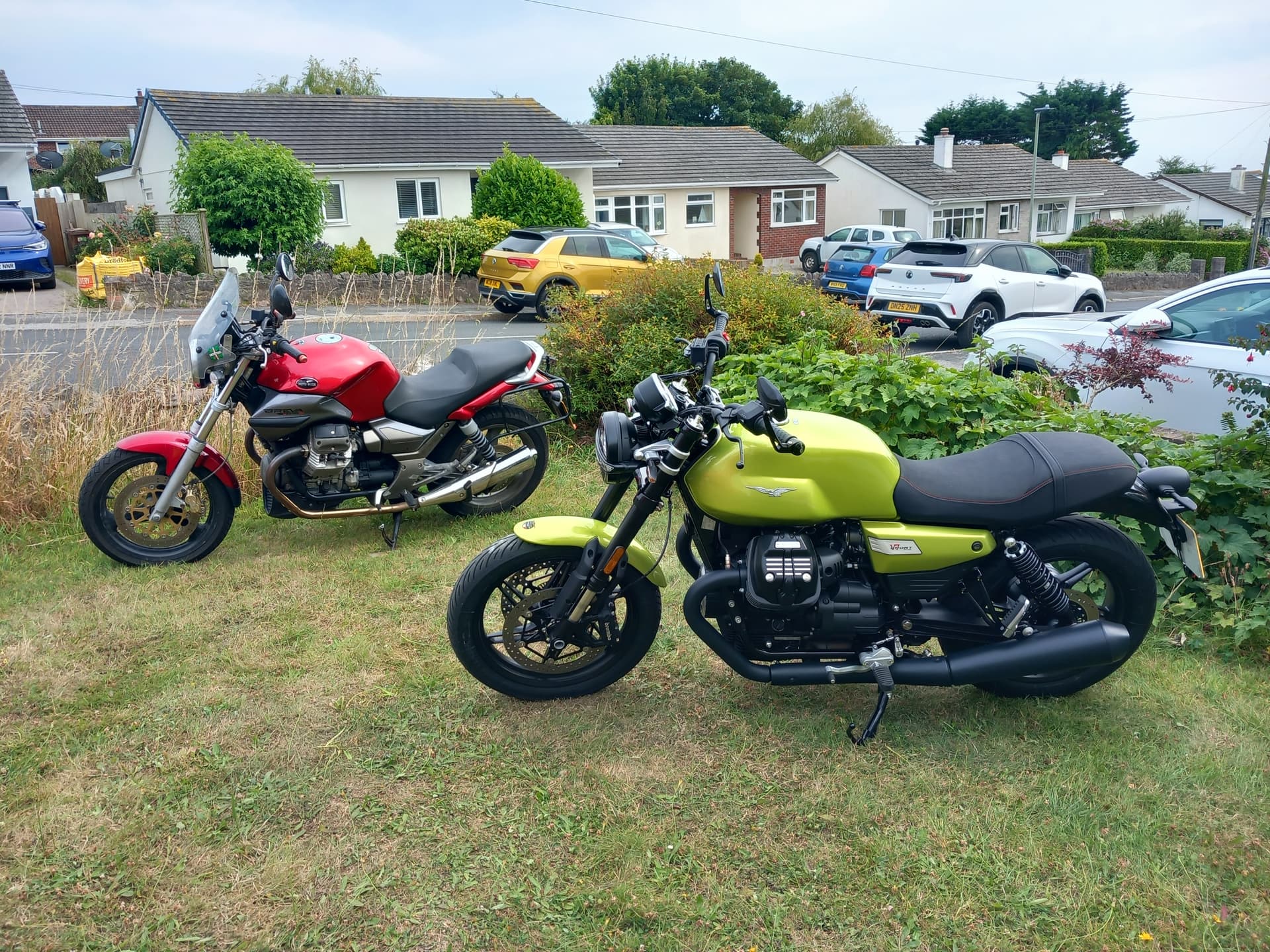

Picked up a V7 Sport today. 7 miles on the clock, now 130. Loving it so far, but coming from a Breva its a bit of a technological leap! The modes really are different. No idea how I turned the TC off, but i did! Getting a screen and centrestand for it, and HB panniers and racks.

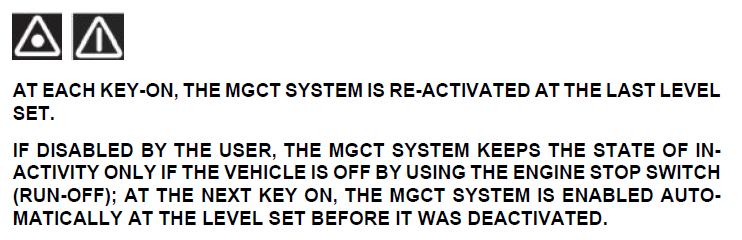

TC is controlled by starter button when engine running. Turned off by holding in starter button, I think. But doesn’t it come back on next time you turn key on?

Funny enough 2 days in and nearly 200 miles and I am starting to understand the appeal of the tech, to an extent. Once its run in and lets say I was on a magnificent smooth dry twisty road, I might go for Sport mode. Most of the time its going to be Road, or if in typical Devon weather, Rain :slight_smile: The offset clock again thought would annoy me, but 10 minutes riding and I don’t notice it! Compared to the Breva it looks lower but feels more dense. When you are on it, the tank looks small but its actually pretty big.
No TC warnings or anything like it in the 66 miles today, which leads me to think I either activated it, or turned it off accidentally. All fine today.
From the user manual..
‘Last level’ only means modes 1 or 2.
So in other words, if you turn off MGCT, it will always be re-enabled next time ign key is turned on. Using the kill switch doesn’t change the setting, only key off.
Key on, ABS and MGCT both flash. Once engine started and bike moving, both should go out. (If not there’s a problem.)
If either flash when riding, means it’s been triggered (whichever).
If you set MGCT to off, the MGCT warning light will be constantly illuminated. If not, there’s a fault with the system, the manual says.

Thanks Mike that makes perfect sense now!

Compared to a 2004 Breva750 its a HUGE leap forwards, or as best I can work out from 100,000 miles on Brevas vs 200 miles on the V7 Sport 850. This bike has been bought out of my inheritance, and my wife Jill has encouraged me to buy it, and its in my late mothers favourite colour - she would have loved it. I imagine the difference will be even starker once the Sport is run in and had the first service - its a strong engine for sure, though not sure it matches a Griso as one of the LDC guys said! Handling is clearly better than the Breva, more sure footed and planted. The extra doodads on the instruments are not bad, and the fuel gauge is really appreciated.
