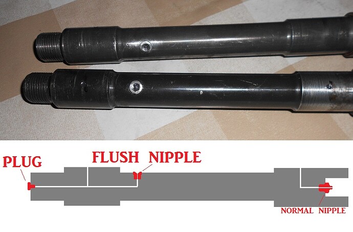

Is there a method of lubricating the swing arm taper rollers bearings without stripping the rear end out?

Swing-Arm Bearings can only be Greased by dismantling.
It’s easy enough, the rear end splits down very easily, and goes back together the same way.
Worth doing the Shock Links, they got very little grease at the Factory.
You can grease the Bearing in-situ, but only by modifying the Spindle.
Same with the Linkages.

I regularly clean and re-grease my shock linkage bearings and they have always been relatively easy to service. I did consider putting grease nipples in but was worried about the potential stress risers of doing so. However I would like to modify my swinging arm spindle to take a grease nipple, I might buy a second hand one first to play with.

Adding Grease Nipples won’t affect the ‘strength’ of the Linkages, as long as you employ good engineering practices, such as de-burring any holes drilled.
I prefer knock-in Fittings, as cutting threads can introduce stress-raisers.
As for the Swing-Arm Spindle, drilling a small hole (2mm or so) for the Grease feed through the two ends won’t even come close to reducing it’s strength enough to be a concern.
You could hang a couple of Tons on that thing!

I assume the spindle is not hardened through and therefore a modest sized hole can be drilled along the CL. Is it case hardened on the outside?
Clearly if the spindle is drilled with a cross drilling to the bearing, where would this hole come out? Would it be between the inner taper roller race and the inner seal?
2mm is quite small drill for such a CL hole, how deep would this need to be?

I don’t think it’s Case Hardened Nick, it drills easily.
I’m guessing there’s some sort of heat-and-quench-in-oil treatment done on it, it would explain the black finish.
The Feed Holes come out next to the Bearing Races, on the inboard sides (i.e. nearest the centre of the Bike).
Like any remote greasing set-up, you also need an exit for the old Grease to come out, while you’re pumping the fresh Grease in.
You can either drill a 1mm hole in the Seal on the opposite side of the Bearing to where the Grease enters, or just cut a tiny nick in the Seal’s Lip.
The Grease will dry out in the hole (or nick) to keep moisture/dust etc out, it’s a common Engineering practice.
The hole through the centre only needs to be deep enough to meet up with the Radial drilling on the left, and the drilling from the Flush Nipple on the right.
The right requires a ‘Long-Series’ Drill Bit.
Take it slow, clear the hole every couple of mm, and use plenty of Lube.
You’ll still need to loosen the Spindle a couple of turns before greasing;
A. To line up the Nipple for access with the Needle-Point Grease Adaptor, there’s only really one position you can get to it from, just slightly behind and to the right of the Centre Stand.
B. To allow the grease to get fully into the Bearing mating surfaces (between the Rollers and the Inner/Outer Races).
