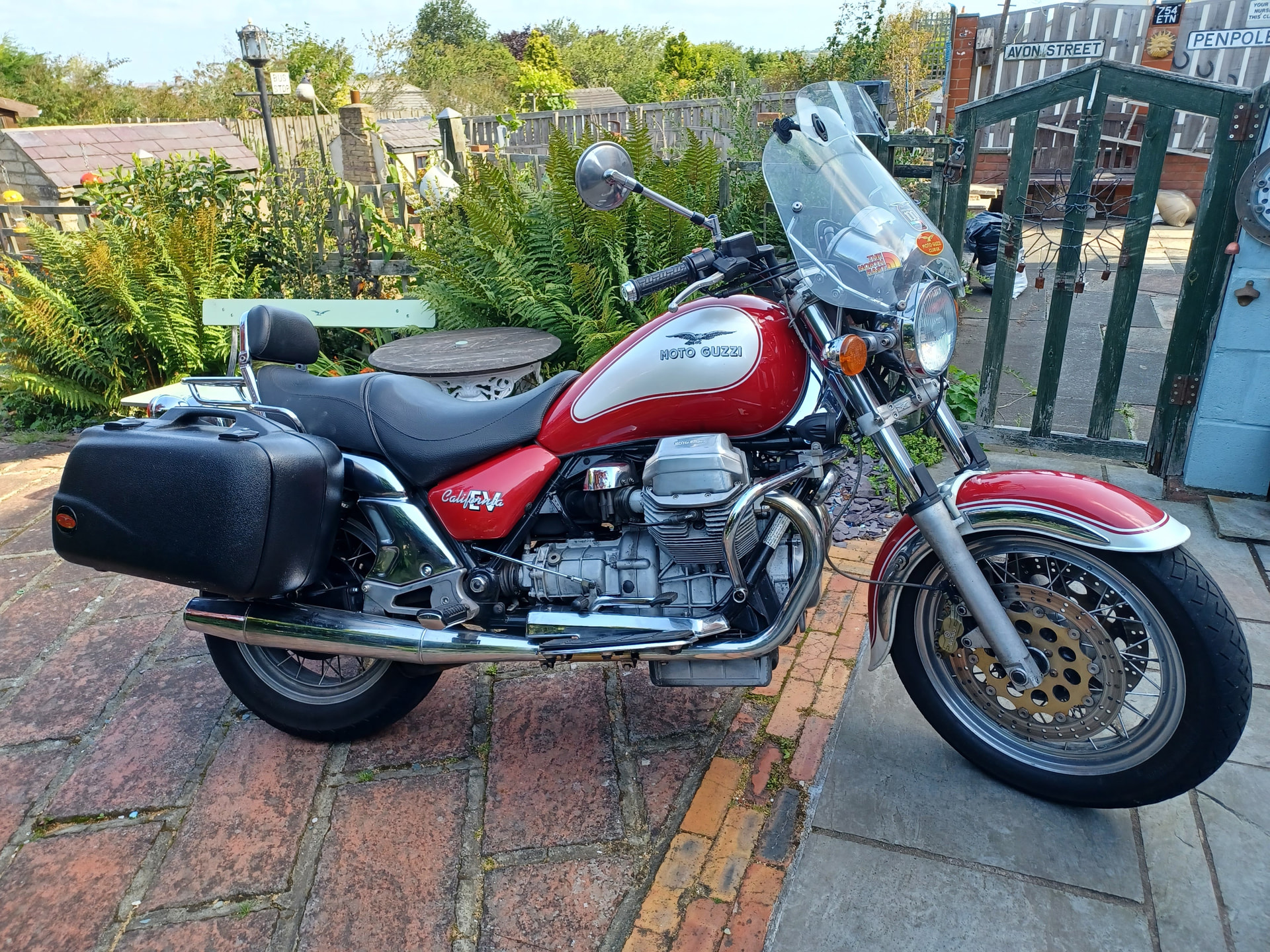

I’ve got an ev for sale ..
Not necessarily, it’s just that I have seen one for sale that is just like the one I used to own 30 years ago.
:+1:
(Does anyone know why does the post need to be at least 10 characters?)
Where can I see some details of your EV please?
It’s in the for sale section,
I love that colour scheme. Shame we live so far apart.
