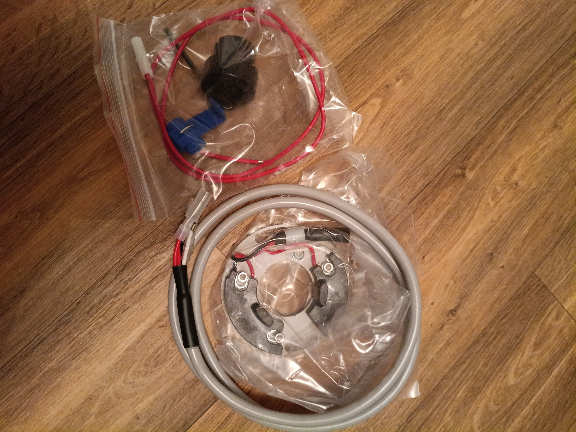

I will look into points next. I did buy replacement ignition system but it came without the instructions?
