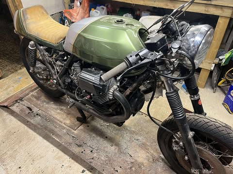

I am currently building what is believed to be an 83 lemans 1000s, It was given to me in a very very sorry state.
It came in a partially finished cafe racer conversion, where over the past year i have been collecting bits, modifying and fettling the look and finish to get to a point where i am now completly rebuilding the whole bike.
This is how she came to me, Not running, and in a very sad condition.

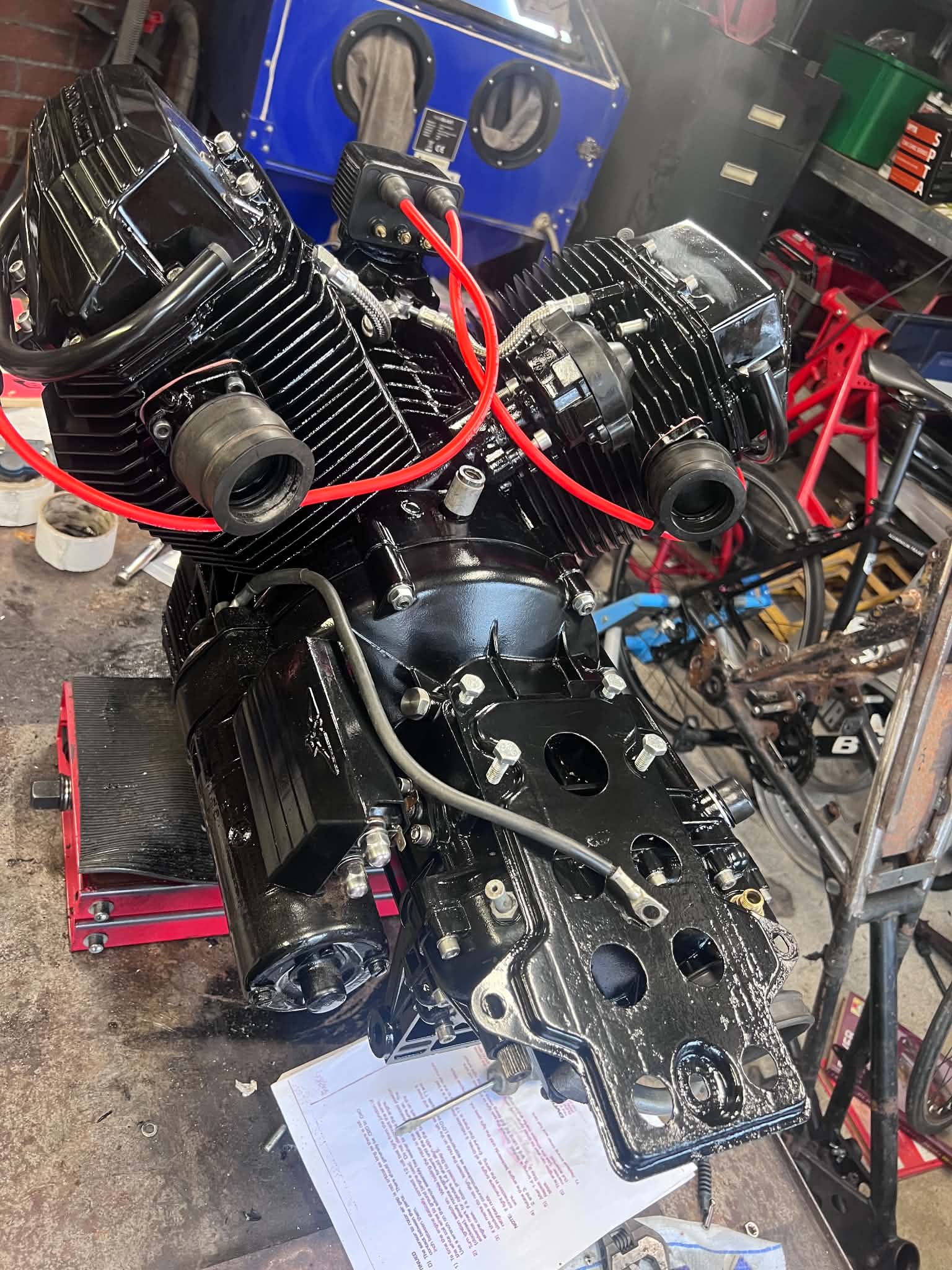

Before i stripped it down, i made sure she ran beautifully, and everything mechanically (engine wise) was good, so i know i was working with a trouble free engine.
That part has now been finished. and she is pretty

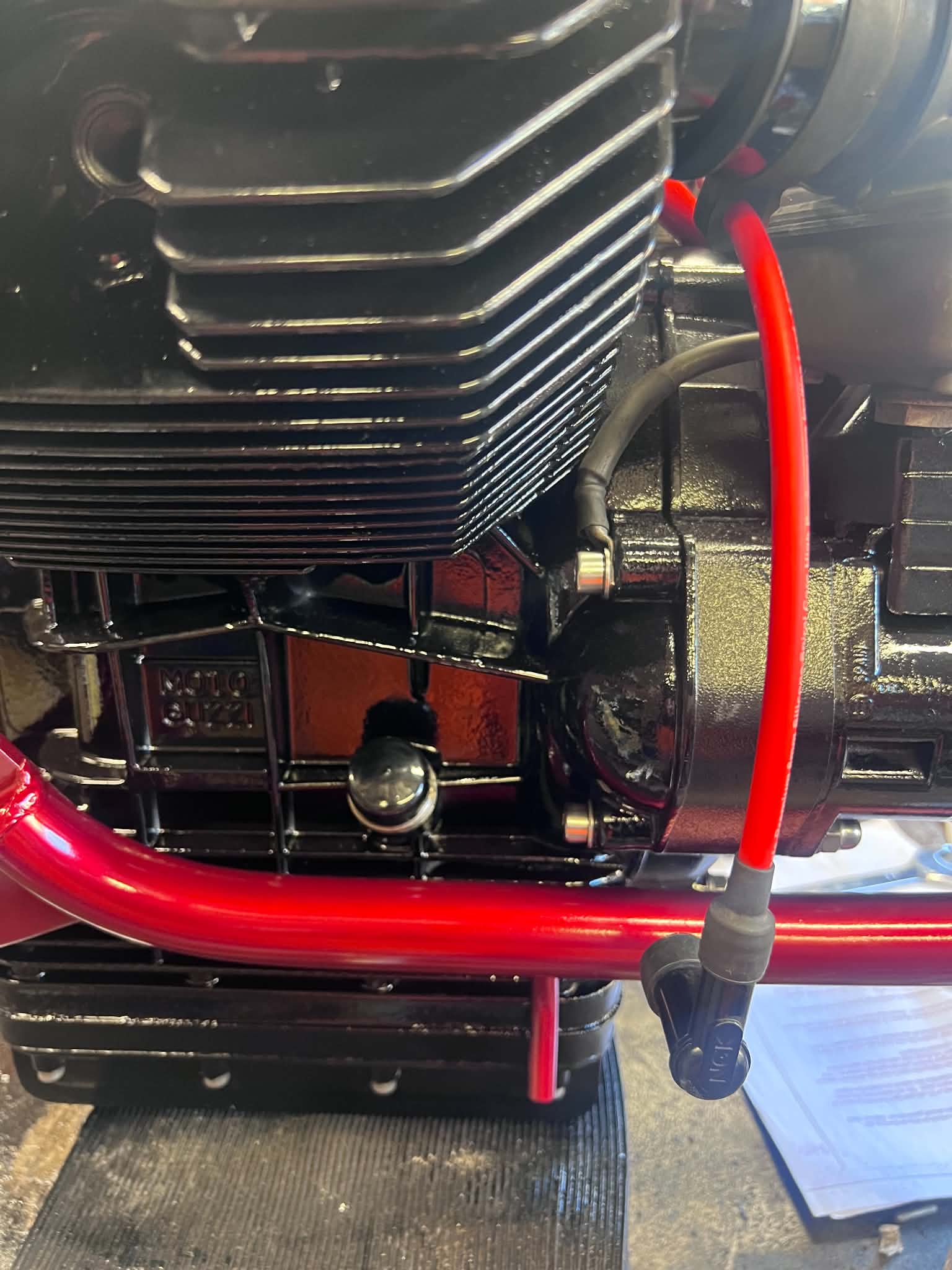

In removing alot of the brackets that have been welded on over the years, i uncovered the original frame number.
With that, i started upon a quest. Has this frame ever been registered in the UK before?
So i hit google to find somewhere that would do a vin search on 7 digits. Nothing anywhere.
they either didnt do a 7 digit search, or had no records.
I would so love to be able to keep the original VIN, but i cannot just go to the DVLA as i do not have the reg associated with that VIN. so cannot apply for the V5 on that VIN.
Are there any records anywhere that i may be able to get something that i will then be able to use to either track down the REG, or apply for a V5 on that VIN for an age related plate.

83 le mans would be a mk 111 850, 1000s came out in 89, from your 1st pic’ that’s a mk111 fuel tank are your cabs 36mm ? If so that points to it being a mk111, engine should have a VF prefix​:+1:
I believe it’s prefixed V V
It may well have been an 850 when it was first built. This may well be a bitsa
