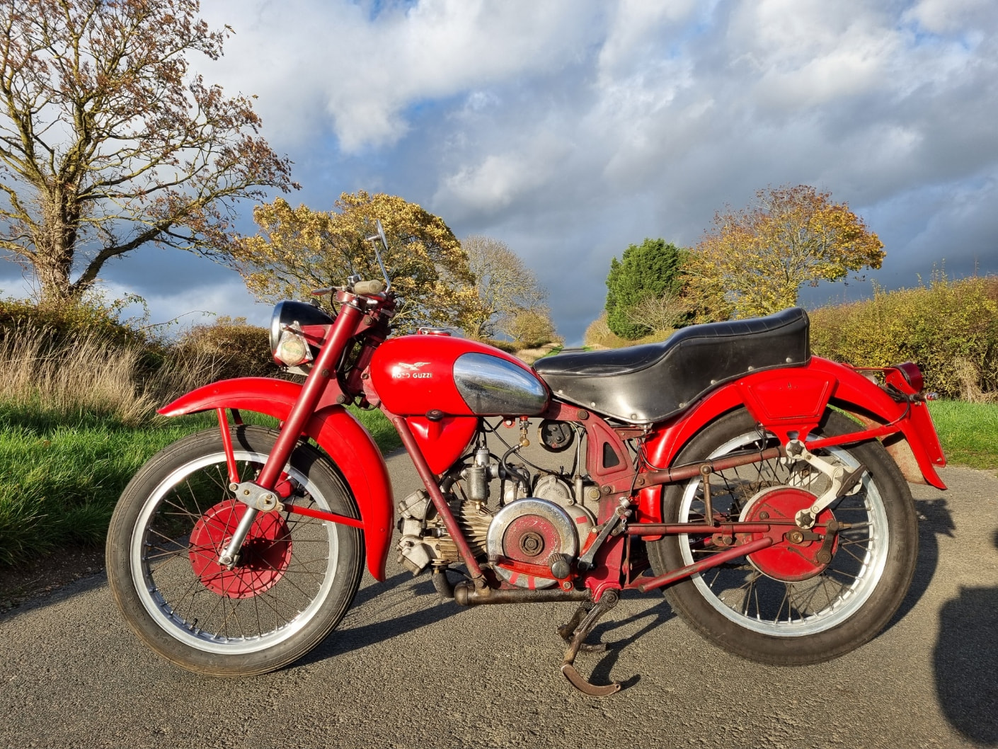

This is mine

Hi Don-Spada. Thanks for your reply.Mine is a sport - I had figured that the rear brake lever type was one of the obvious factors. Cheers for the information about timing and tappets. I am looking to get some stuff from Valenti moto including the missing spring from the throttle housing, new oil pipe for the rocker arms and a tappet spanner to maximise my spend while staying under the import duty limit. Your bike looks great - thanks for posting the picture. Seat for pillion would seem to be a vast improvement!
