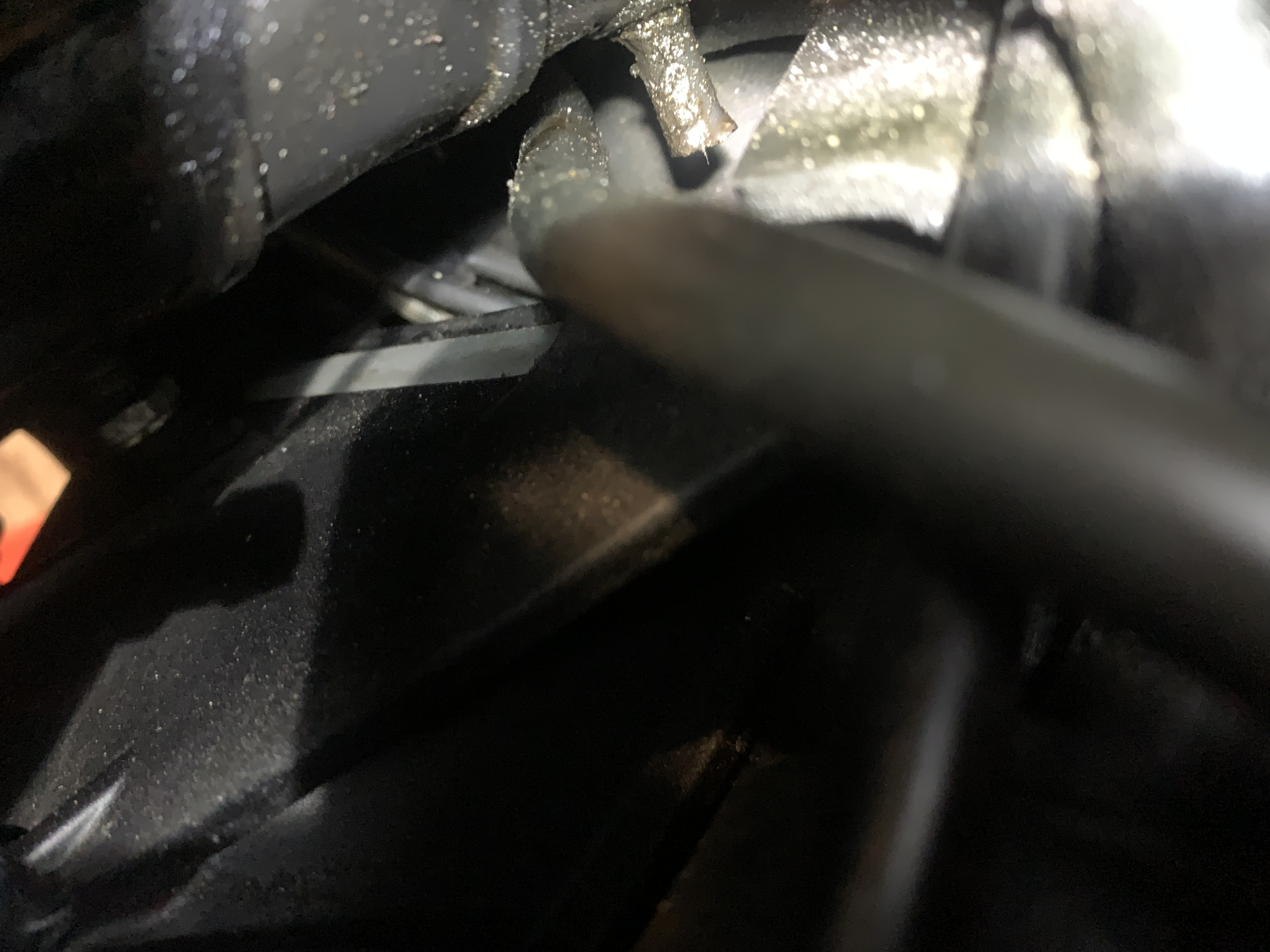

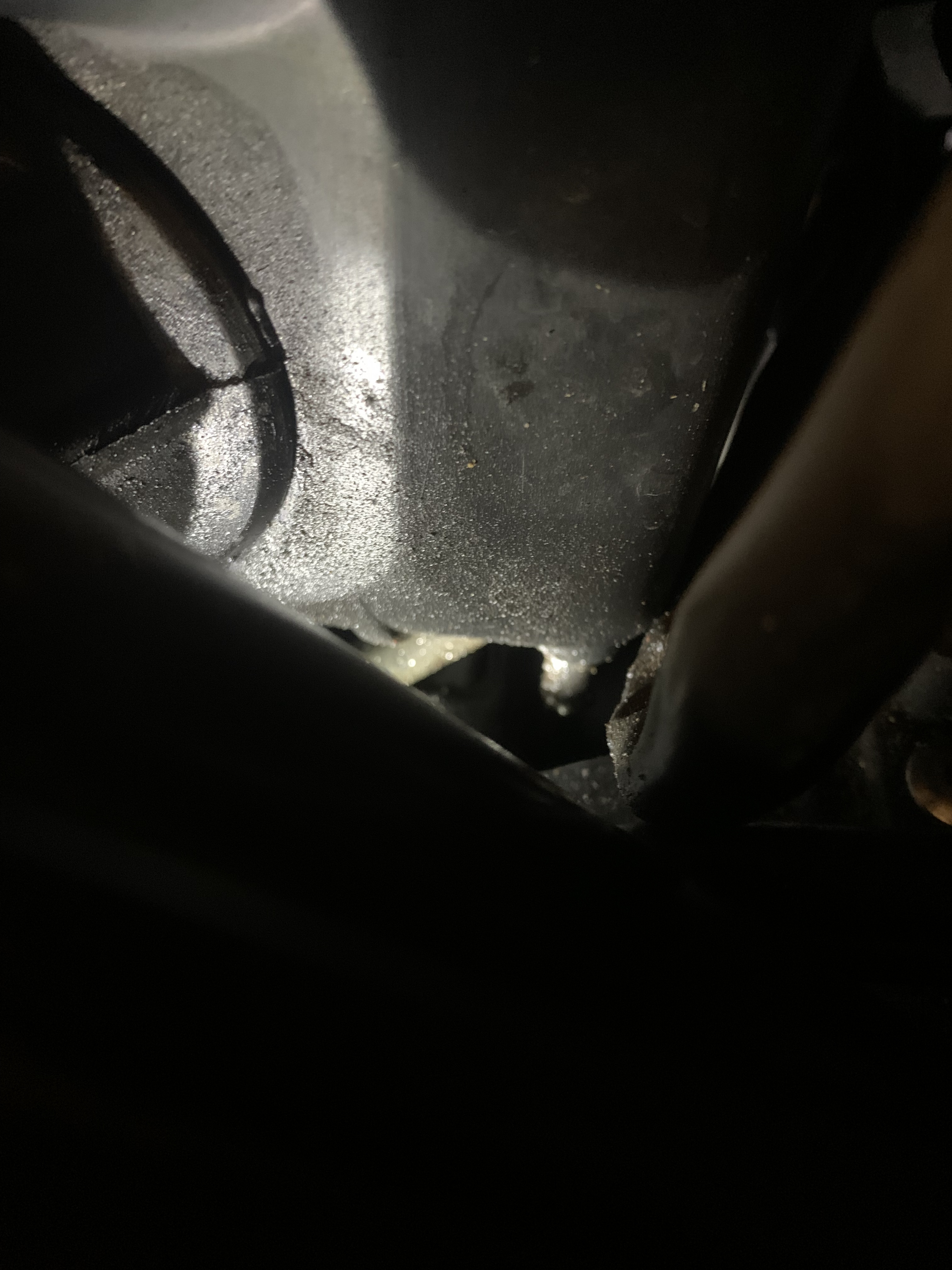

So, it’s not from the pipes that I can see, they are all dry, including the plugged one, it’s from a spigot in the bottom of the airbox on the back left of the box. which looks like it has dripped down and onto the exhaust, covering everything on its way! Should this have a pipe on it? Also, reading on here, is this common to have oil in the airbox?
Yes it should have a pipe with a plug on the end to stop unfiltered air getting to the engine. (Le Mans 1 owners look away)
BUT that pipe drains the airbox and if it is dripping it means that the bike has been blowing oil into the airbox. Hopefully just overfilled with oil?

Right, will check if a random pipe is lurking in the depths! Oil level dropped in the meantime!

I agree. It’s a pipe that has come off the air box. You should be able to locate the pipe. Once found it’s easier in the short term to secure with a small cable tie . I find that it can be a faff to re-attach or replace if serviceable, the steel clip.
After a load of entertainment finding the pipe and getting to it, goodness who designed this delightful feature??? then replacing, all good. Pipe replaced, oil level dropped, all good many thanks for help!
