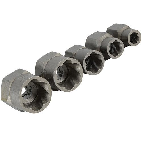

other removal solutions include drilling a small hole in the head and hammering a (sacrificial) Torx driver in said hole, and there are specialist tools for mangled bolt heads which are used to remove shear bolts from car steering columns, might work - look up Irwin Bolt Grip Remover 10504635. Seems these things work best starting with the smallest feasible size to cut into the offending bolt head.
I’ve not tried to remove shear bolts so this is not a recommendation.
