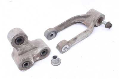

Or Swing Arm Linkage Moto Guzzi 850 Breva LP B 06-09 | eBay UK
For instance
Mind you Brian the amount of rust-dust outside the seals looks like that one has already died :frowning:

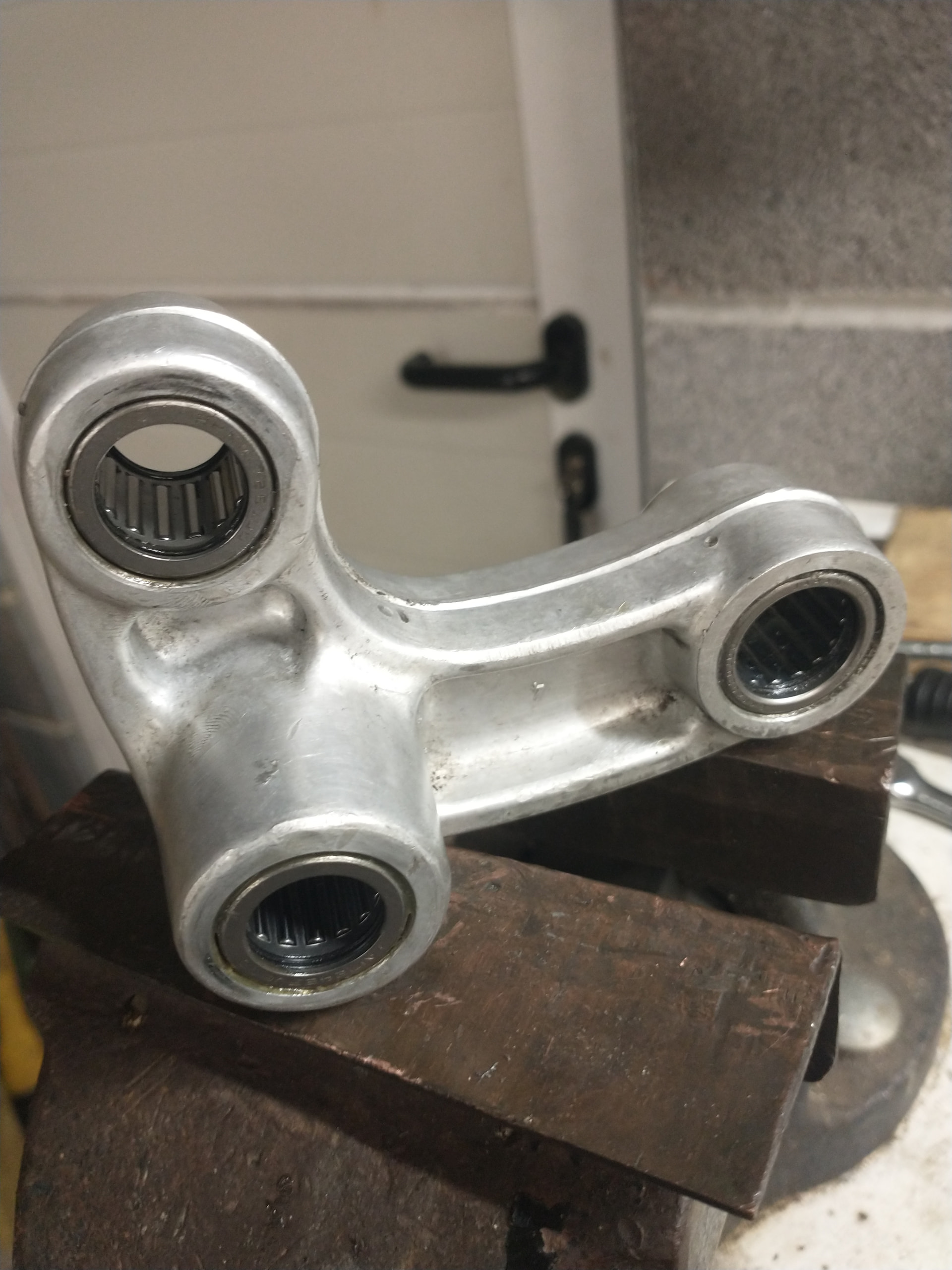

The one I have on the bench the roller bearings in their housings push right through with seals each end.
