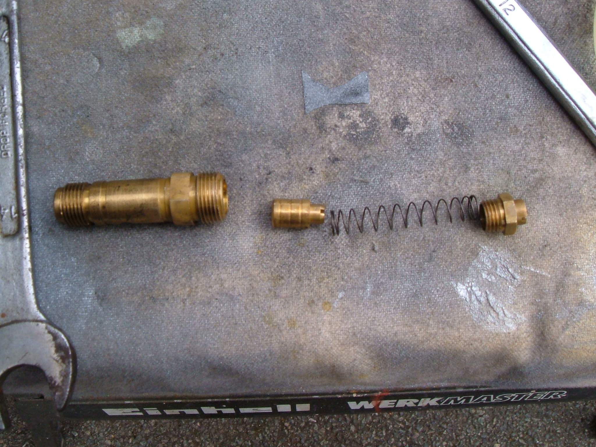

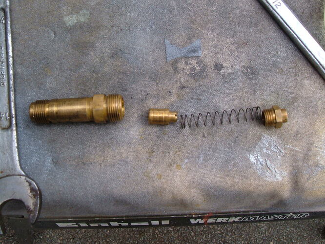

The carbs are very simple, don’t be afraid of pulling them apart and cleaning them out. For any replacement parts you may need, Eurocarb are very good. You will also find an exploded diagram of all parts in the section for your carb. Pay attention to the plunger in the main jet tube - in the middle of the picture below, mine was clogged up with muck (Assuming the V50 has one) in the picture below.

NB: the piston in middle of the above photo, is hollow and contains a tiny plastic ball. This is a ball valve and closes to push a squirt of petrol up when the slide and needle are raised. Ergo a very simple kind of accelerator pump. This is a feature of the VHB carburettor, again we’re assuming that’s what you have.
