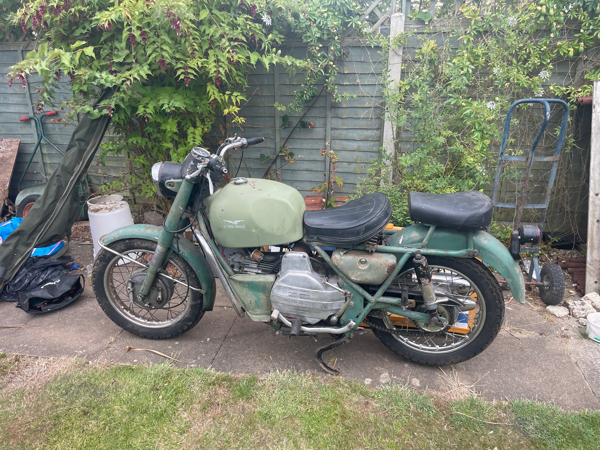

Hi I’ve just bought an ex military Nuovo Falcone circa 1974 “project”.I’m already struggling to get parts. rubber bushes for shocks etc.Is there someone who has restored one who could give me some advice or point me in the right direction? :slightly_smiling_face:

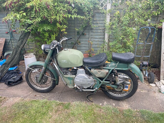

Fantastic information! They seem to have all the bits I need. I bought the Falcone on a bit of a whim whilst buying spares for my marini, then started getting severe buyer’s regret when it seemed difficult to get info and parts. My plan is to do an “oily rag” restoration to start with just to get it on the road. I have to get it imported as it has been in UK for a while as a spares only bike. I’ll attach pic

Hi Mike,
Your bike looks a lot like mine. Various shades of green. :grin:

It seems mine is an ex police model which has passed in to civil ( or farm) use at some point. someone painted it a slightly darker green but did not key it so thats all flaking off to show original colour. Also I,m getting the feeling it’s a bit of a “bitsa” as I’ve found some parts are dark blue, also a police colour.the nearside chain adjuste is snaped, hence the saggy chain. Anywaay hours of fun ahaed I think :wink:
