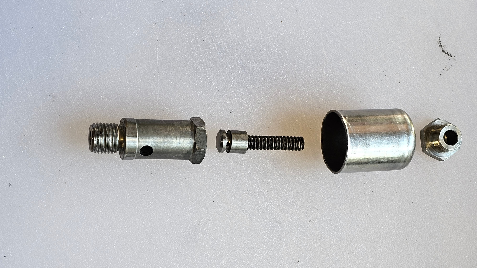

FYI my valve didn’t work at all and as a result valves, guides and rocker faces were fubar’d. I think it was like it from new 18000 miles. I have fixed the valve by lapping it
I don’t have a picture of testing the valvle but here’s one of the valve disassembled.

You may want to check the “Top Hat” breather valve. This maintains a steady pressure in the crankcase. If this is stuck open then the engine will pump air through the breather.
This is the valve on my Cali but Spada is the same.
