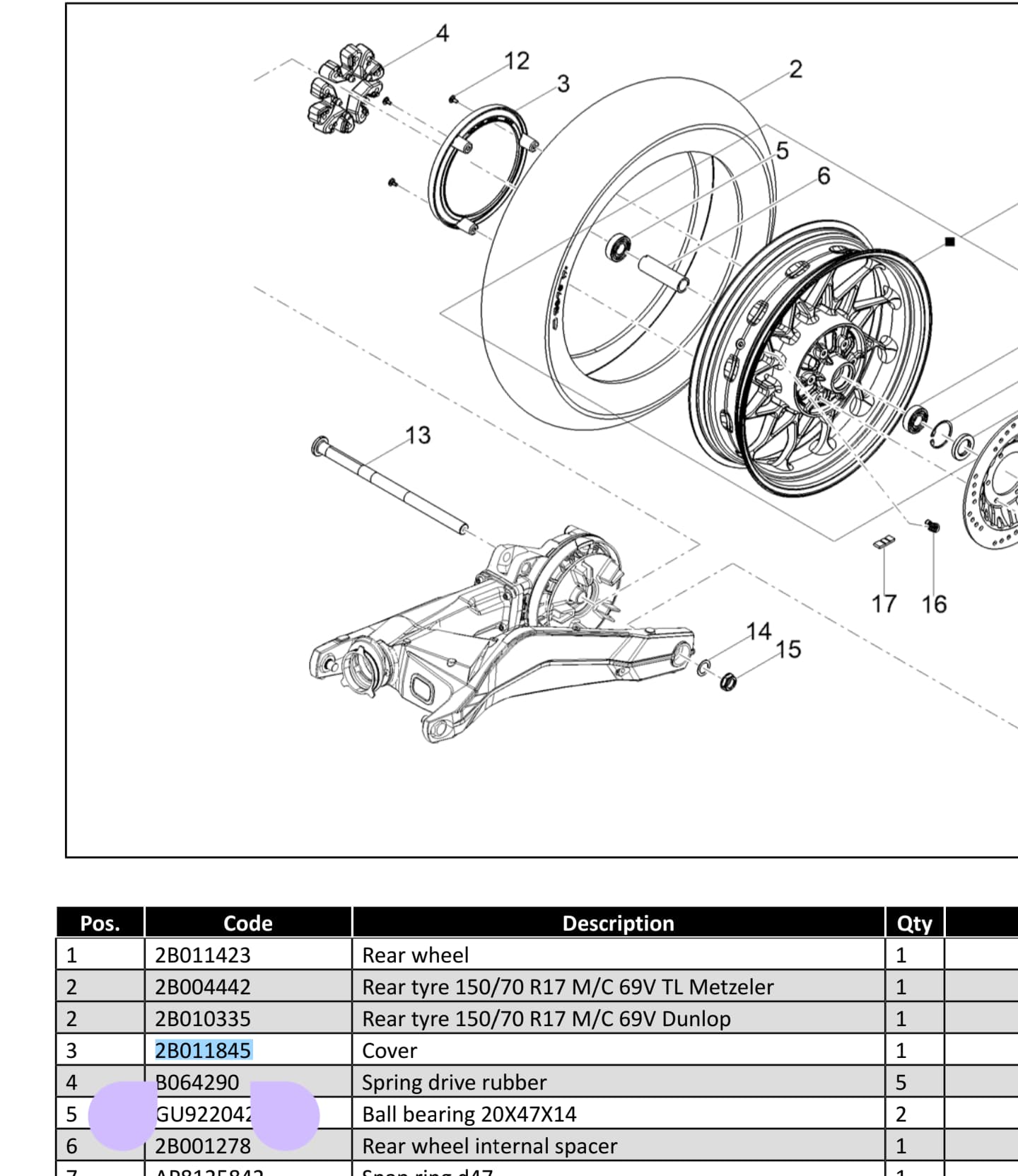

Does anyone have a parts book for the V85 Strada? - Not the V85TT with wire wheels, as there is a part i am trying to track down/see if it exists which is a spacer cup similar to the one fitted to V85TT wheels but bigger, which extends from the centre of the wheel to the bevel box.
The V85TT wire wheel version is too short and leaves a big gap, back of bevel box is open to all sorts of crud getting in

              can’t find E5+ models in there, and EMEA goes up up to E4 but American (NAFTA) up to E5/2021?
the nafta E5 section shows the wire wheel version of the cup/cover I think.
