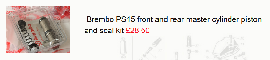

Presently ‘stuck’ with the rear brake master cylinder. The numbers 20A4 15 are on the part. I think I need a repair kit for this as the brake pedal presses OK and then it fades off.

Try Ducati Paddy for the rear master cylinder repair kit, I got one of him a couple of months ago. It should be 15mm from memory. You will need this one

Got my PS 15 on it’s way to Paddy Ducati to fit a repair kit for me.
