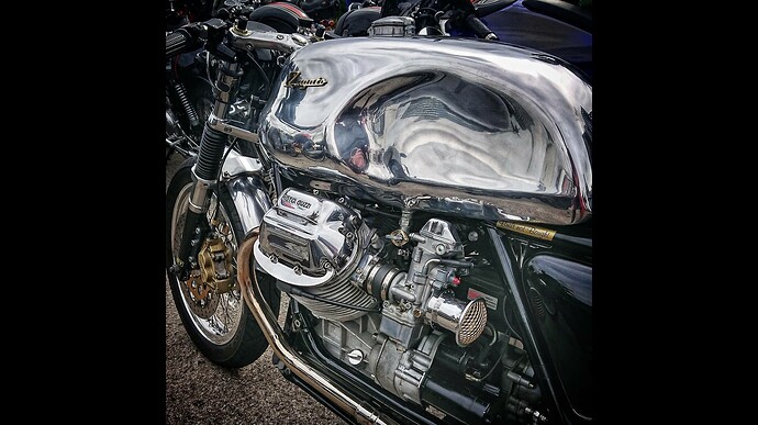

I too lean my carbs in like that, if they are vertical my knees knock them. I remember some talk on here about them needing to be upright so that the floats work properly but it does not seem to have any detrimental effect sloping them in like that.
This was what they were like when I removed them! They’re flat tops but aren’t plastic.
This was what it was like before I got started. Definitely not standard.
Nice bike. Don’t get this pumper removal business- how much money in fuel is this really going to save over a year for the average rider? I thought bikes were meant to be fun so give me the 100% unstrangled carb any day so I can burn some unleaded while we are still allowed to.

Looks like that’s got a “black box” ignition or a regulator, going by the electronic gizmo looking thing mounted above the horns,
Yes, it’s got a solid sate reg/rec and electronic ignition amongst other stuff.
