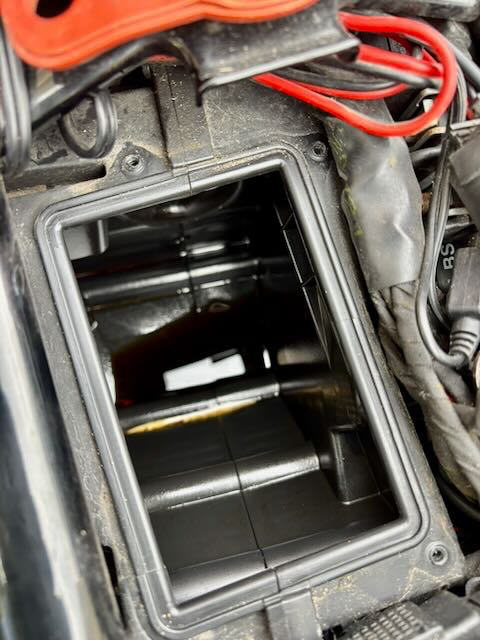

Since then, I have discovered that the engine oil was overfilled, with at least 50ml sitting in the airbox, and that they had forgotten to change both the gearbox and final drive oil. They also missed that the rear brake bolt had come loose! This, despite them having changed the rear brake pads at my request. How on earth could they have missed this?

My local Guzzi main dealer also overfilled the engine oil by a considerable amount.
I ended up buying an extraction syringe to pull oil out through the filler hole.

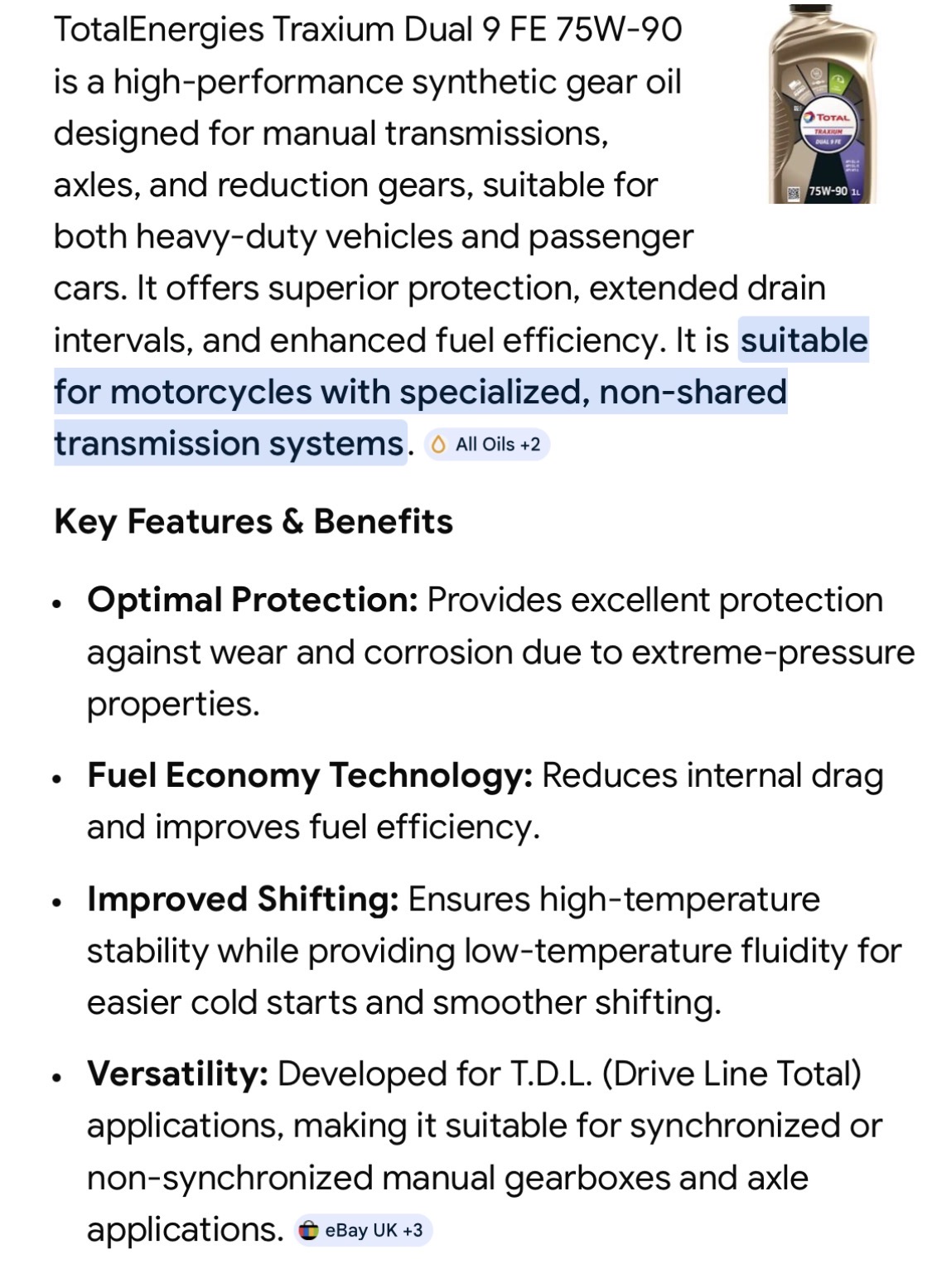

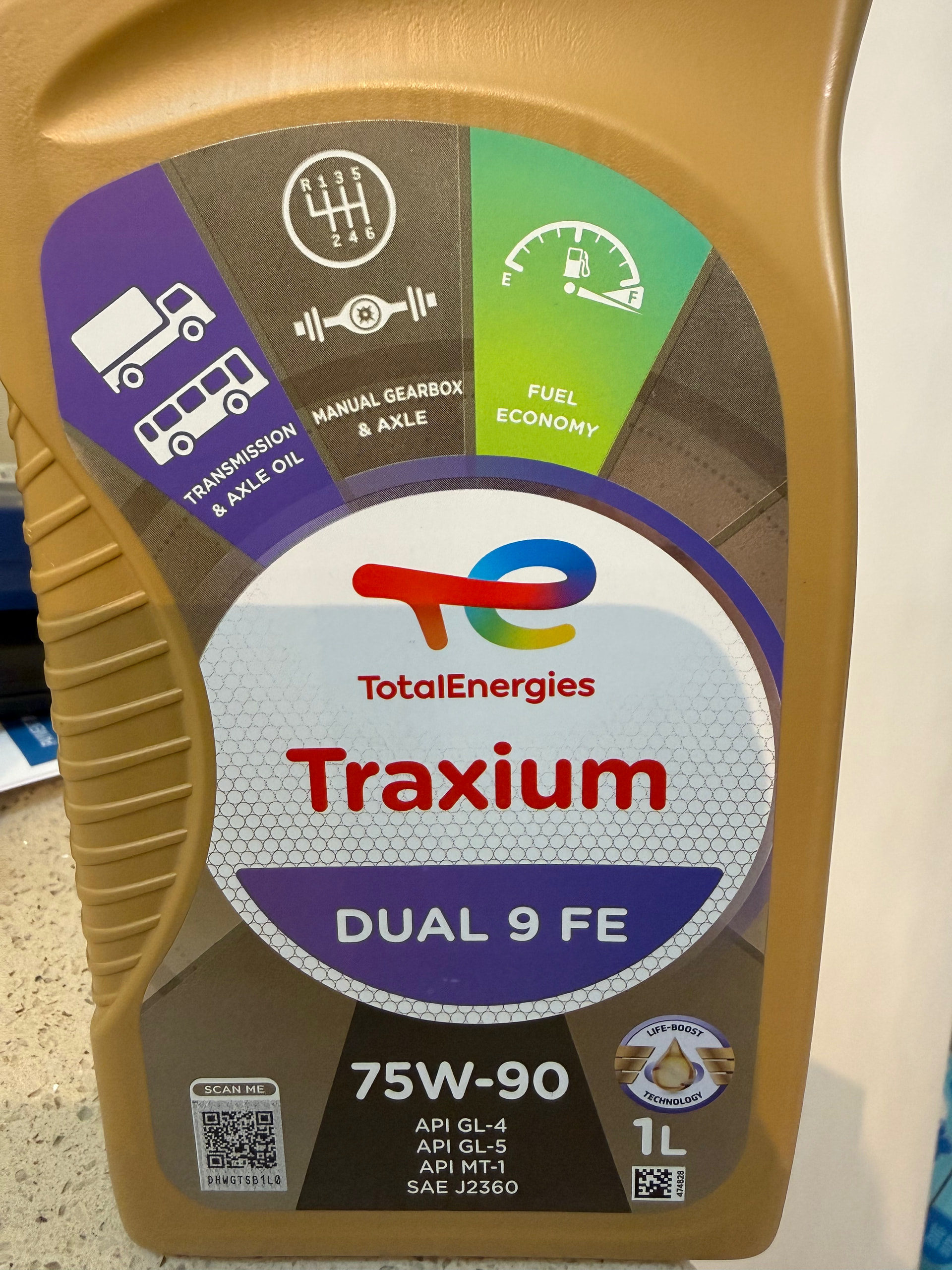

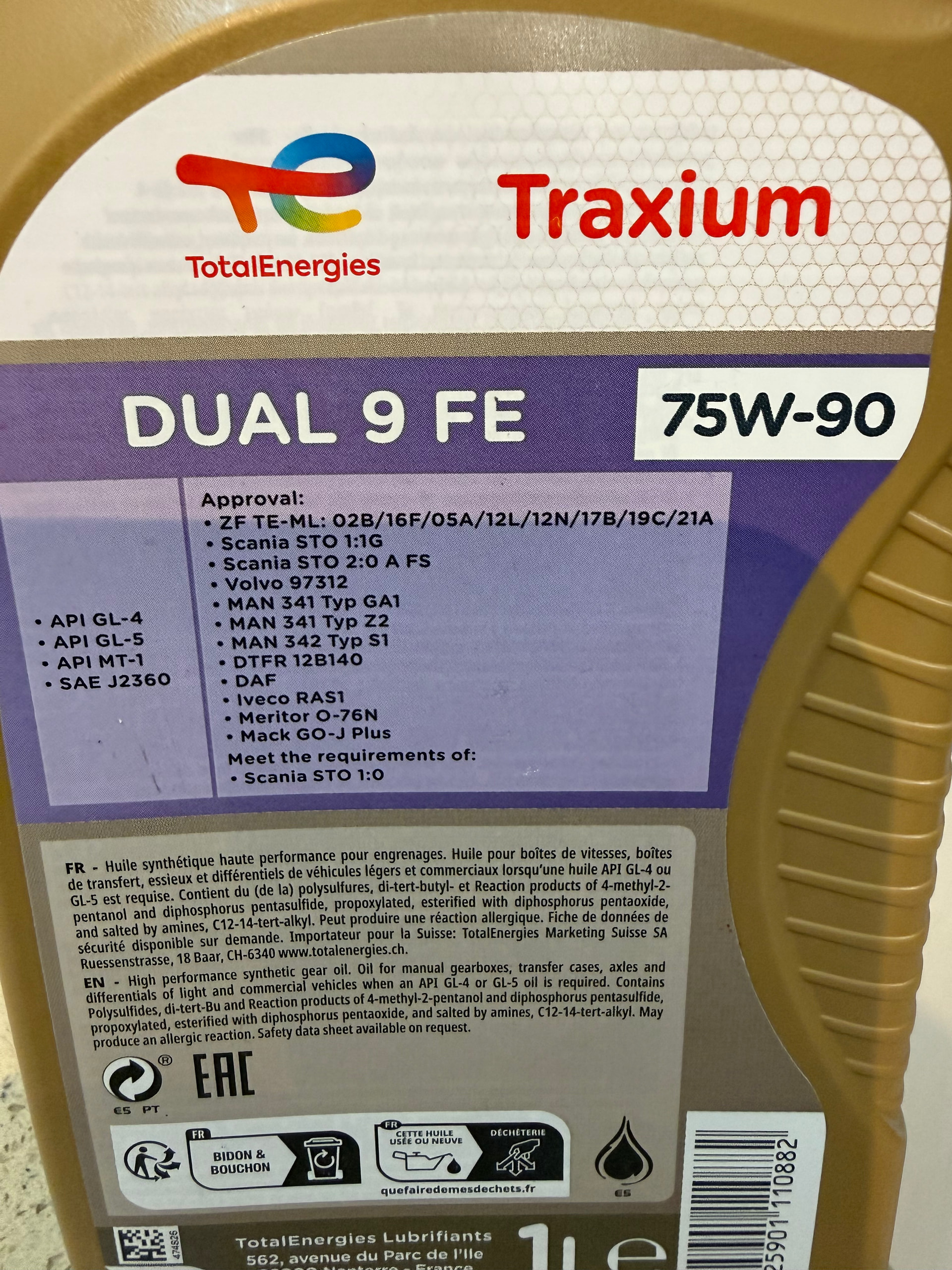

Ok - done about 80 miles with the new gearbox oil. Can notice a positive difference going up and down the gears. A lot slicker and definitely less false neutrals :rofl:
I’ve been using Total gearbox and engine oils in all my vehicles for years and rate their oils very highly( fluids often found in LeMans endurance cars)
I know oils are subjective and emotive rabbit holes but Total oils just work so well IMO​:ok_hand:
