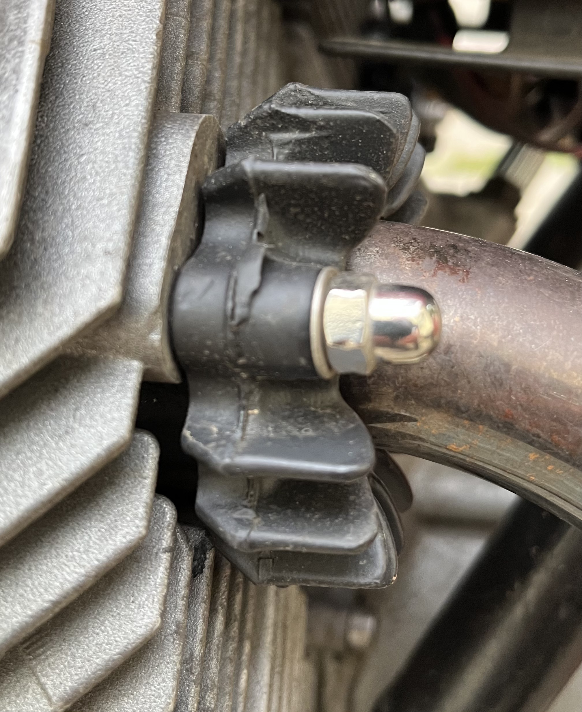

Shouldn’t be a major problem unless the studs are very corroded, but if the original dome nuts are still present then they will have offered some protection. Use plenty of dismantling lubricant (PlusGas, WD40, what have you) and take it nice and easy. If you are unlucky enough to snap a stud they are easily enough removed using the double-nut method. If this happens, take the opportunity to replace the studs with stainless – you can buy S/S threaded rod from any of the usual places (I use Westfield Fasteners) and some nice stainless dome nuts to suit. Cut the studs to length and screw them in (again using the double-nut method) with some ally grease. The collets are pretty indestructible: they may be a bit rusty and pitted, in which case a wire brush attachment on the end of a drill is your friend, and ditto the flanges. I gave mine a good clean and had my friendly local paintshop cerakote them matt black – they look great.
Don’t be nervous: in the scheme of things Guzzi your project is pretty straightforward, and there’s not a lot that can go wrong. Even if it does, there’s always a remedy, and you’ll find plenty of advice on here. Best of luck!

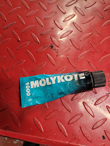

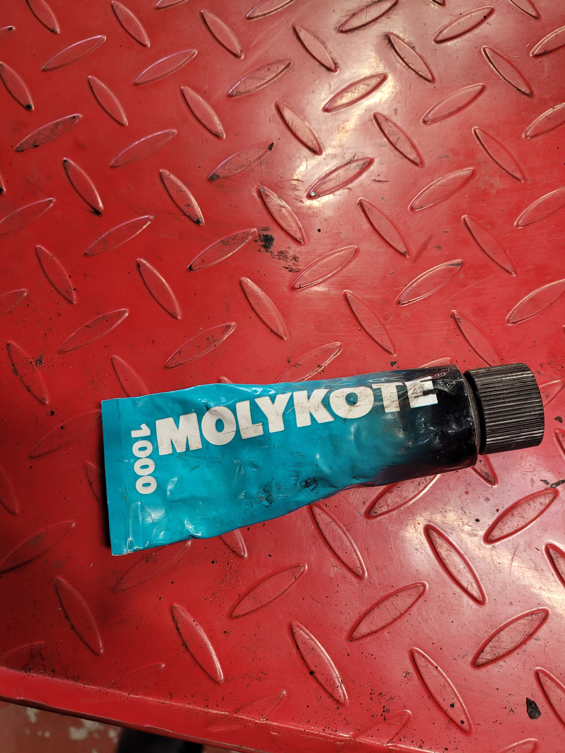

Only use this as a (long defunct) workplace used to have it free-issue in the fitting shop :grin:
