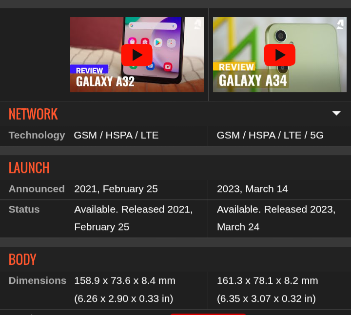

if it isn’t shown on the quadlock website then you’ll have to buy the universal case adapter that sticks on an existing case. idk how strong the sticky is on those.
EDIT: just checked and i cant see one for the A32.
nearest model number is bigger so case will be slightly too big/loose
