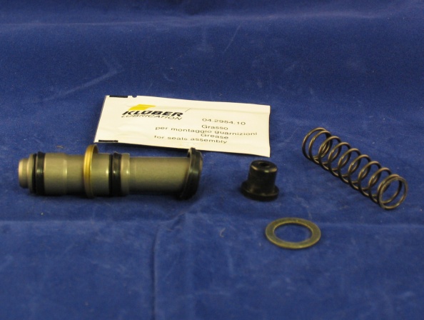

Anybody found a source for PS15 recon kits? Gutsibits haven’t got any ATM.
Have a look on flea bay, there are a couple of companies, think one is Powerhouse.
Mdinaitalia. Not cheap, but they have some.
Cheers Andy…ordered.
