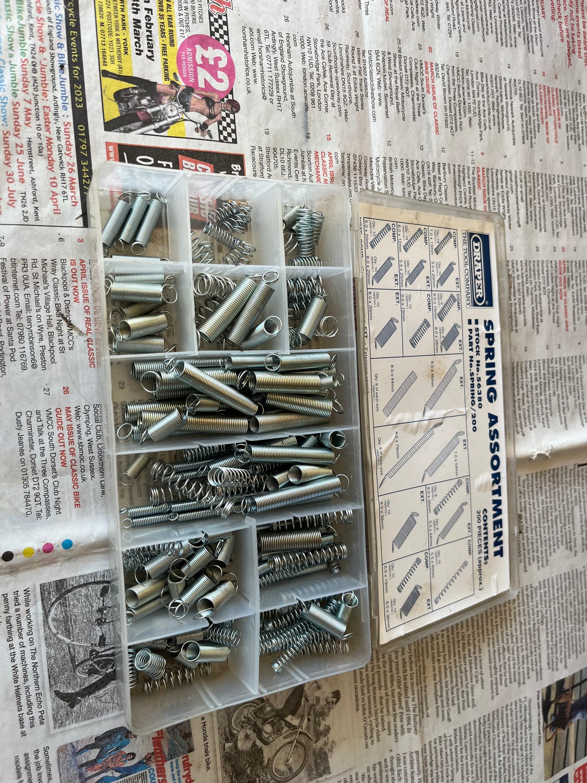

I have a selection box of springs. If you know roughly what you need I can see if there is anything suitable and send to you. If it’s just to return the pedal and master cylinder, I would think you could make do until Gutsibits get some stock.

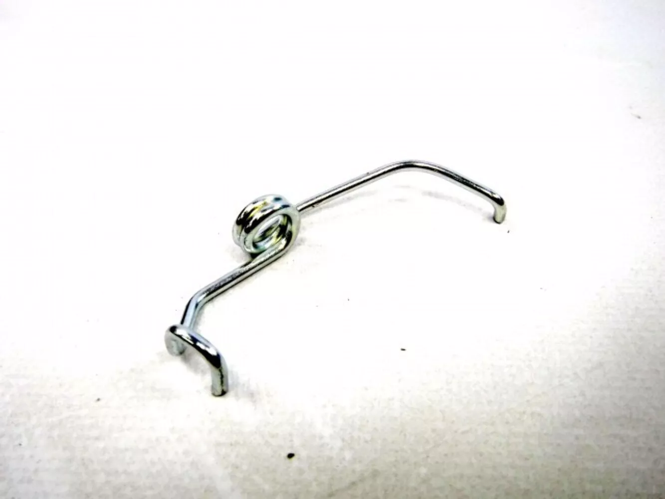

Hi Ranton_Rambler, thanks very much for your reply and your offer to help. Unfortunately your box of springs appear to be compression springs and the one I’m after is a torsion spring. I have tried to upload a picture of the spring but it is just a link and I’m not sure if it will be possible to open it

I faced this problem & made a replacement using music wire. I used 2mm in the hope I could cold form it but It needed heat so I’d use 2.5mm if I did it again.
I heated the wire with a blowtorch to form the coil around a suitably sized screwdriver shaft. Once I’d finished shaping the entire piece , re-heating the coil and other bends back to a cherry red before quenching in water returned sufficient spring to the steel. Time will tell if it is (or becomes) too brittle. I’ll keep an eye on it and come back and tell you if /when it breaks.
I’m not generally inclined to home-made braking systems but I don’t consider this spring safety critical & it’s better than nothing until I find a replacement.
