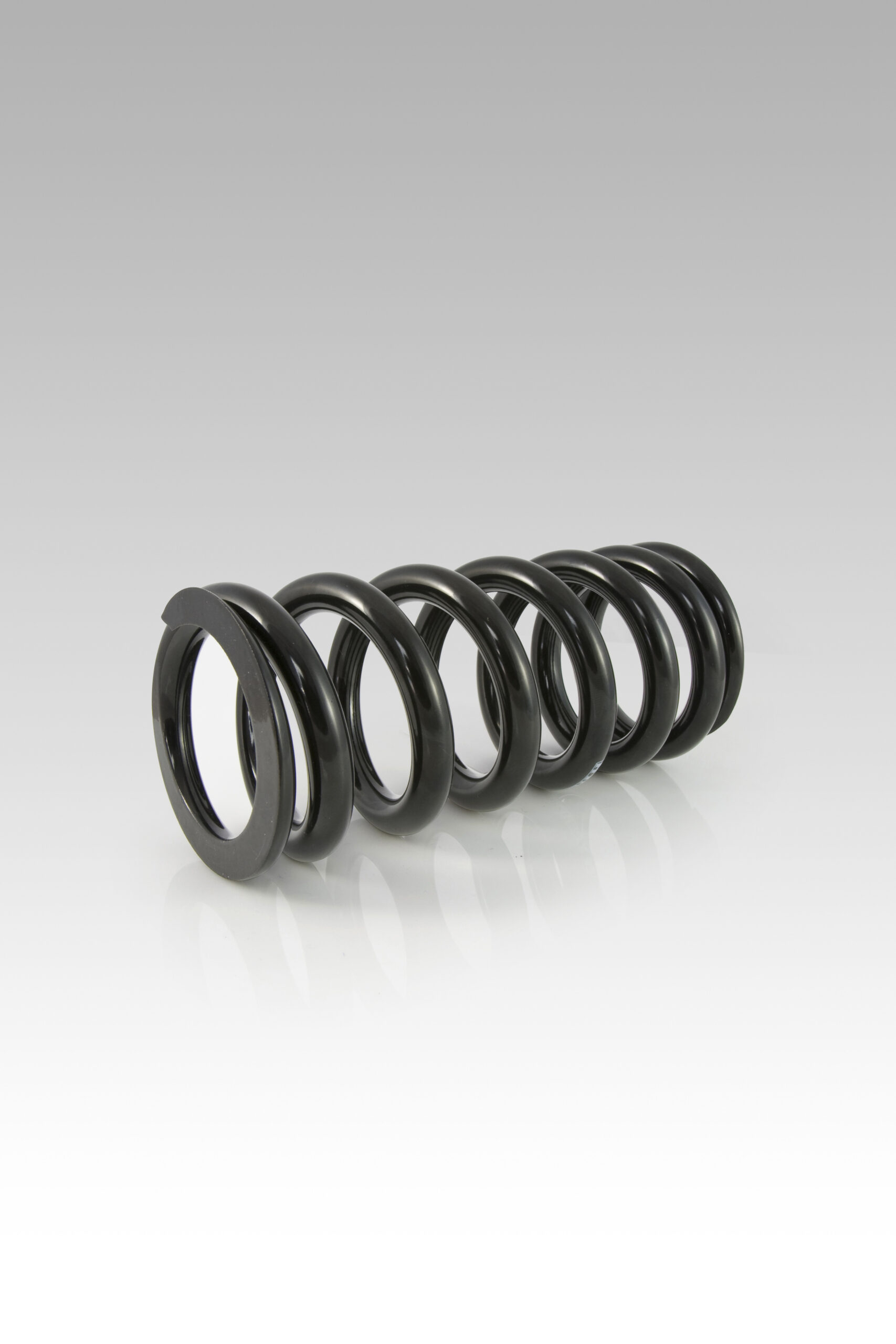

Wanted to ask for the exact rear spring people have used - I can see two types on the Hyperpro website, “Model with Hydraulic preload adjuster” or “Model with Hydraulic preload”
I have no idea what the difference is - any help appreciated
This is the page ref at Hyperpro for the spring that I fitted to my 2019 V85TT.
It comes down to the model year. If your’s is 2024/2025 then you will want the Hydraulic Preload adjuster variant
Superb, much appreciated

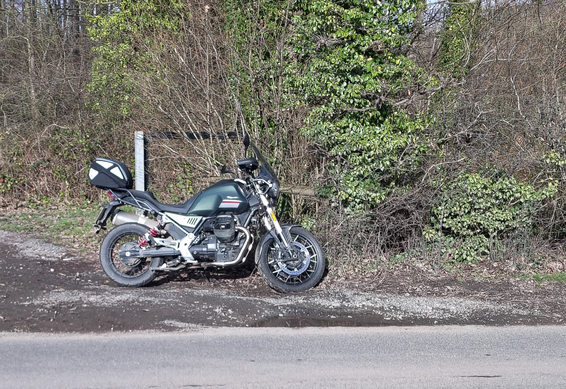

I bought the M shock - V 85 TT 19-22 Lowered version -25mm seat height .
My 5000miles review -
The reduced seat height is brilliant - i have 29 1/2 inside leg (UK average) now I can get on or off more easily and as I can touch the ground with slightly bent legs i can walk it back into and out of spaces and stop in awkward places when traffic requires.
The suspension is better than a 20,000 mile stock unit - not a night and day difference but more controlled and more comfortable over bumps and 6hr riding - also find i am tipping the bike harder into corners and it feels more confident and accurate.
Front lowering as well - I have just dropped the forks through the yokes to make the bike level and restore the steering angle, so the end of the stanchion is now 25mm (EDITED) above the top yoke.
Handling improved again - more stable and solid when ‘flicking’ through bends, the bike just feels much more in touch with the road - more than 25mm through seemed to make it more twitchy in slow manouevering: welsh lanes and traffic
The side stand is fine -better than some Ducatis- if parking on a slope you need to park leaning downwards, but an advantage is that it is easier to pick up off the stand. No need to shorten it
The centre stand is higher :frowning:, it is possible but not nice (on the other hand wheel removal is less of a pain)
This pic was when I had the shorted suspension but not dropped the forks
