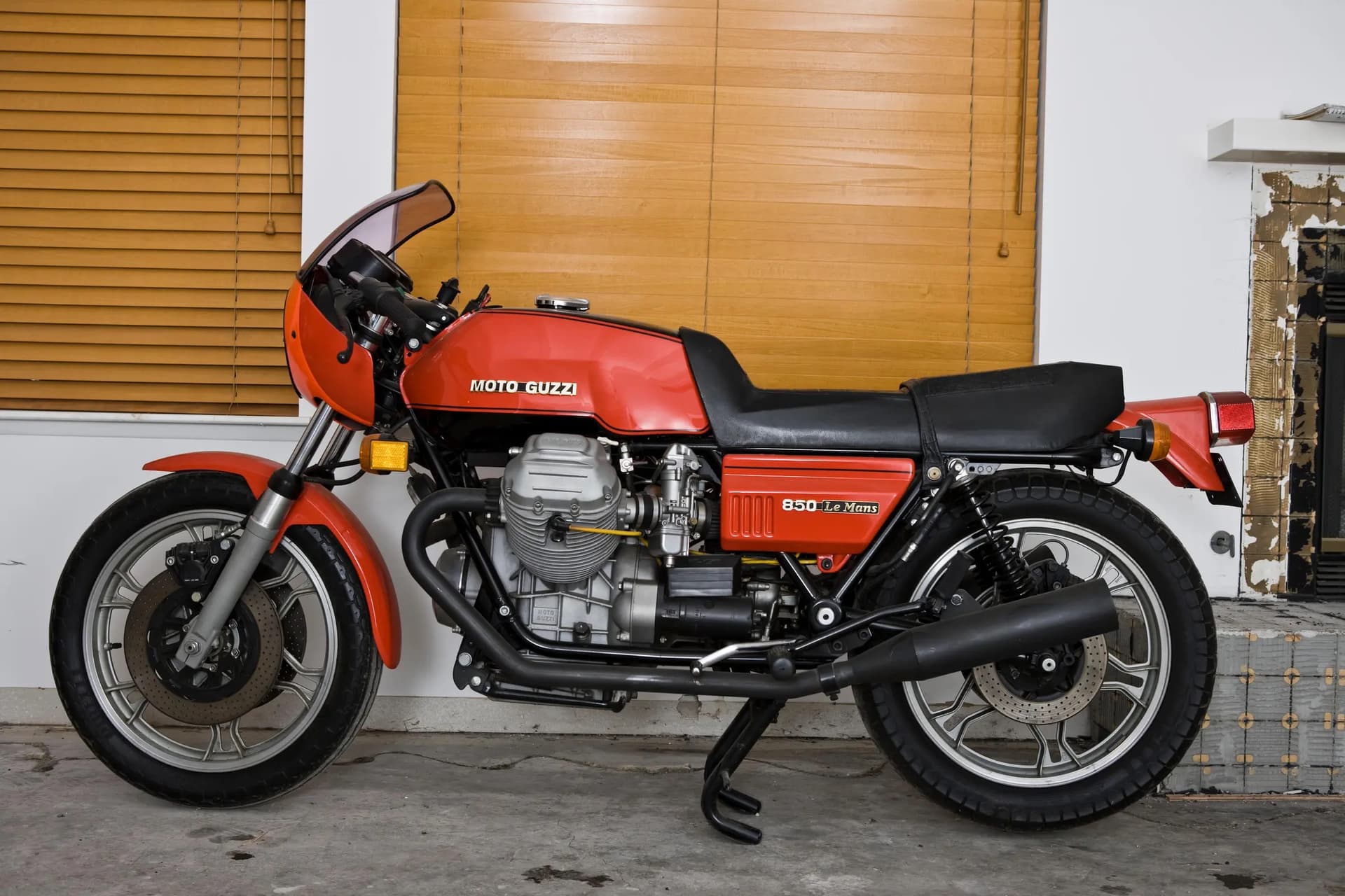

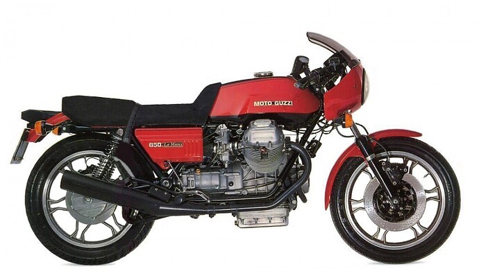

As far as I am aware, there are only two versions of the LeMans rear light, the early models like in your photo above, or the later one with the black rear light like this (Picture pinched off the internet) The 750S3 had the Ducati style rear light fitted, but I don’t think they were ever used on the LeMans models.

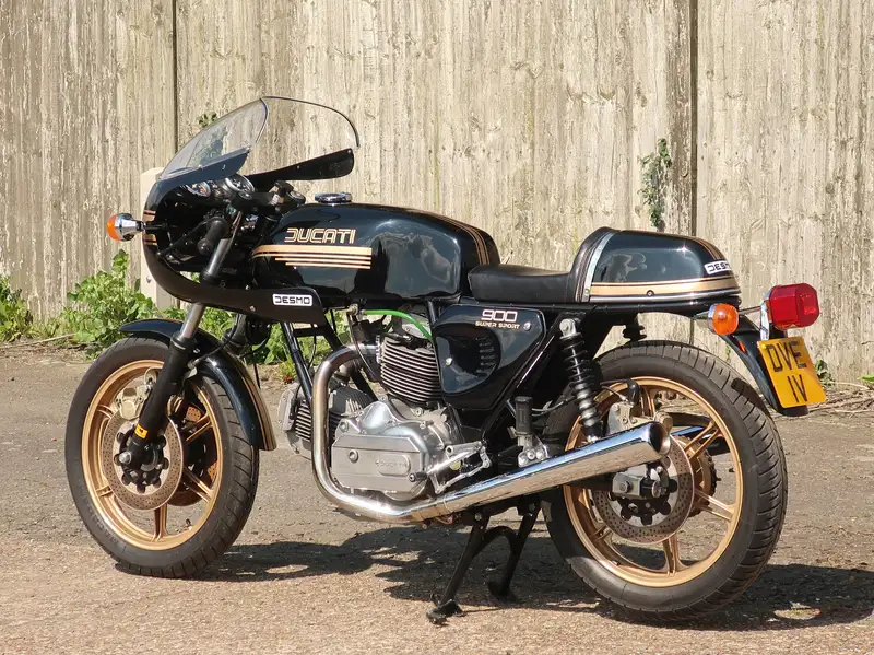

This is the earlier 750S with the Ducati type rear light that never made it past the 750S3 and onto the Le Mans.
You have to love the Perspex Le Mans style handlebar fairing, I want one! :zany_face:
The actual light unit on the photo you put up was also used on some Ducati models, but with a different mounting. That is probably where the confusion arises from.
Don that is the same light and bracket that was on the 1974 850T
Yes you are correct, it’s the mounting that threw me.

My understanding is/was 1976 - 1978, ‘oval’ rear light (single bulb), 1978 > ‘black’ rear light (dual bulbs).
