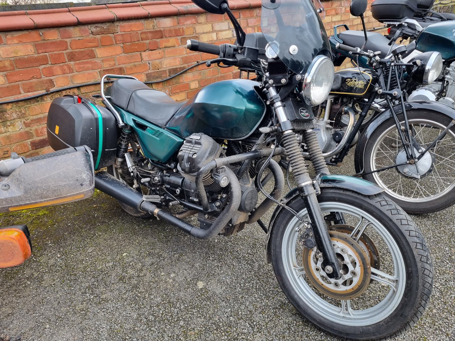

Recently acquired a V75
So after deciding to swap my V11 for a small block, I have recently purchased a V75. It’s an interesting bike but I need to know whether it’s idiosyncrasies (to me !) are just that or faults.
The two main issues are a very heavy clutch and it seems very undergeared compared to my 750 Targa.
I would appreciate any advice on this and any other tips on this model and to share knowledge with any other owners out there.
