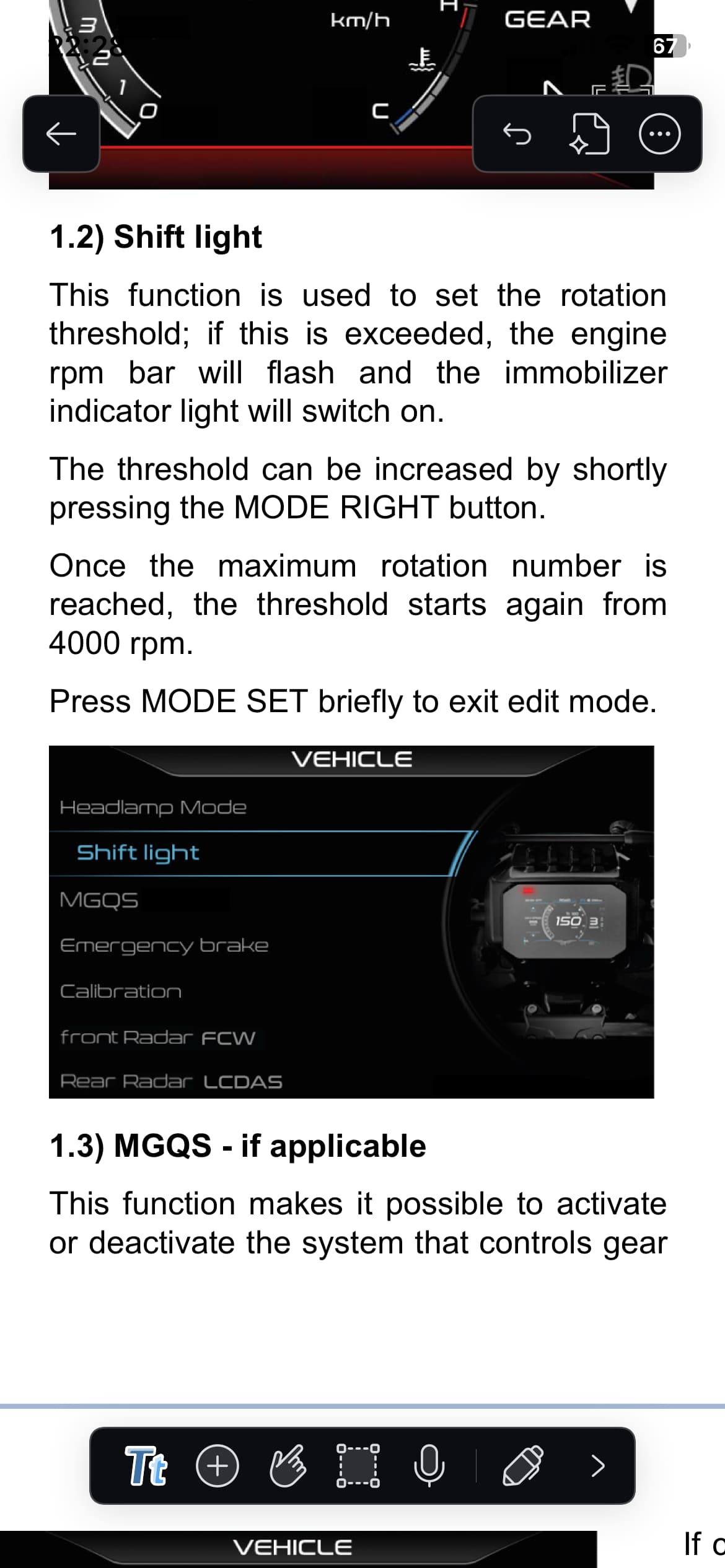

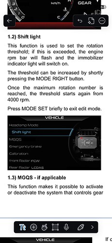

Look for the Shift Light adjustment on the Vehicle page of the launcher menu.
A long press of the right arrow opens the launcher menu.
barneyh. Its been a while, success. Page 44 of the manual.
Thank you so much for your help
sounds like immobiliser light to me, mine only flashes when ignition off. the shift lights are much more obvious and build up through yellow, red, flashing red, and the trigger rpm is changed in the settings barneyh said.
edit:i see from the manual posted above it is the immobiliser light but on v100 this is triggered by rpm… every day a school day !
