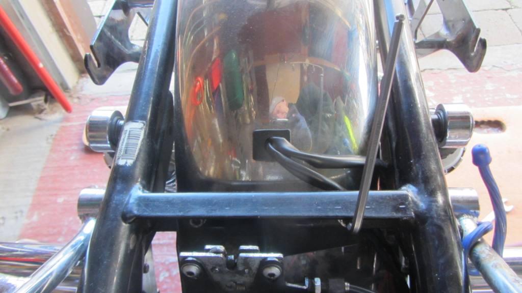

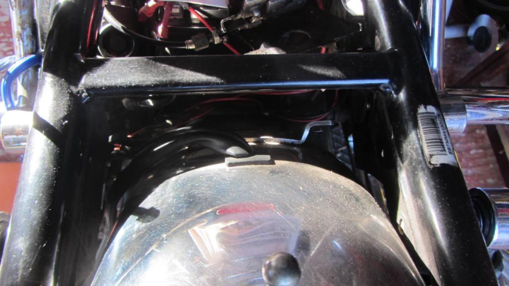

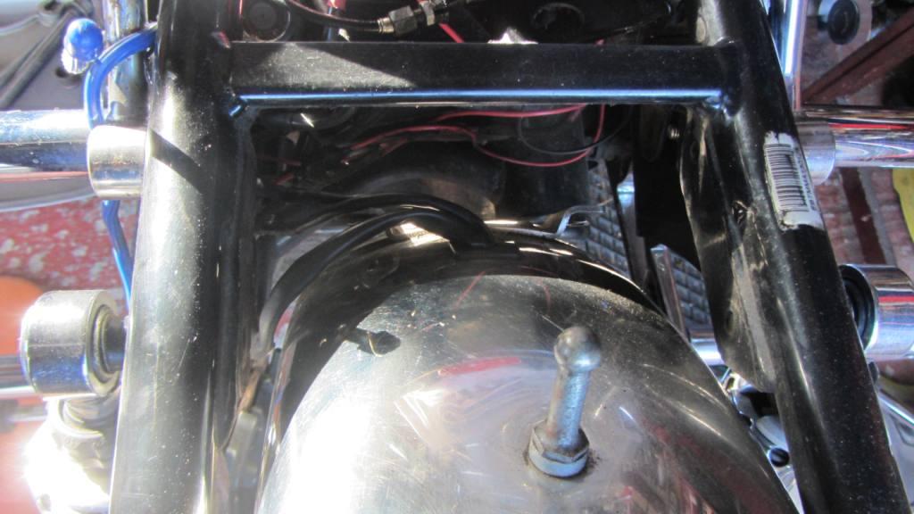

Only thing really stopping me from taking off the mudguard is the wiring, which seems to come straight through to the tail light without any convenient connectors. More investigation needed at the weekend.

“the wiring, which seems to come straight through to the tail light without any convenient connectors” - I know what you mean, hence “consider the location of the connectors” on mine. They weren’t in a convenient place, they now are (o;

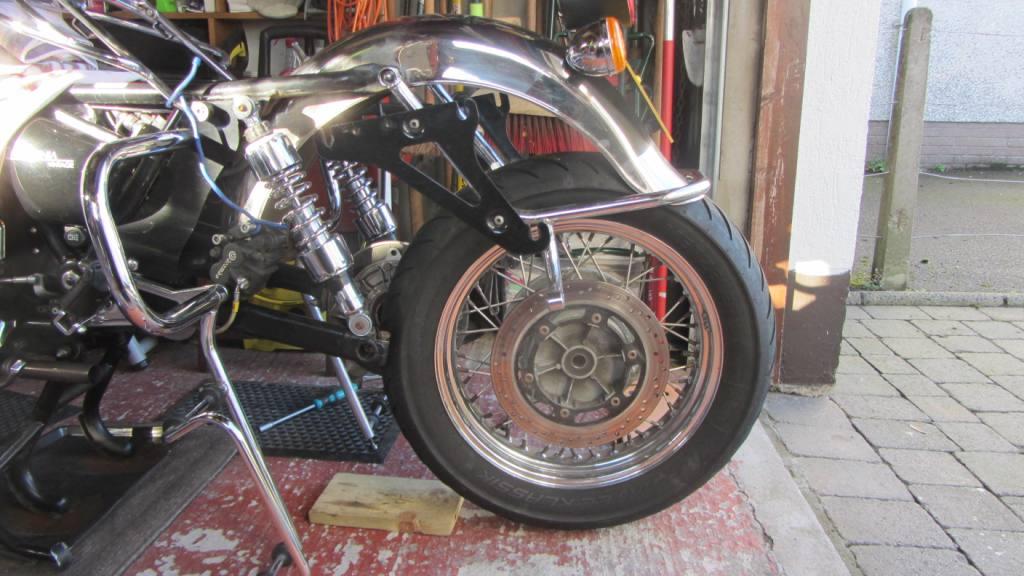

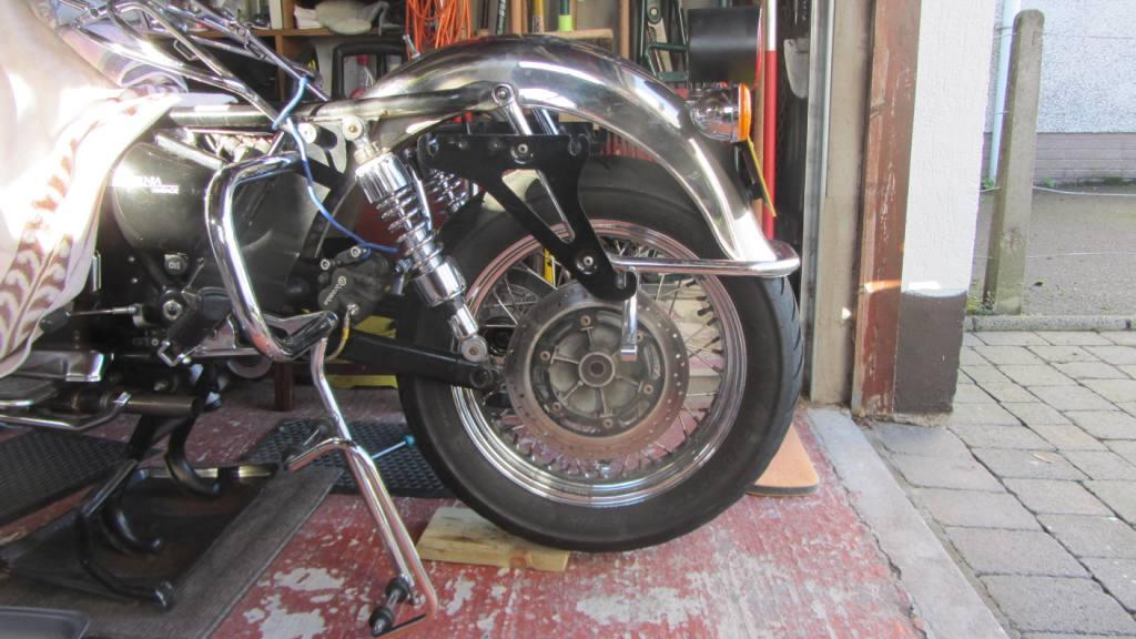

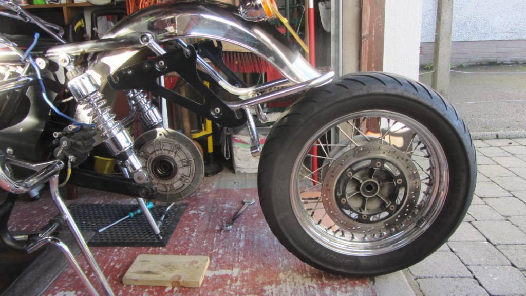

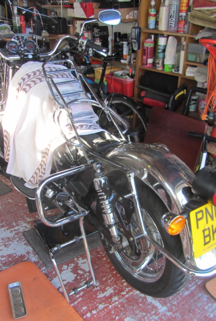

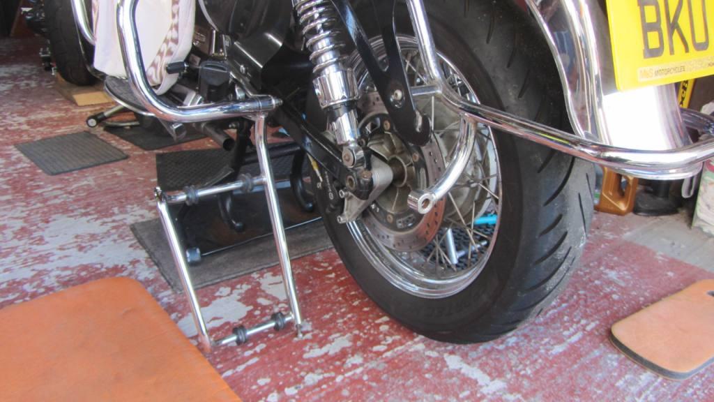

Yes, you can do it without taking the mudguard off.

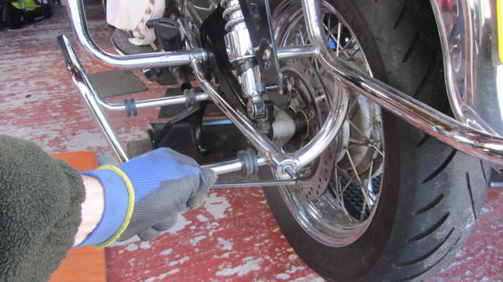

Mine has panniers so I normally take those off, and the silencers. They come off as a pair with the balance pipe more easily than just taking the left one off.

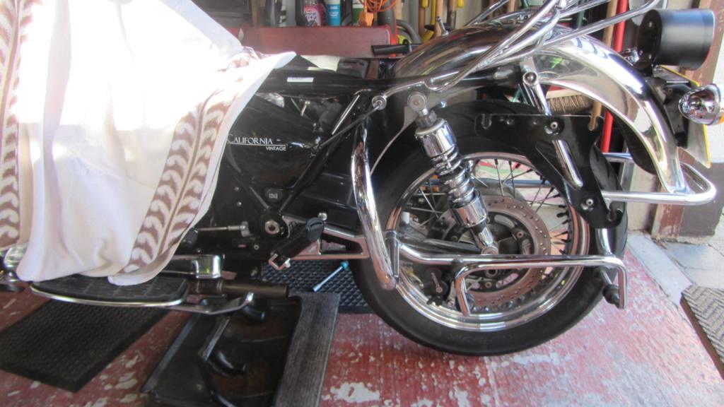

But you need about 4 inches of ground clearance to allow the wheel to drop down before you can wriggle it out from the swinging arm. Best would be a bike lift with removable rear section, but I have used a block of wood under the mainstand which can be potentially unsafe. My better option has been to use 2 short planks and run the bike up onto them so that the front wheel and mainstand are on one, and the rear wheel on the other. Once the bike is on the stand, remove the rear plank.

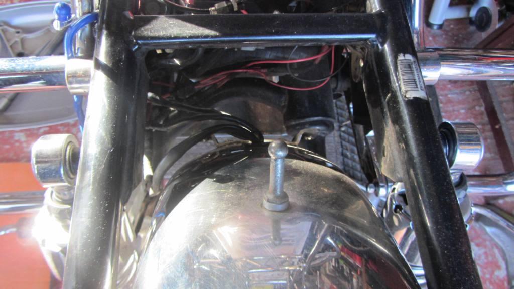

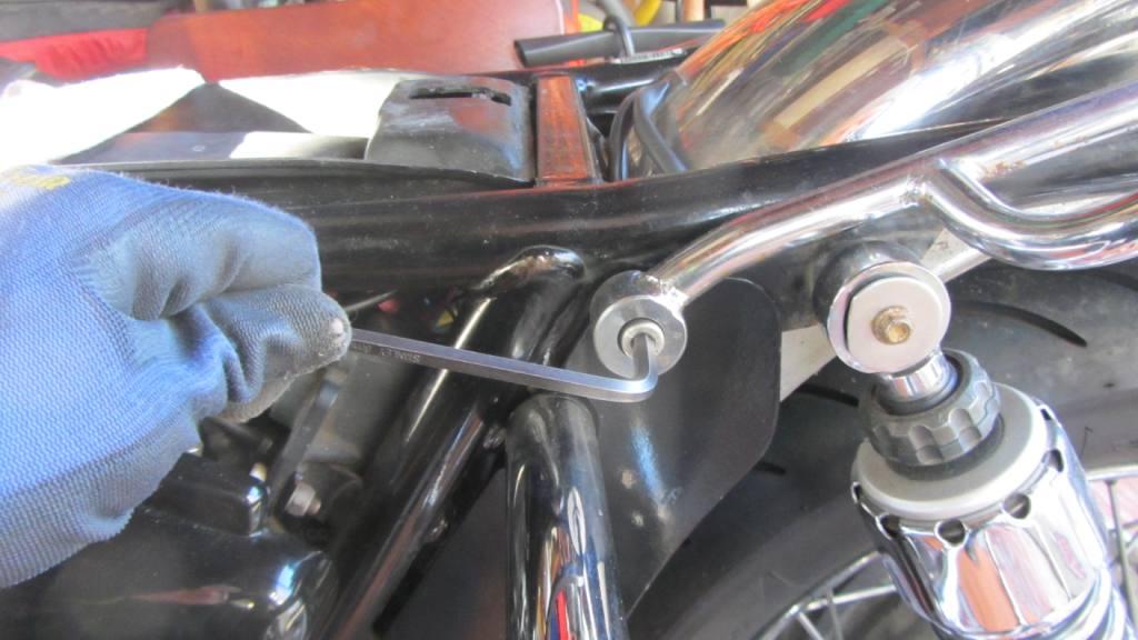

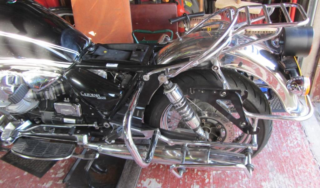

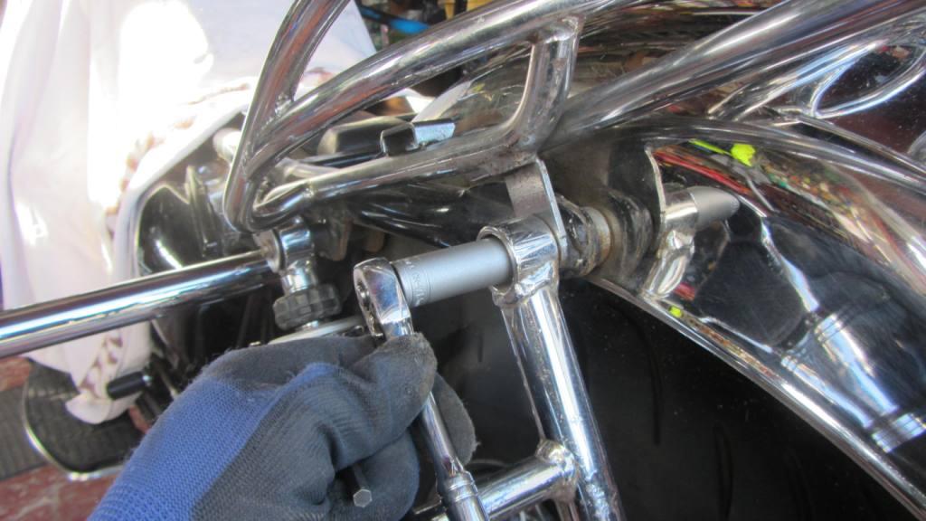

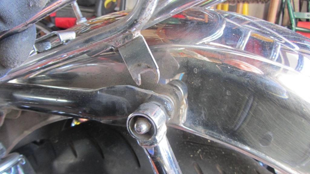

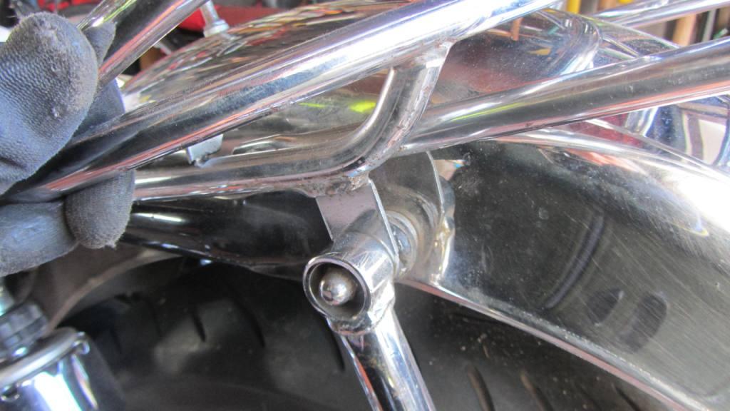

I had the same issue with my Cali Vintage but found that my removing the two screws which hold the front of the rear mudguard I could rotate the mudguard as I rolled the rear wheel out. I appreciate that the frame design at the rear of your Eldorado is different from the Cali V but maybe a slight variation of this method might work for you.
