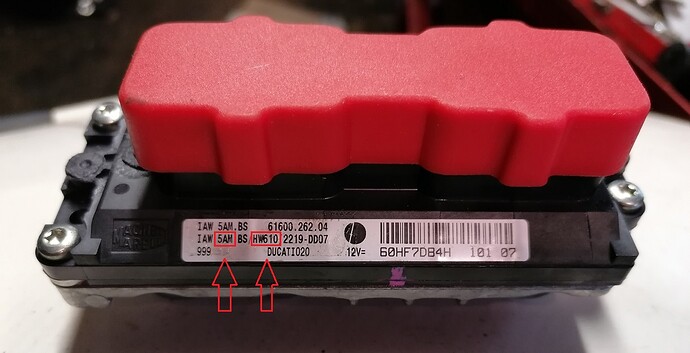

As Johnny says, the ECU is a Magnetti Marelli 5AM.
Any ECU with 5AM AND HW610 on the label will work, just needs a suitable Map loading onto it.
I’m running a Ducati unit on my Stelvio at the moment, after fritzing the original when I cross-connected one of the Injectors.
