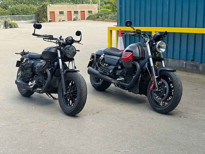

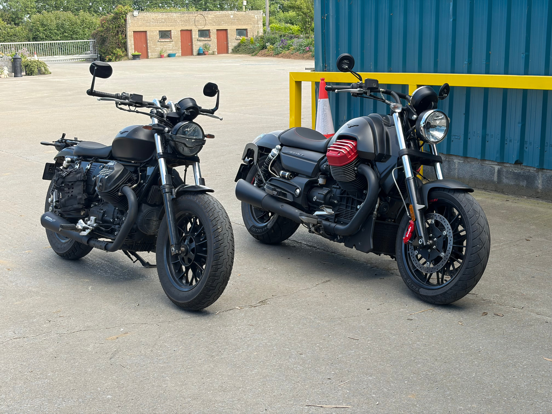

Second v-boost now fitted.
The v-boost from Gutsibits for Elaine’s bike arrived yesterday and having already fitted one to mine the installation took literally 10 minutes. On firing the bike up cold there was the usual minute or two of fluctuating revs before the engine settled at a nice steady tick over of about 1100 rpm. Pick up was again noticeably smoother once the v-boost was fitted. One interesting thing was that when running side by side (both bikes running de-catted), was that Elaine’s bike without the v-boost had what I can best describe as a slightly ‘tinny’ note to the exhaust compared to mine which I put down to the Chinese, £250 de-cat crossover pipe on hers as opposed to the £700 Mistral version on mine. With the v-boost fitted to Elaine’s bike, the tinny sound has gone and to my ears they sound identical now. Not over loud with a nice little crackle on the overrun. The only other mod’ I am considering is a high flow DNA air filter. The bike in all honesty doesn’t need any more power and runs beautifully now. But it’s about the only thing I haven’t compared next to the standard one. And with the richer fuel mix and de-cat causing the bike to run so much better and more importantly, much, much cooler, I figure letting the Goose breath a little better won’t hurt. Cosmetic changes are minimal, a pair of cheap rubber knee grips from AliExpress to protect the fuel tank and a set of soft panniers for when we go touring next year have pretty much got her how I want her. This bike is definitely a keeper!
Sounds great. Wish you could put videos on so we could have a listen :blush:. I love a v twin when it burbles as you knock the throttle off. I did similar to a Harley Iron I had about 12 years ago. Proper soundtrack.
Will try and get some footage this weekend.
That’d be great thank you. I wasn’t sure if we could upload video. :blush::+1::motorcycle::motorcycle::motorcycle:
Nice to see one of Prince Philips little cars in the background
