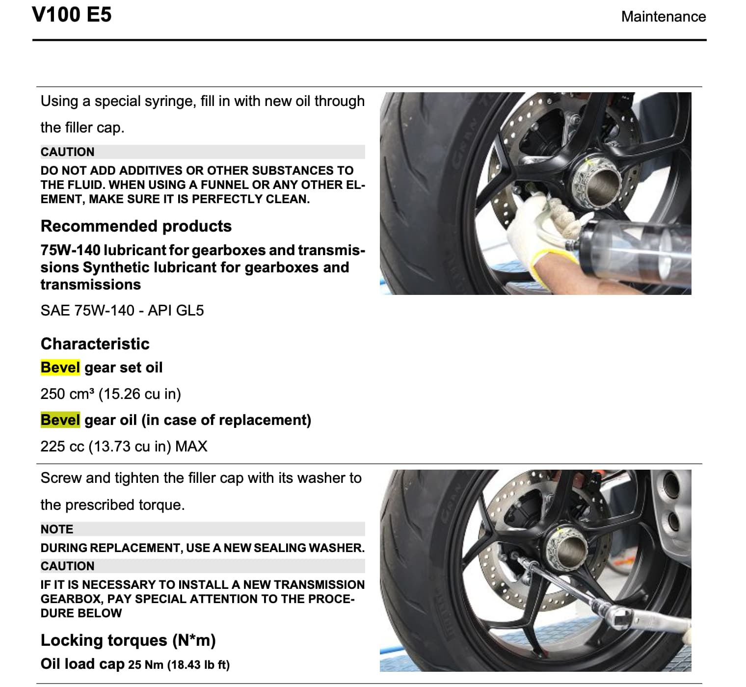

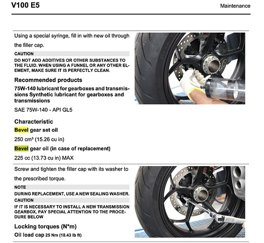

According to the Service Manual, the bevel oil can be changed without removing the rear wheel.
That’s the V100 but I’m presuming the Stelvio is the same.
Yup! Exactly right for the V100 with alloys however the Stelvio with spoked wheels would indeed need the wheel removed.

As I thought. Sorry! I missed that reply clearly! Dave
