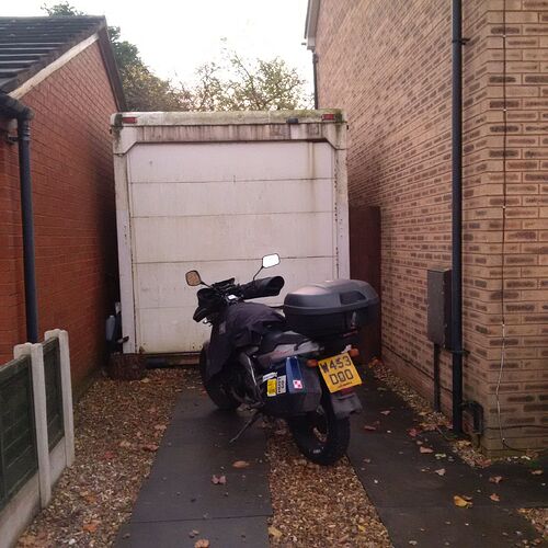

20ft long box body off the lorry, 8ft wide, transparent roof, watertight, lockable, re-movable, what more man would want? And you may find smaller sizes too.

That’s a good space, and a brilliant idea! I guess you don’t get the issue of condensation. I will see what my other half thinks… :grimacing:

If it is moveable it would not require planning permission, as it would be classed as a temporary structure, the same goes for a shipping container. The only time the local authority planning enforcement would take an interest though would be if a neighbour complained.

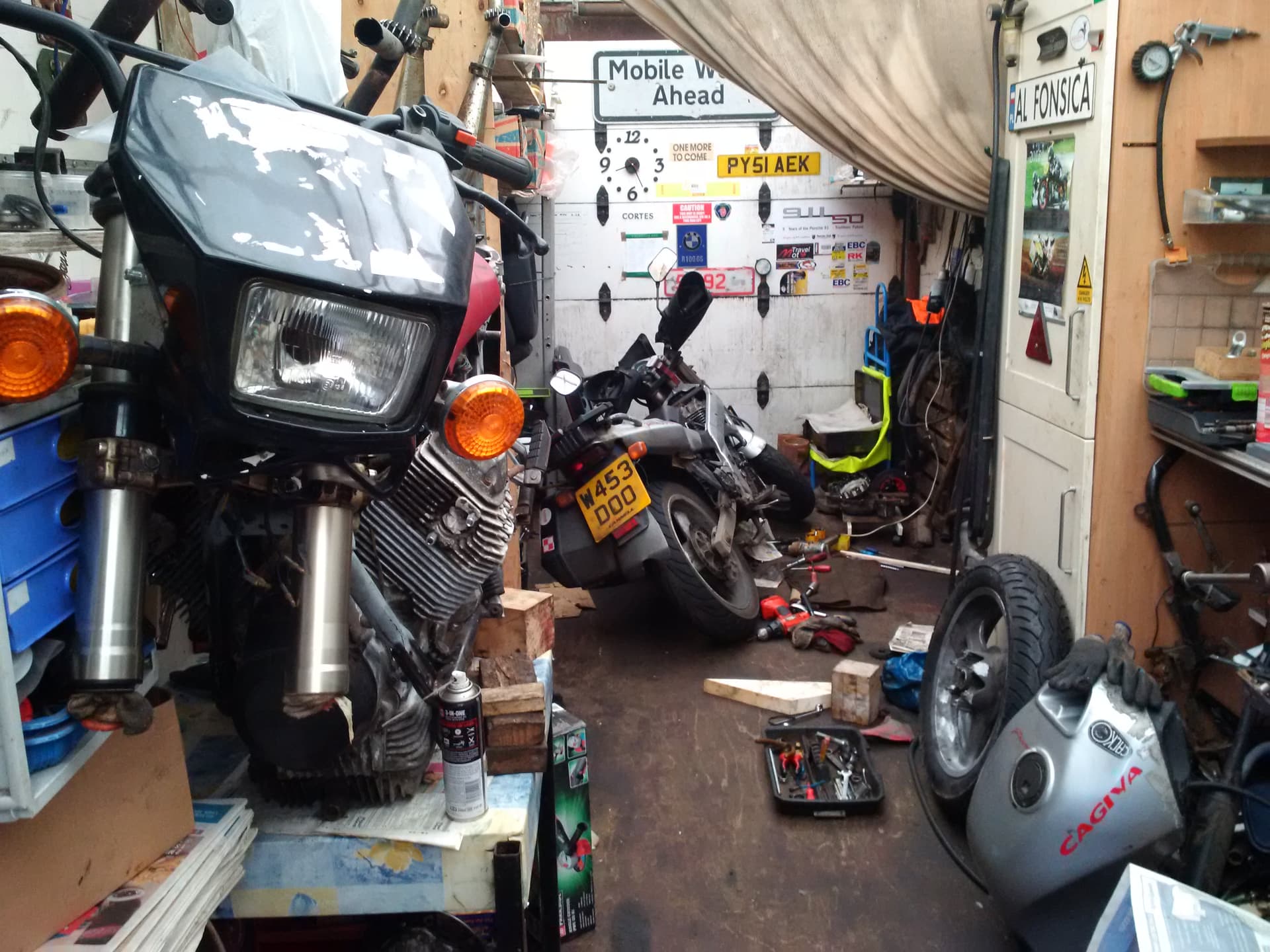

Regarding condensation, I have to admit, winter time is not-so-problem-free; when temperature goes through zero, humid condensates on the ceiling, freezes there and then, the morning after, sort of lazy shower comes. I learnt to cover my tool box, anyway, and I don’t put anything like cardboard, natural fabric etc on the upper shelves. But bright daylight inside is a thing I wouldn’t sacrifice - just see the pic. Happy times in last ten years of ownership, and no complains, apart from abovementioned winter-time issue.
