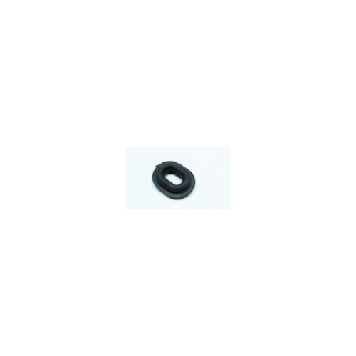

A former member has emailed me to say that these parts are available from Harglo Performance in Wales - he sent me the enclosed image for information.
With thanks to you and the former member. Will check it out.
Russ

Will these work? from REVITE +44 (0)1869 252520 only problem is quantity - I could do with 2 and 2 spare ones for a 2011 V7
Mark, from the parts list above, the ones Russ needs are oval.
Nik’s Euro Bits are listing them on eBay click here
