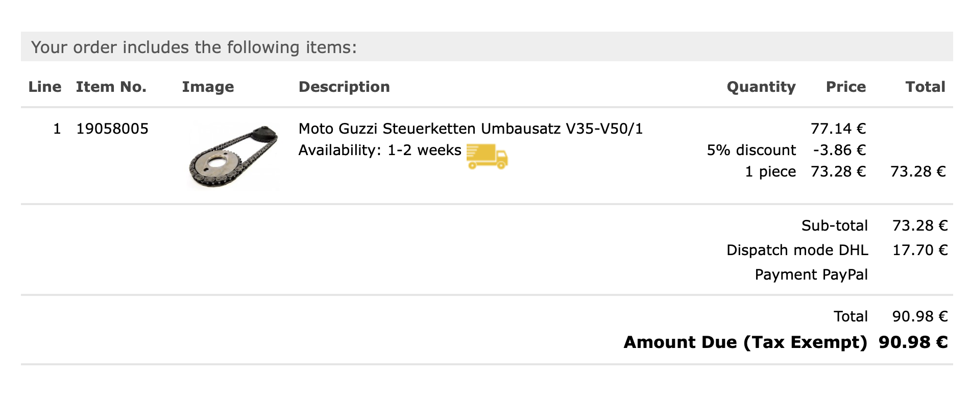

Stein Dinse supply a rebuild kit, containing a simplex chain and both sprockets, for a very reasonable 90 euros-odd including DHL shipping:
