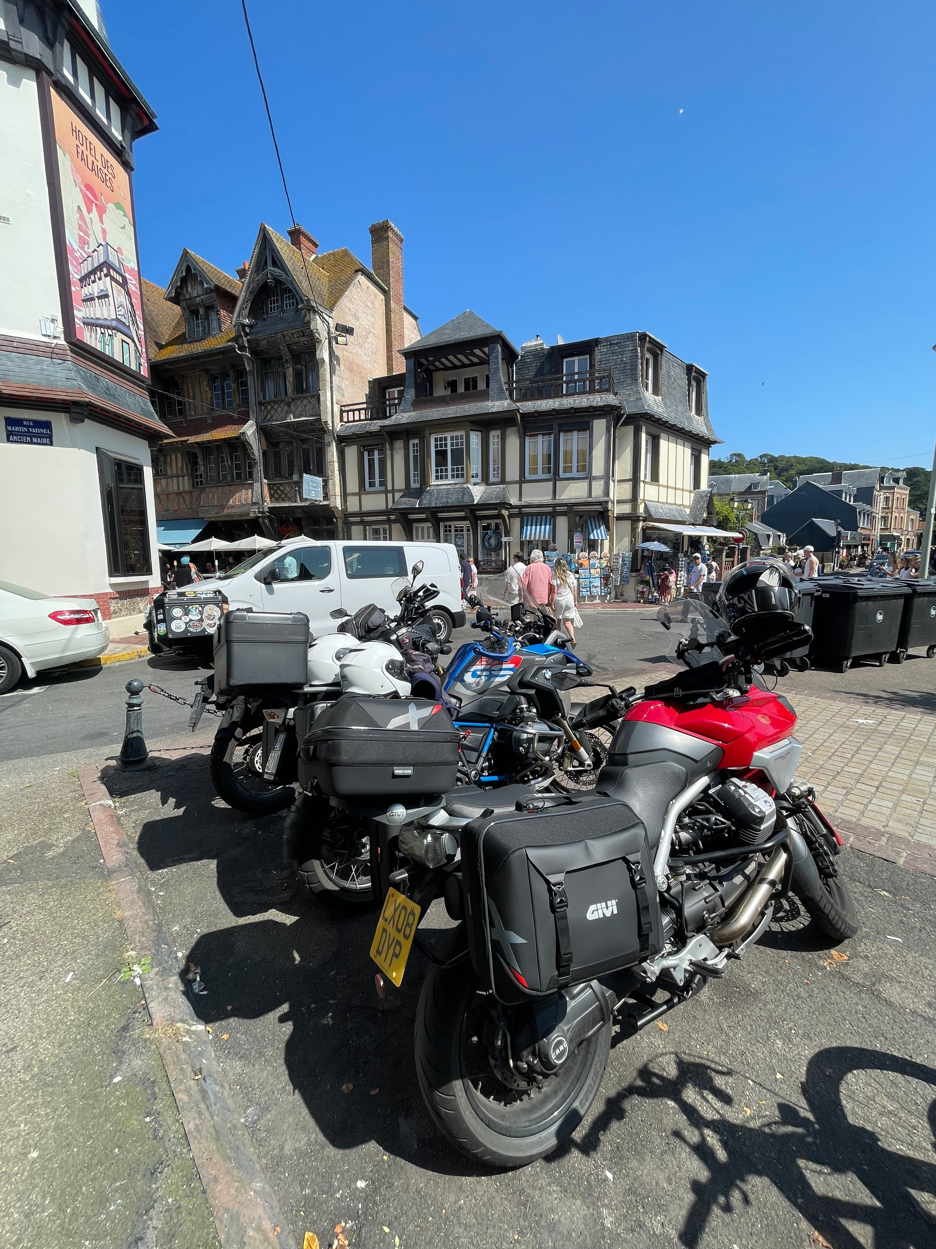

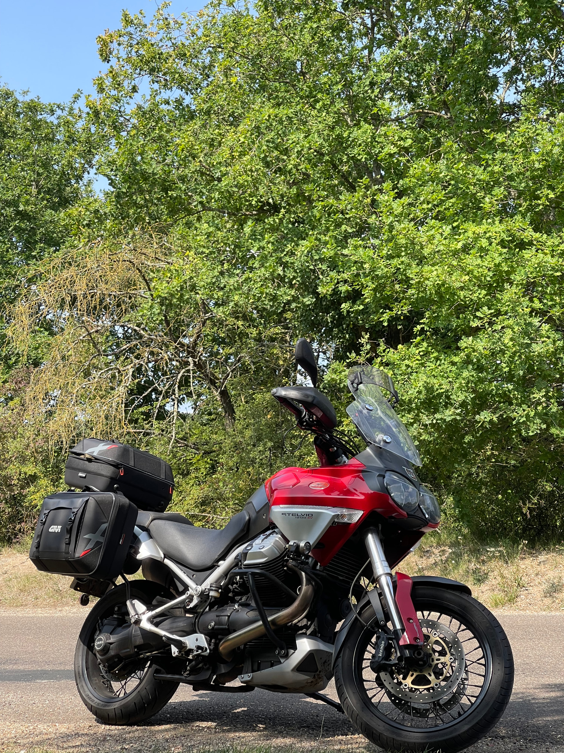

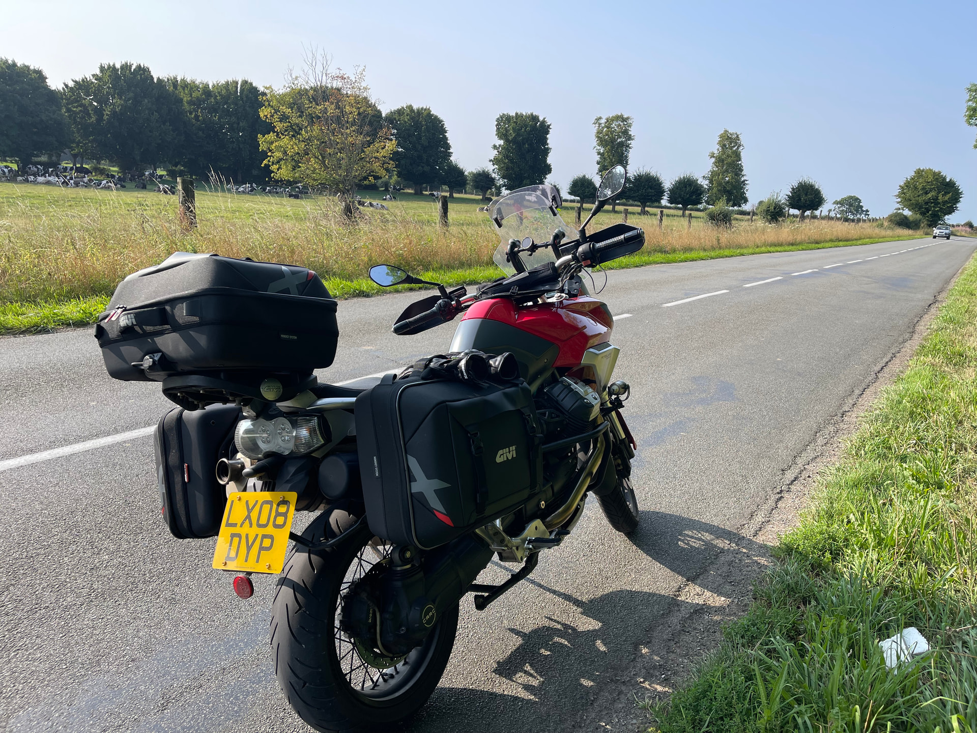

I have 3 GIVI XL09’s on my Stelvio which I really like.
Solid back plate, no issue with high exhaust for me.
Not huge, but I didn’t want big clunky storage.
Link to them here:
https://www.motocard.com/en/bags/givi-xl09_monokey_black_xl09.aspx?country=GB&currency=GBP&srsltid=AfmBOoruUHfmEfIhhtlIa9gSo8sIdkRDctlCeA6BlGtfSK4fyFuHOGwpIew

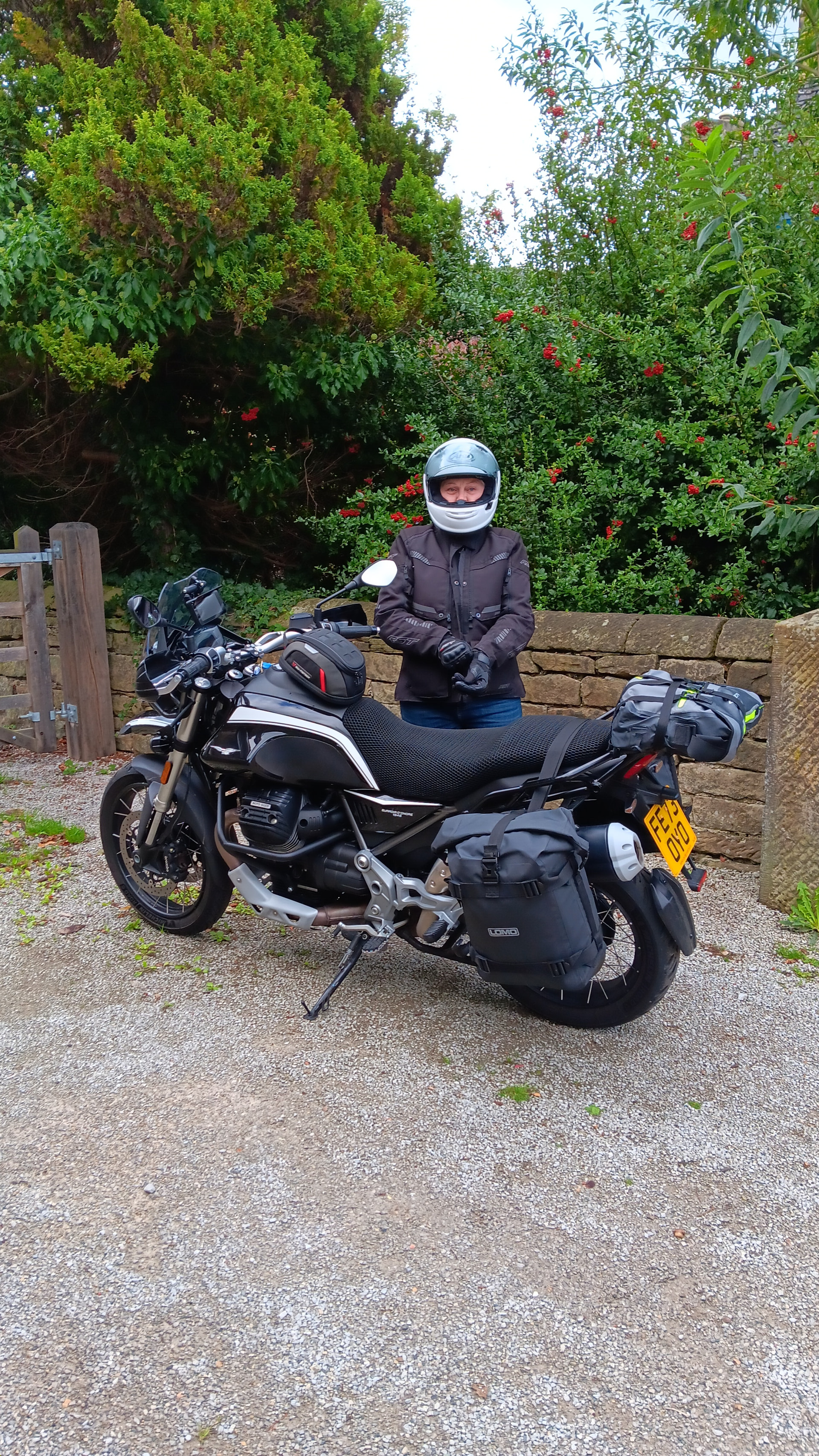

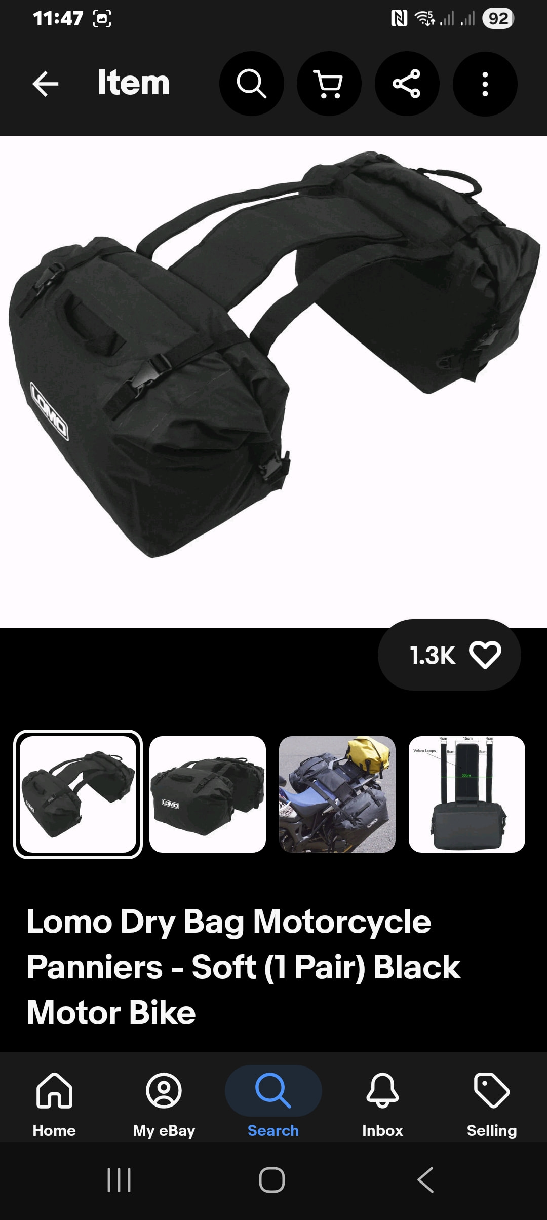

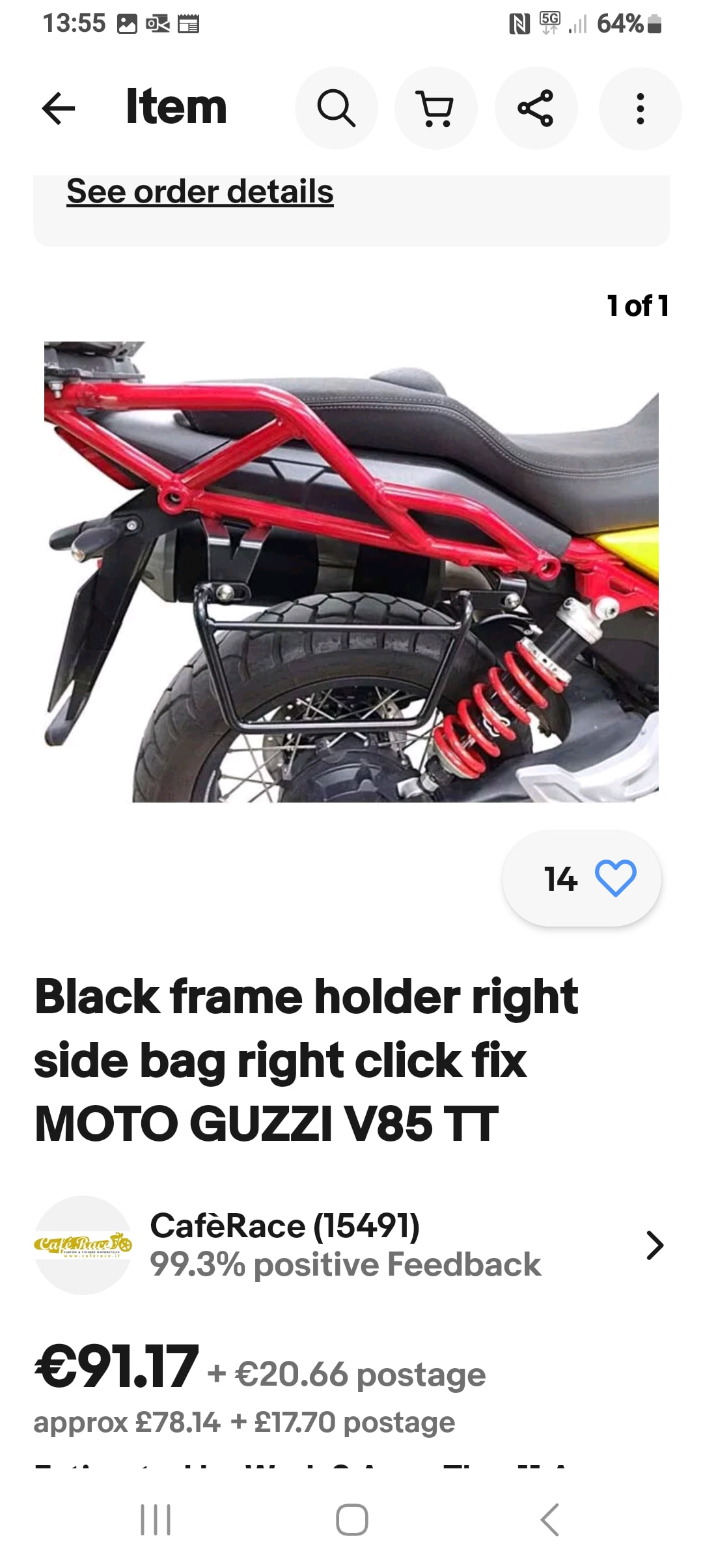

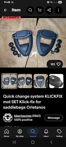

This is my set up. Lomo bags modified to fit with the click system. I don’t really go for hard luggage as its not right for me. The Lomo bags are drilled so that the click system bolts on(clamps inside and out ) very easy to do. Then sealed with a waterproof mastic.
It’s never let me down but if it looks iffy I use waterproof bags as well. I use the small adventure bag as an everyday bag as its easy to remove as I do not use the locks.
Hope this helps.

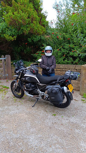

I hope that you enjoy your V85 when it arrives. It sounds like you may be getting a new one, so my experience with my 2019 version may not be too relevant. I have tried, and liked, two options.

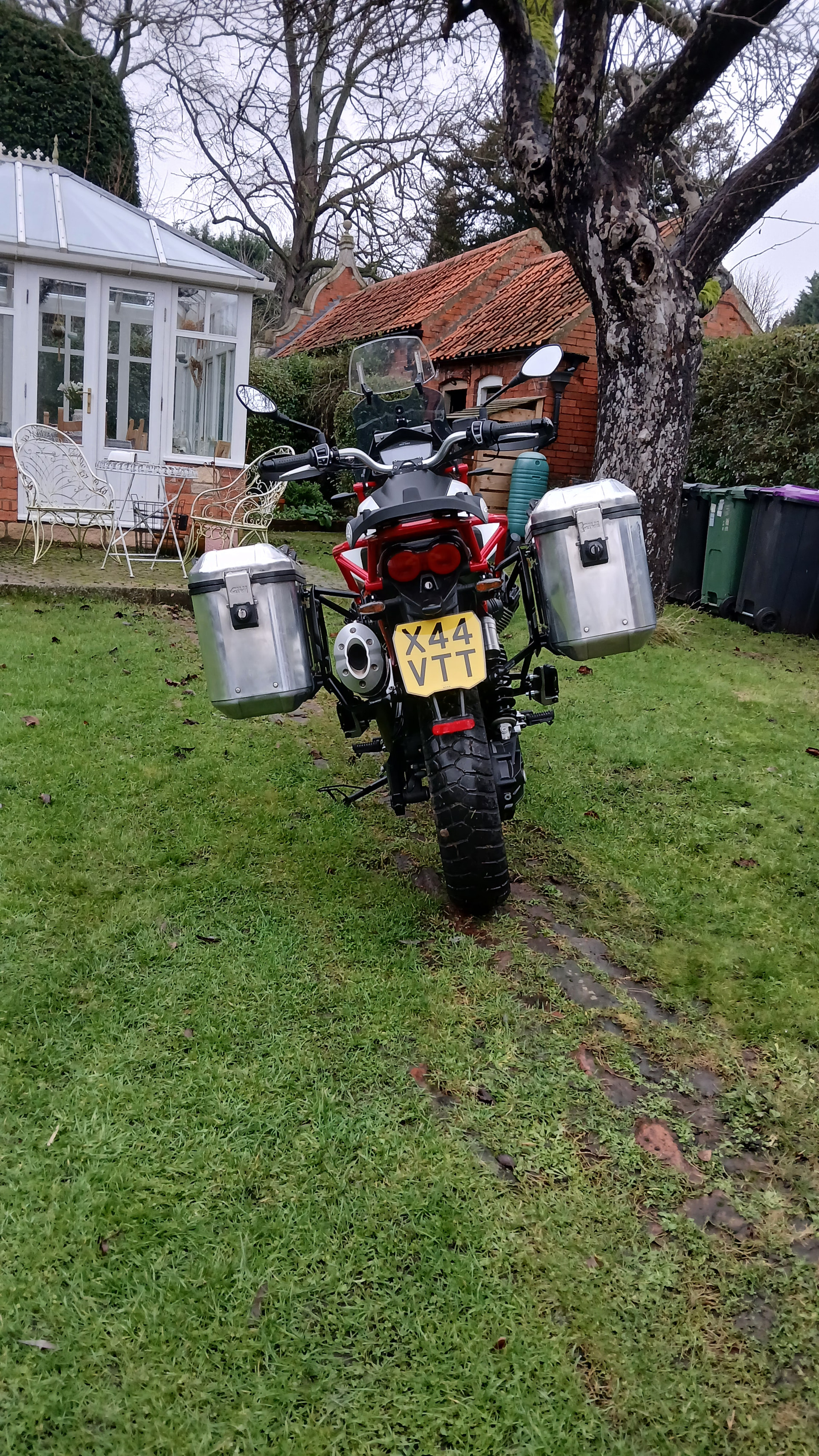

For a while I didn’t think that I would be able to use my Givi aluminium panniers because Givi’s rails for the V85tt have a wierd design, in my opinion, which requires the indicators to be relocated below the number plate. The picture below shows them with SW Motech rails. These can be adapted using a fitting kit to hold Givis. They have a handy quick release feature, so you don’t need to leave big ugly frames on the bike.

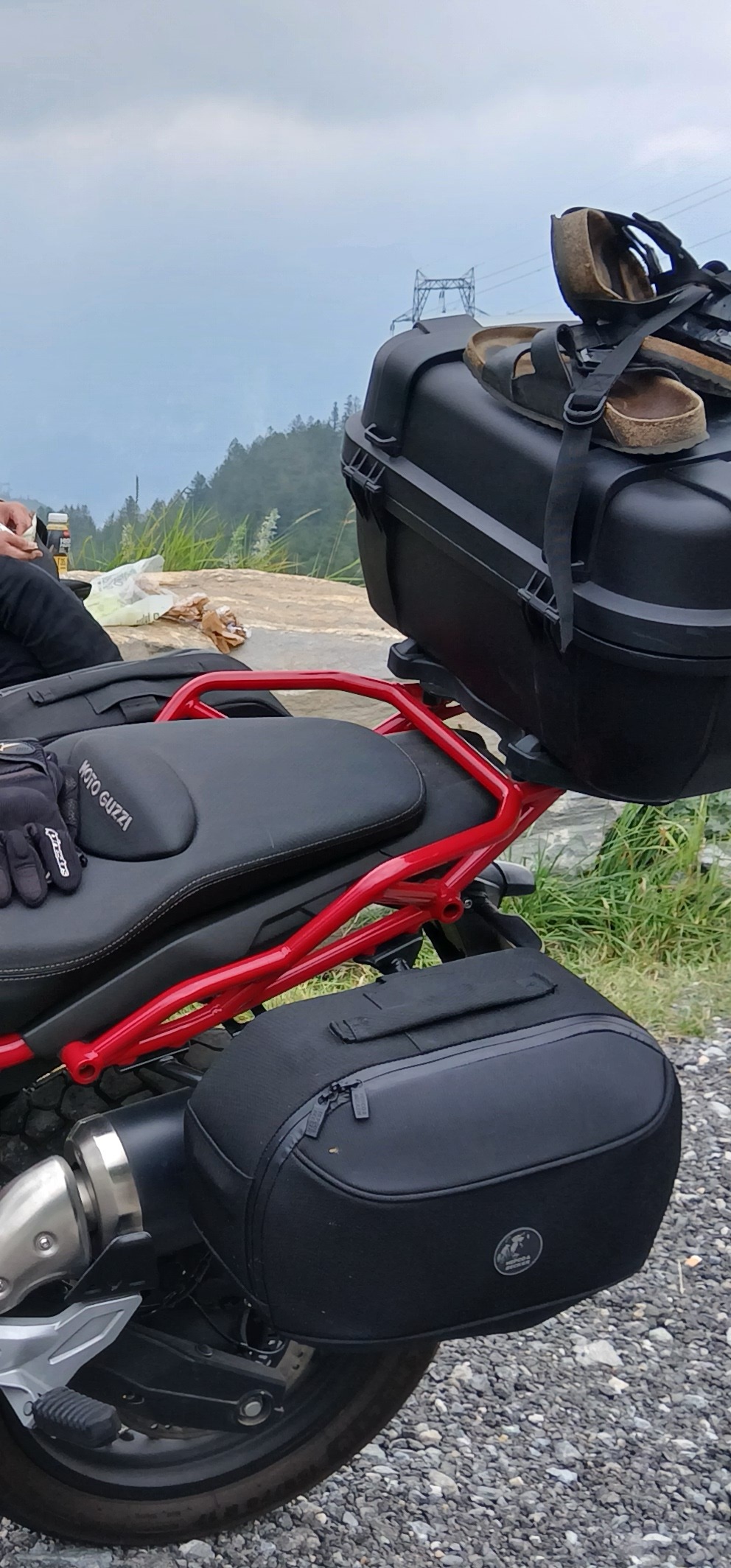

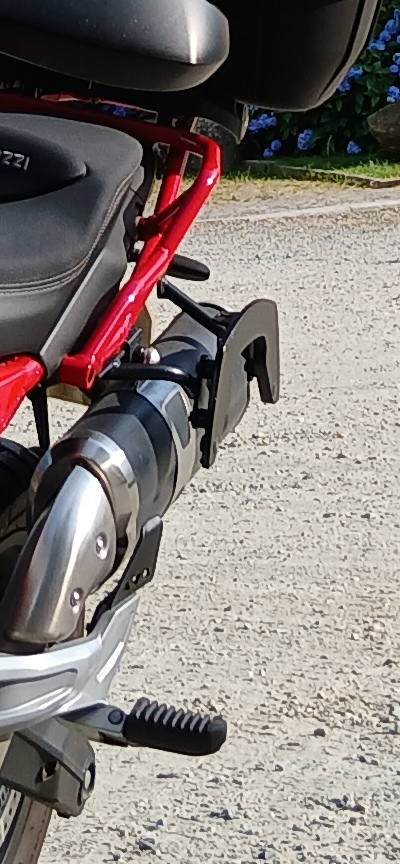

I have also liked using Hepco Becker C Bow panniers. The hangers keep the cases tidy and away from the exhaust. I think the hanger is discreet and like how easy it is to slide the cases on. They offer a variety of cases, mostly soft. They have a semi firm inner, so they don’t sag. They’re not as waterproof or large as the Givis, but they have worked well for me, keeping all but the very wettest weather out.
I hope this is some help.

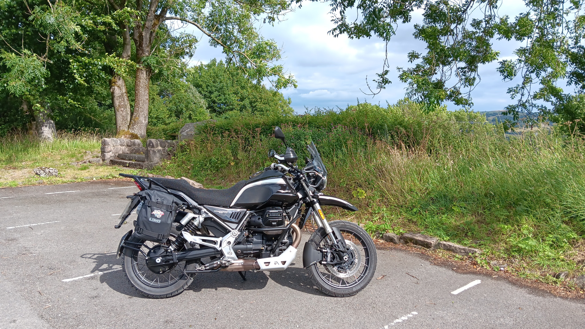

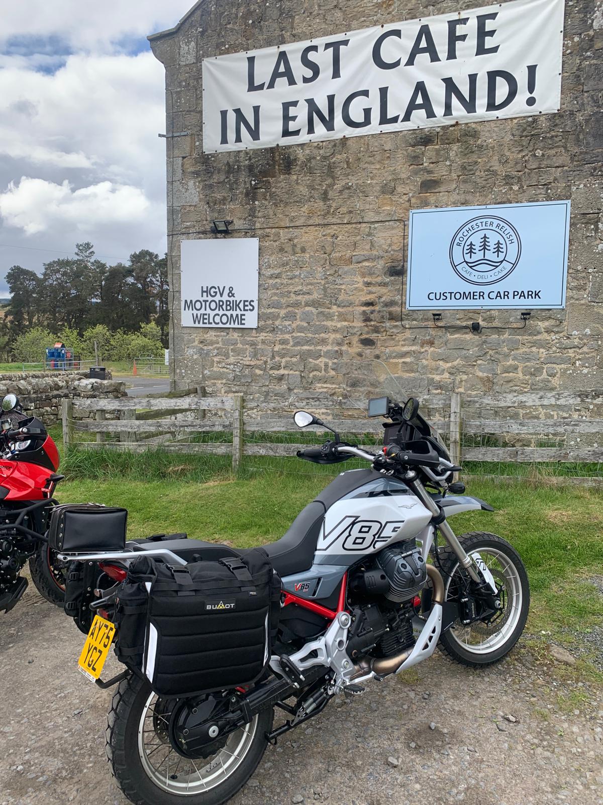

I bought a new V85tt earlier this year & decided I didnt want solid panniers.
After much deliberation I went for Bumot & must say very impressed with quality & ease of use.
Sweet! That’s a neat looking setup! Very unobtrusive!
