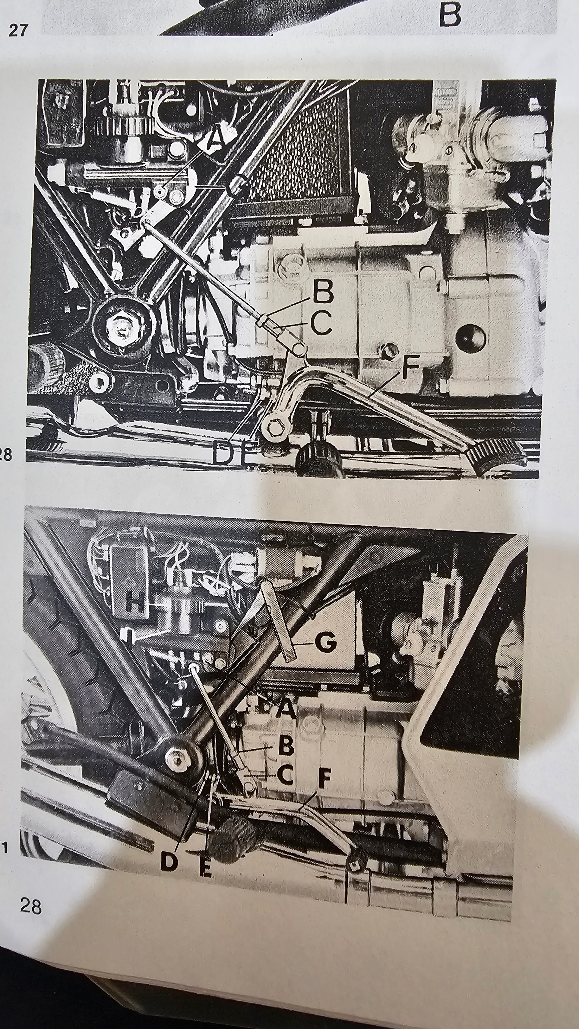

Barry is right about the other models being an option but l don’t think any of them will work. The G5 has rail mounted pegs, like some Calis, 50 mm further forward and slightly lower but also has foot controls to match which would hit the fairing.

From the manual. G5 top Sp bottom.

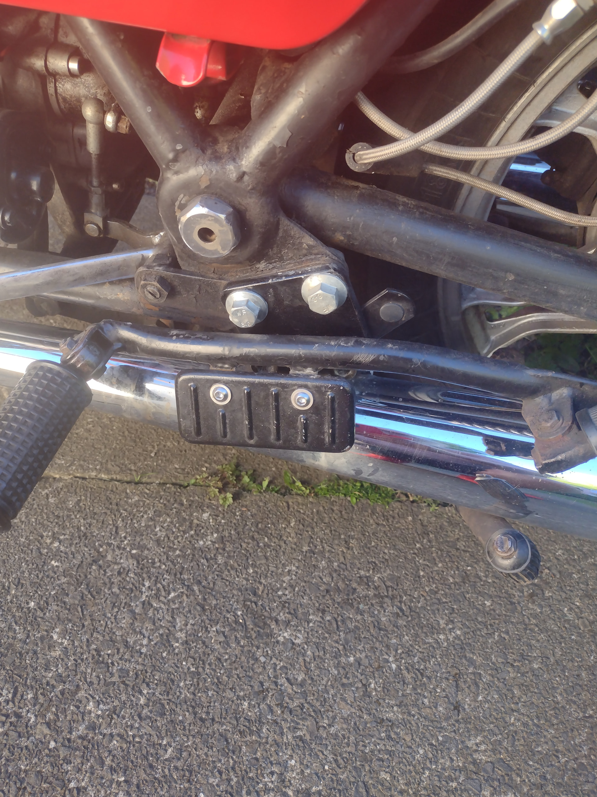

Yes… although my alteration was to allow my pillion an easier longer less cramped reach for her legs. From 8mm x 100mm mild strip I cut a trapezoid (:thinking:) with four 12mm holes, which allowed the pillion rests another inch and a bit ,which made a lot of difference. I also needed to change the upswept lafranconis for a cheap pair of dunstall rip offs for clearance. The original hangars bolted onto this plate. I see no reason not to adopt this approach, however, there seems only so much you can get away with in respect of the foot controls clashing with the frame rails.

Hi all thanks for input,I’ve removed the side wings to give a little more adjustment so now my knees don’t bounce of the fairing,however I thought about lowering the footpegs but then foot controls are a problem and exhaust is in the way,as you say seat height might help gonna have another look. :+1:
… this kinda thing :relieved_face:
