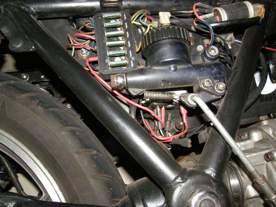

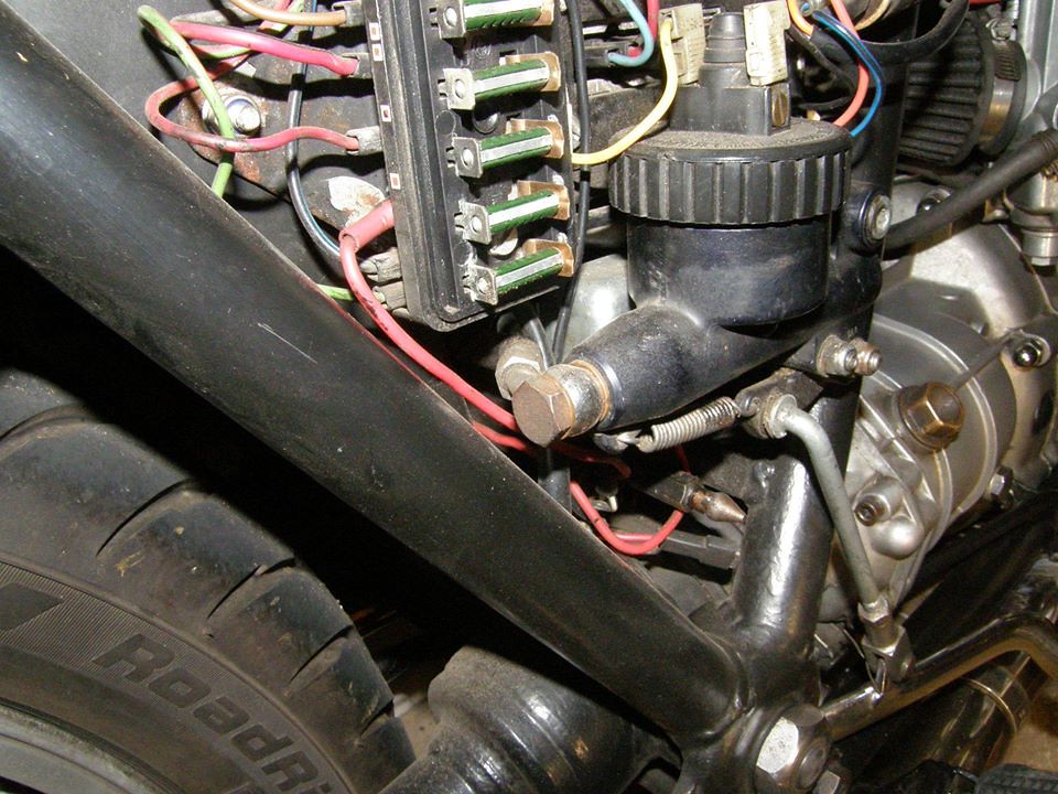

Most Guzzi starter issues are actually down to the way that Guzzi wire the starter relay and a few years worth of corrosion in the ignition switch and connectors. Did you hear a click from the relay when it was playing up? I transformed the starting of mine with a simple extra wire from the fusebox to the relay like this.
Relay wiring mod1 by Don West, on Flickr
Relay wiring mod2 by Don West, on Flickr
The extra wire is the red wire from the fusebox to the starter relay.
