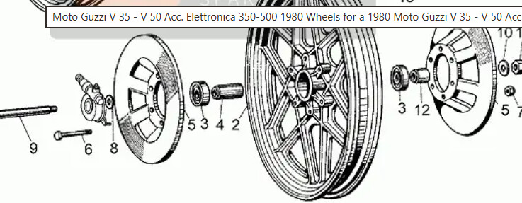

Here is a parts list, item 8 I think is the spacer that fell out. sits behind the speedo drive.

Thanks for taking the trouble to post this - the part that fell out was the inside of the speedo drive - an item similar but shorter than the one on the other side of the wheel. It took some time to discover where it came from and appears to be a push fit. I’ve put it back with the aid of a vice and it seems to be secure.
Item 8 is described in the parts list as a spacer but is more like a shim or a washer.
