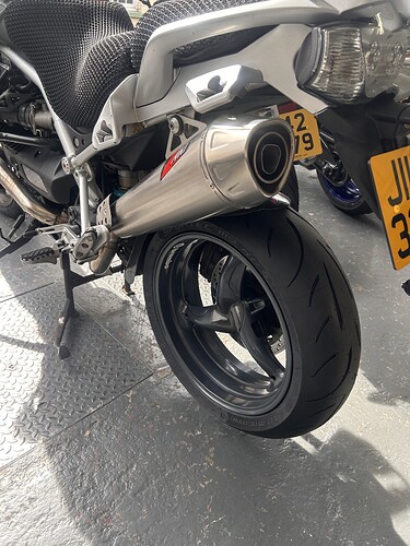

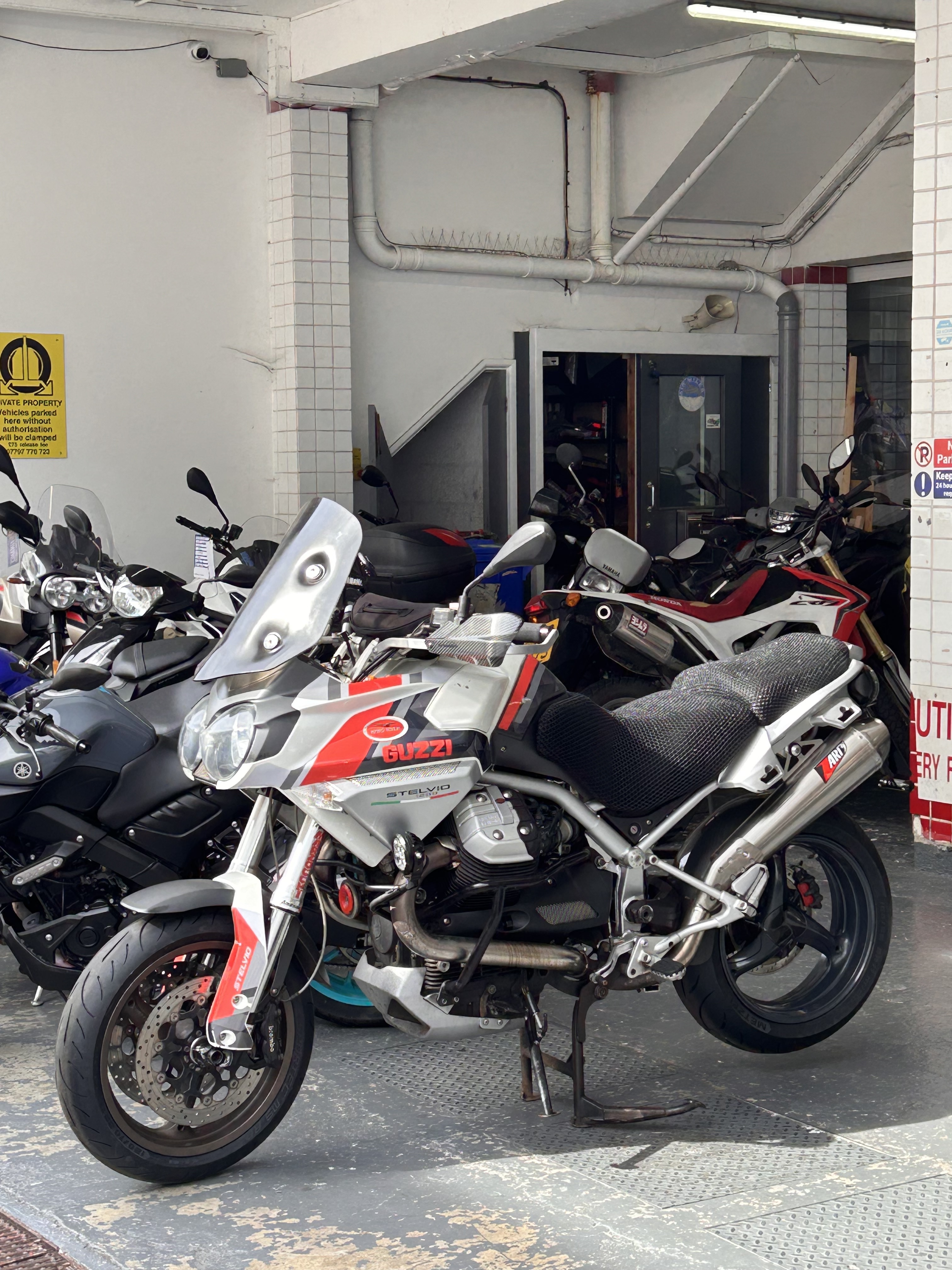

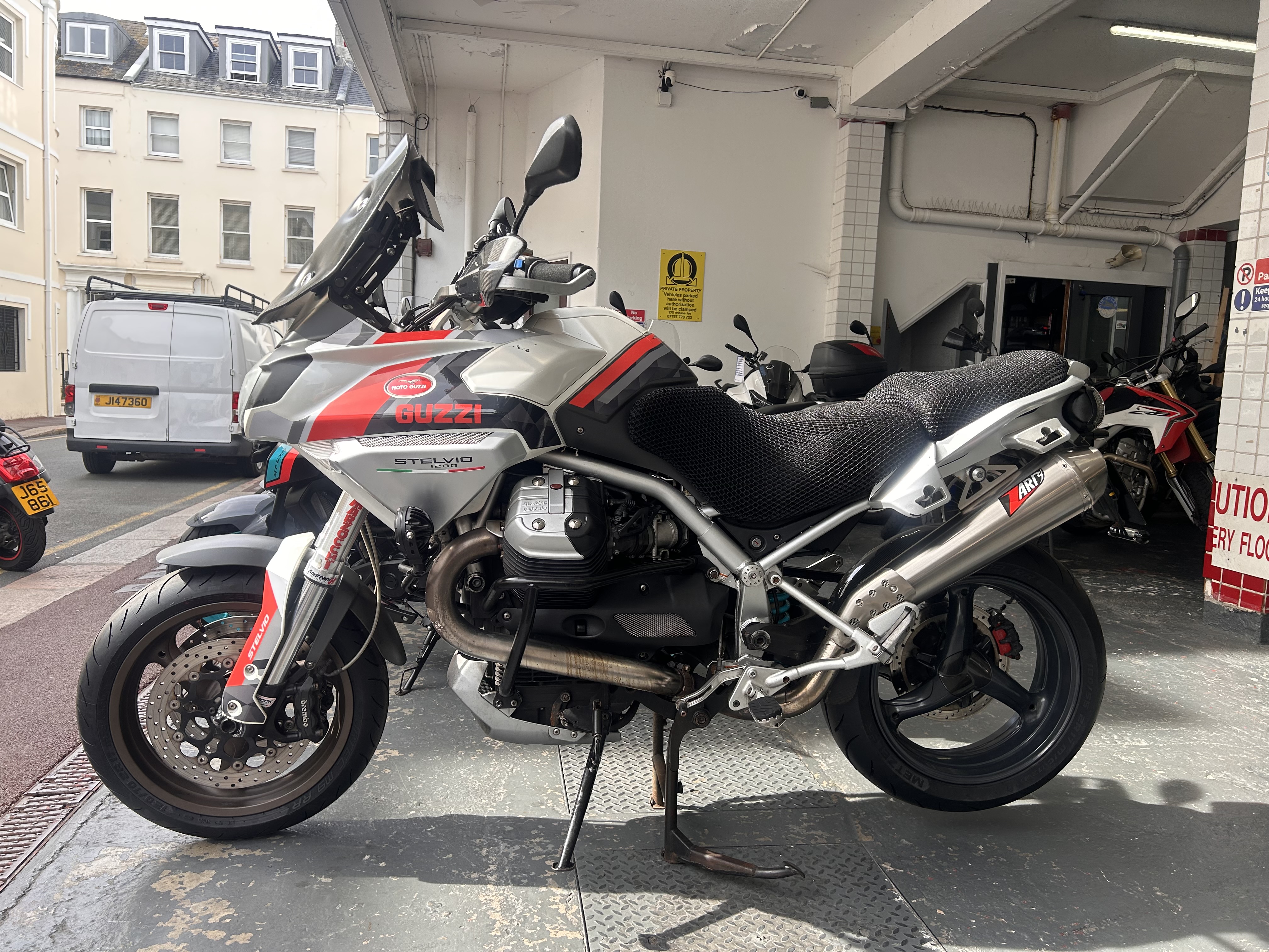

Thought I’d post on the forum now that I’ve finally got the 17” conversion fitted and have had a chance to ride my bike post-conversion. Also thought it would be a good idea to have this here if anyone wanted to do something similar to their Stelvio 1200.
For anyone interested in the actual setup, I’m using the lightweight OEM Brembo front wheel from a V11 Le Mans with a Norge Brembo rear wheel.
The V11 front turned out to be a surprisingly straightforward fit. The hub width is essentially the same as the Stelvio wheel and the original Stelvio brake discs transferred straight over and lined up correctly, so no disc spacers were required.
I used a Norge front axle, which is slightly longer than the Stelvio axle, so I only needed a small axle spacer to take up the extra length. Other than that, there was very little drama involved in getting the front wheel fitted.

5. Slightly more aggressive riding position
Because of the inherent reduction in front axle height from going from 19” to 17”, the bike naturally sits slightly more nose-down.
That gives the riding position a slightly more aggressive feel — a bit more like a Multistrada or S1000XR — and puts a little more of your weight towards the front axle.
The result is loads of front-end confidence. It feels very planted and you get a much clearer idea of what the front tyre is doing.

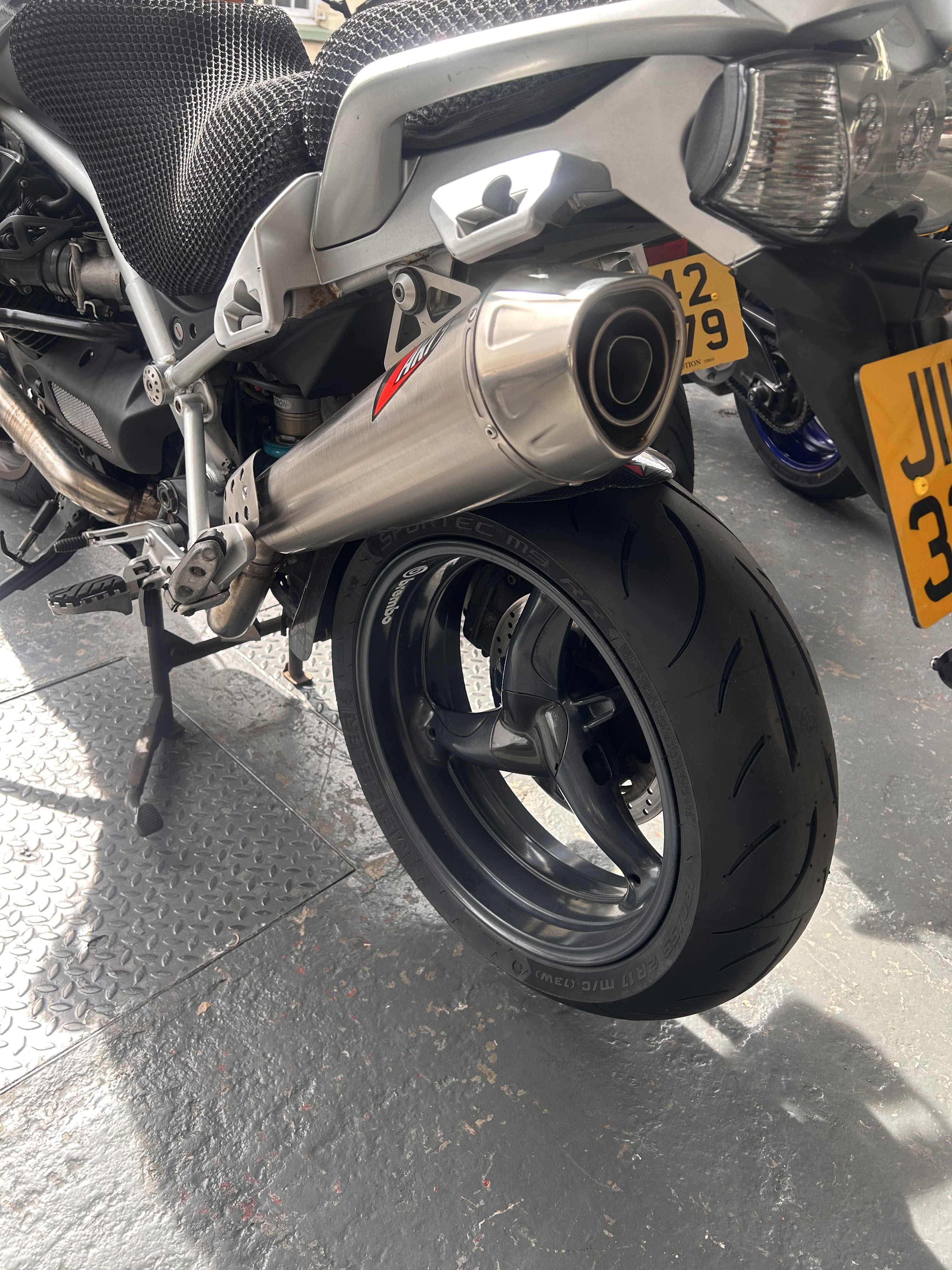

Looks good and v interesting. What about the rear wheel? Fitting - straightforward? Love the Zard exhaust btw.
Fits straight on. All CARC bikes - Stelvio, Norge, Griso, Bellagio, Sport, etc have the same rear CARC system and use the exact same bolts and bolt pattern. Rear wheels on those models are interchangeable with zero mods required.
