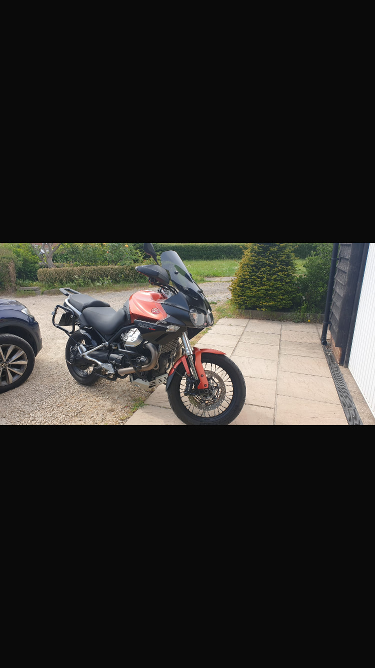

After a long search and looking a couple of duds I am delighted to have bought a Stelvio NTX 1200 2015 plate with low miles and in fantastic condition from a lovely gentleman in Basingstoke. One like this is a rarity as it should have factory roller heads and nearly one of the last of these made. I will be selling my Triumph Tiger 955i 57 plate (one of the last of those made) soon :+1:

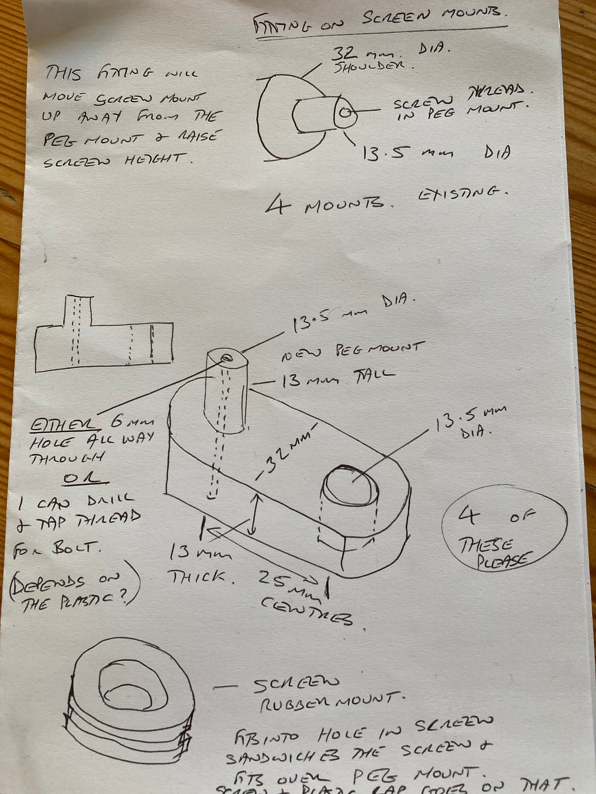

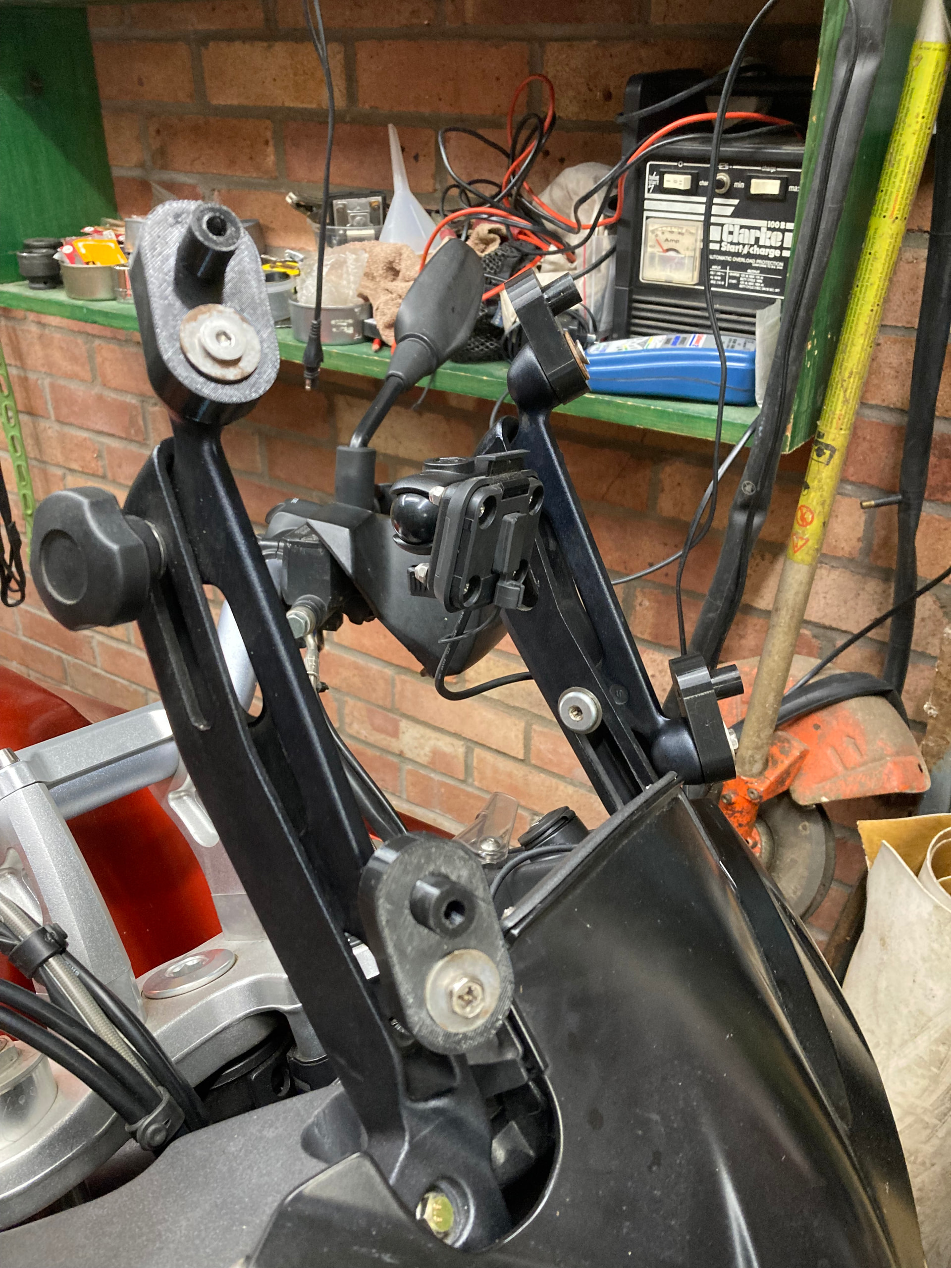

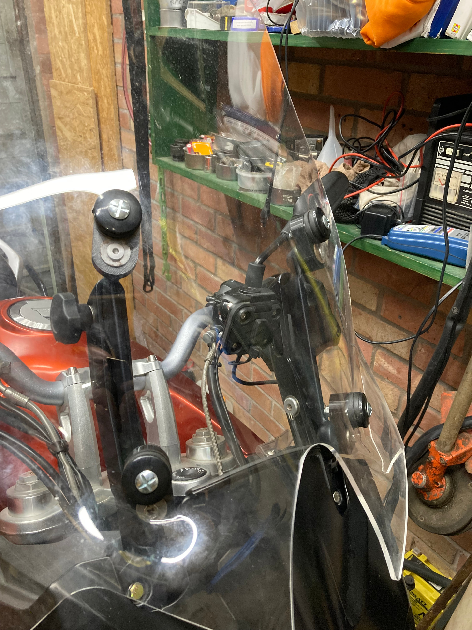

Well - getting used to the Stelvio 1200 NTX and loving it - really stable, good power and torque (especially for rapid overtakes​:wink:) great sound although I find the GPR can a touch loud (came with the bike and no standard can) downsides are the lumpy cold and lower speed running and popping on overrun and wind noise. Must get a Beetle remap sorted but im not a digi tech whizz. I jave sorted the wind noise for the most part - by spacing out the screen pillars and my son 3d printed from abs a set of screen adapters to space out and raise the screen - easy to fit ! Reasonably quiet even at higher speeds. Just need some nicer bolts now to tidy up - ive included info in case anyone wants to do it themselves​:+1:
