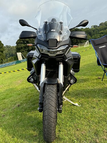

Thought I’d provide a quick bit of feedback on the Givi Screen ( D8208ST) made specifically as a replacement touring screen for the new Stelvio. Having just been down to Mandello and back I have to say it has been excellent - in the low position there is little turbulence and in the full height position there is clear air and little noise at motorway speeds. I’m 5’11’’ and in the higher position you need to look through the screen but on the motorway I didn’t find this a problem in the dry - the lower position still allows you to look over the screen with minimal noise. My top half remained remarkably dry even in torrential downpours as long as forward momentum was maintained.
So just for feedback as I know replacement screens are quite personal.

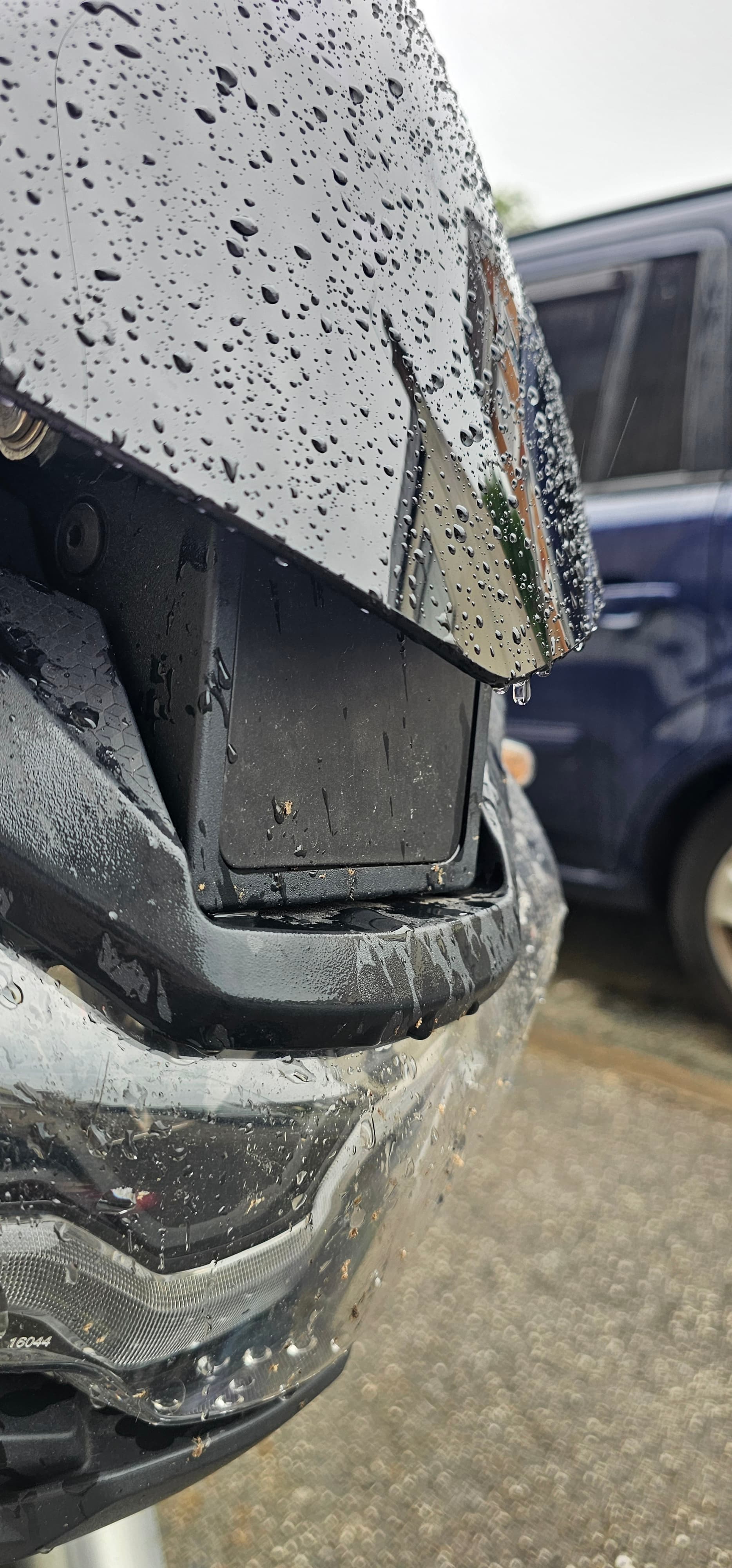

I have also fitted the Givi screen to my new Stelvio. I had to modify it so as to clear the PFF radar unit. The original screen was not bad, but I always had it in the raised position and that left a gap which rain came through.
Love the bike.

What mod did you do to fit the PFF ?
I used the original screen as a template, mark the area to be removed. Then used a Dremel to cut out and shape. Sanded with 800 and 1200 grade wet & dry, a final polish with Brasso wanding.

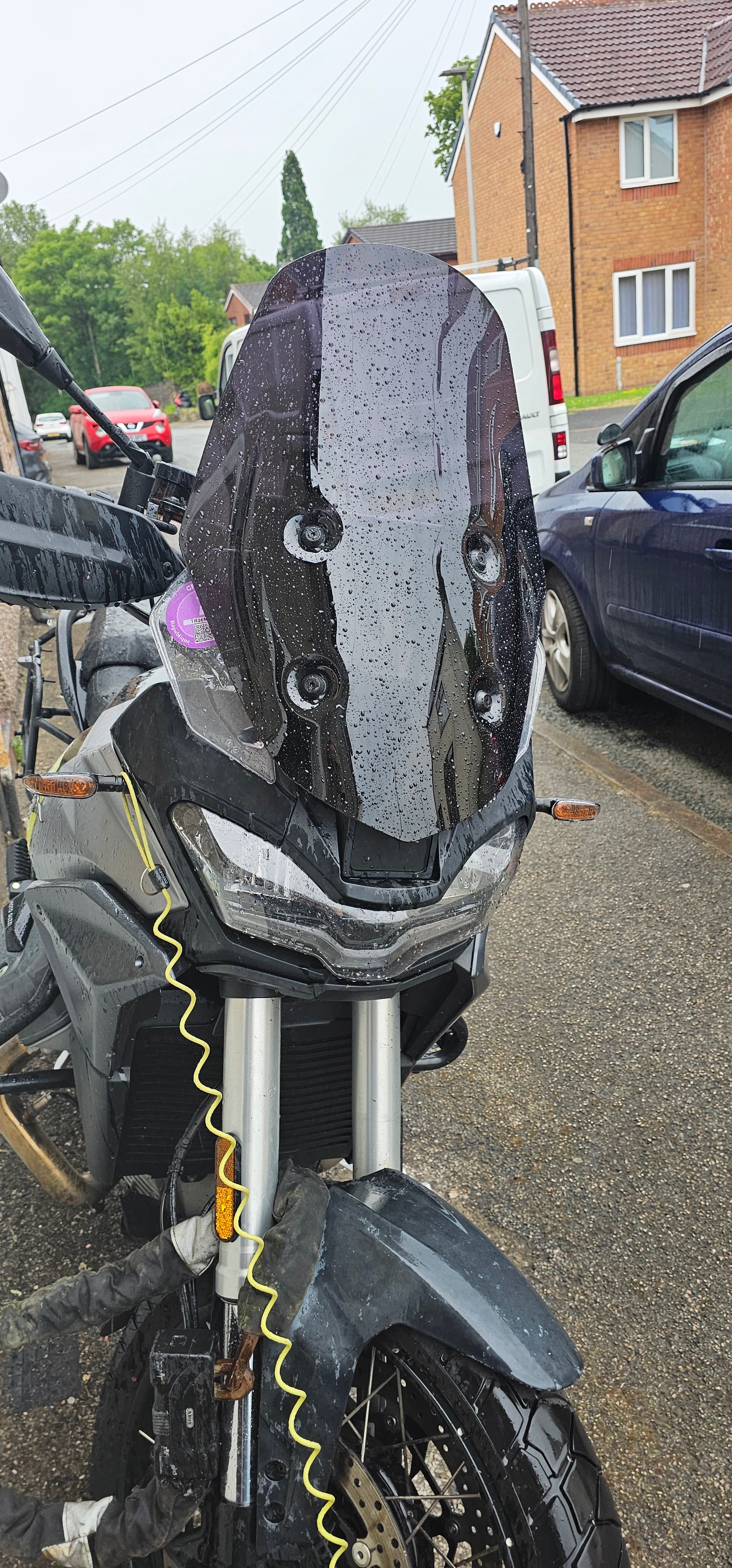

So, my Puig touring screen finally arrived and is fitted
I will, however, have to follow GuzziEagles instructions above to get the front radar back in operation. Might just go for a straight cut across the bottom edge though :thinking:
Where did you get the rain from? We need some here please! :roll_eyes:
Shame to change the shape. The front radar is of highly questionable benefit unless you buy the adaptive following cruise control option.
And that Barney is exactly why it needs fettling :laughing:
So, an update on the Puig screen.
I switched the forward radar off fir the ride into work last Sunday but after transferring my world into the truck I switched it back on. Now it’s not a great distance to where I park but the sensor didn’t go off.
Consequently, I rode home last night with the forward radar on. It worked as per the OE screen, happy days.
