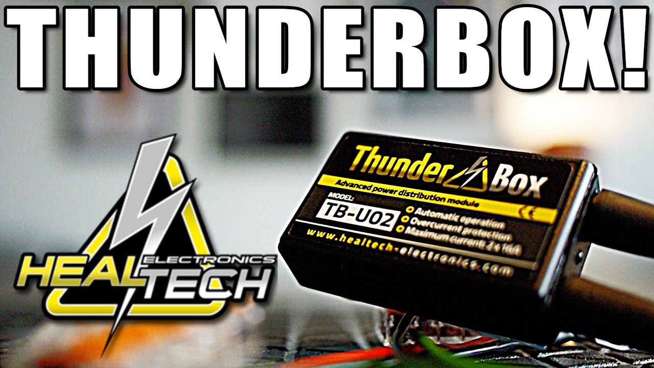

Initially I used a Thunderbox on my Stelvio
I’ve since swapped it for a PDM-60.
I’ve taken the switched “live” from the accessory socket hidden next to the rear light (where the OEM usb accessory plugs in).
The PDM 60 is programmed to delay power for 15 seconds, so I have time to start the engine before any extra electric load hits the battery (leaving full power for cranking)
The PDM 60 powers my heated grips (Oxford), sat nav and aux lights….
Very pleased with the setup….
