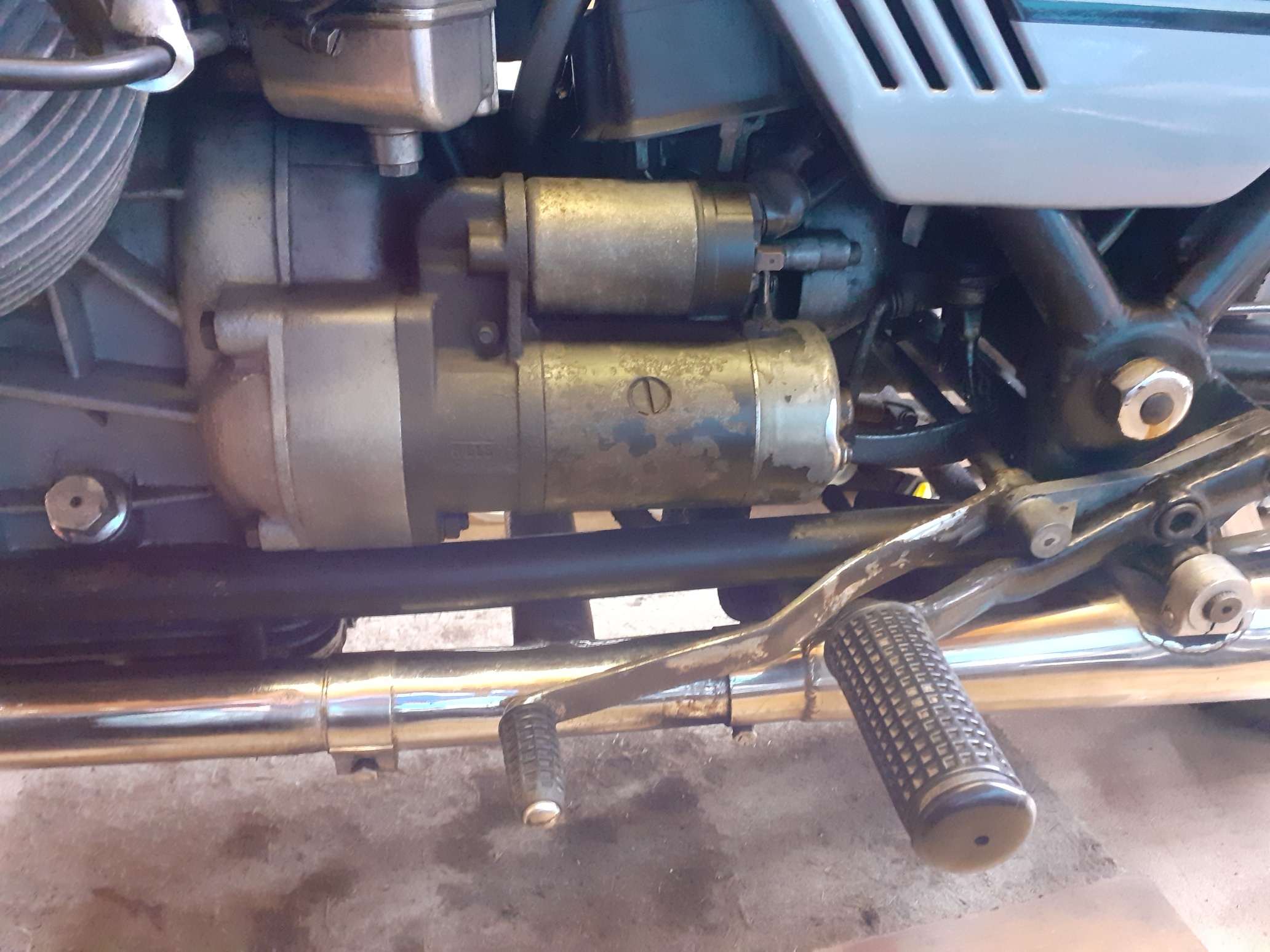

I removed the starter from my 850T in order to paint it, and when I removed the cap from the end I found that it was really filthy inside. Also, and more to the point, I found it hard to turn the motor by hand. I would have thought that it should be easy. It certainly has been with other starters that I have opened up.
Can anybody tell me if this is normal for a starter like this? I thought it might be caused by the solenoid, but even when I push the motor into its operating position it still won’t spin freely.

I did similar on my Spada recently (Bosch starter option). I guess there is quite a bit of friction in there with brushes etc. I did consider buying one of them dirt cheap Valeo copies as a replacement. You can get them for less than £50 off ebay. I went for the even cheaper option and put the old one back on. It worked fine before. It wasn’t broken, so gave it a squirt of WD40 and away we went.
I took mine apart many years ago to fix the centrifugal clutch (sprag clutch?) that engages the drive when it spins. Mine was filthy inside too, most of it dust from the brushes. I cleaned it all out with petrol and a toothbrush (no Autosol on the commutator ring in case I left any there to wear it) and had the end cap chromed. I sprayed the starter body with smooth silver Hammerite. It looks non-standard but makes the engine look bigger, just like the gearbox does from the other side! Poser moi?

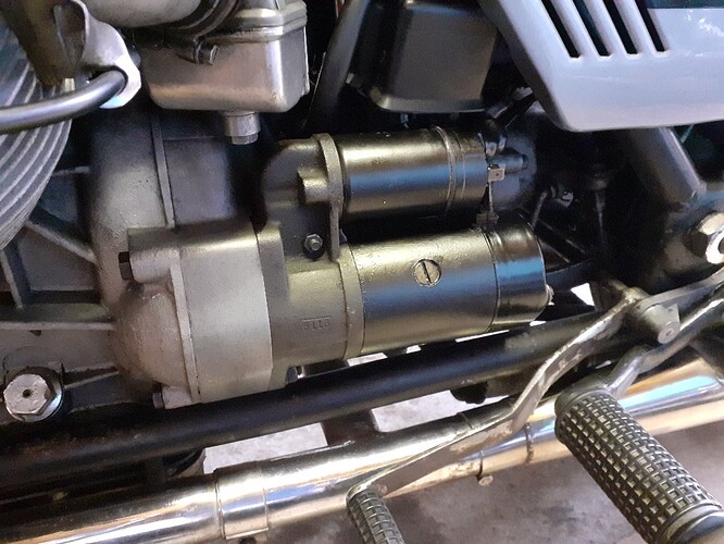

Thanks for your comments gents. I cleaned the inside of the starter and it is definitely working better now. Previously it was sometimes hestitant to turn the engine over, even when I had >12v in the battery. I had put this down to one of the pistons sitting close to max compression.
I repainted the starter in black, using a satin finish for the body and gloss for the end cap. It doesn’t look like new, but if it did it would stick out like a sore thumb. I now need to decide what to do about the very tired looking gear shift.
