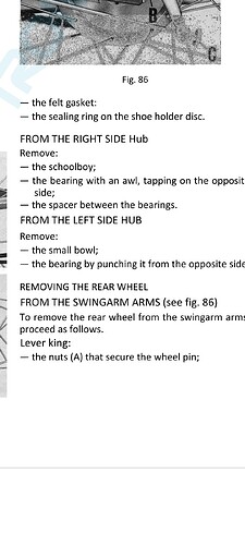

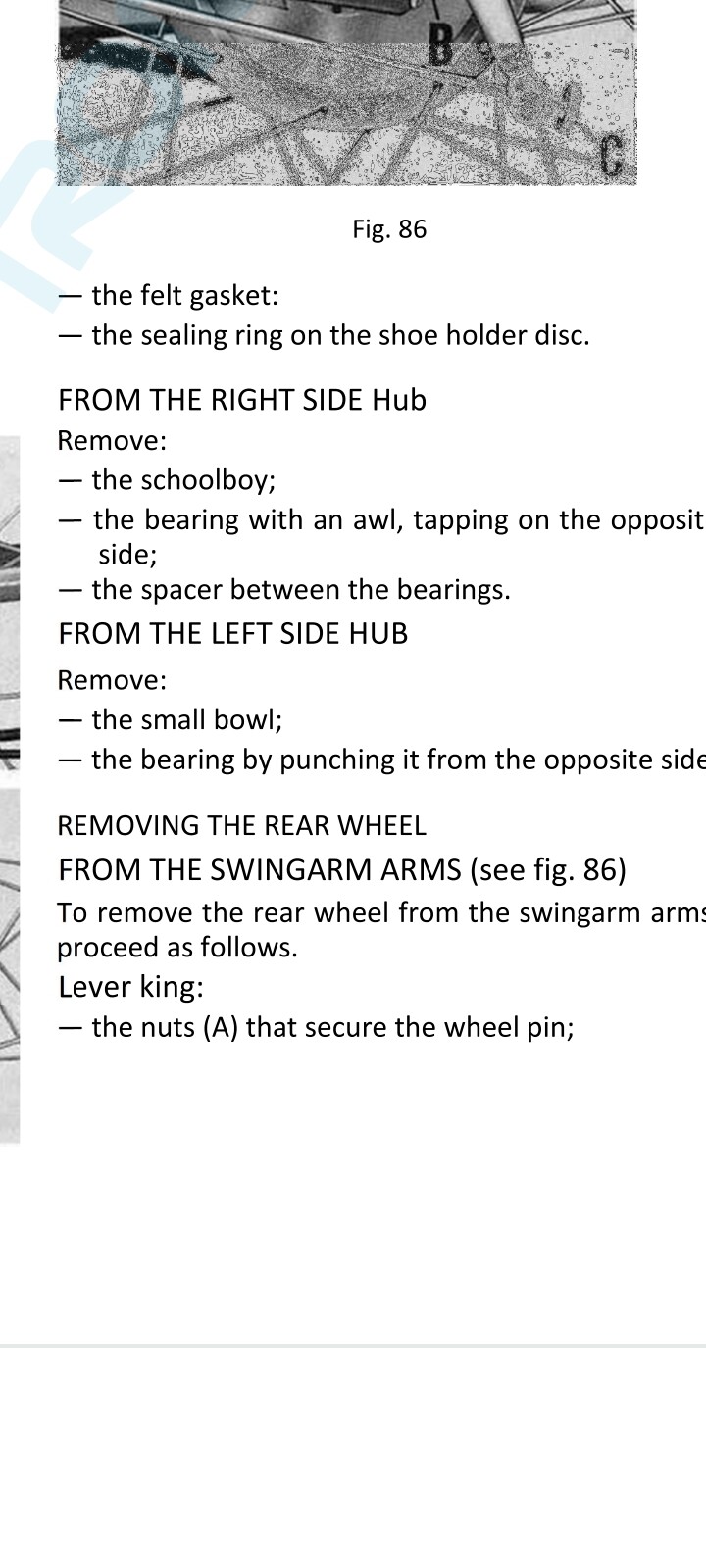

There is no obvious side to start knocking out bearings can anybody tell me what side to start? I have a manual translated into English, but its most confusing, particularly were it says Remove school boy???

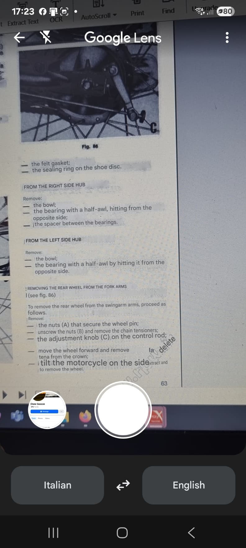

This is a screenshot from Google Translate on my phone, schoolboy (Scodelino) is a bowl, I assume it refers to the brakeplate on the left and the spacer on the right hand side.

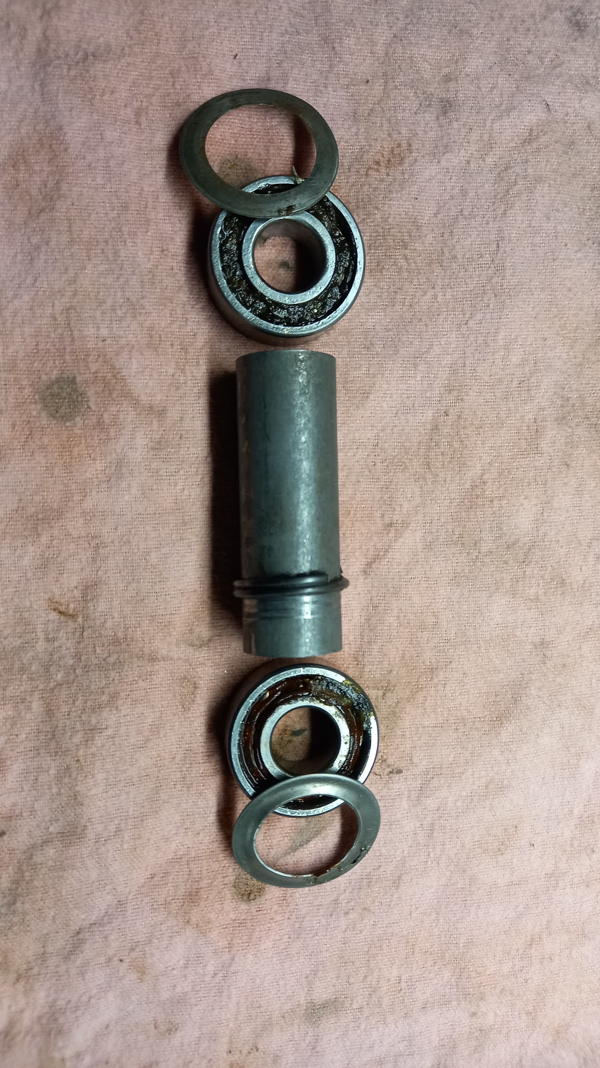

Thanks for that, I was refraining from jumping in with a big hammer, This is what I found, there was 2 dished washers, I think acting as grease seals. I will replace with sealed bearings, not sure if it will require the 2 washers on reassembly
Ah, that must be what they were referring to as a Scodelino, small bowl or schoolboy!
The text is quite poor quality in some of the scans of the Italian manuals. Schoolboy translates to scolaro in Italian, I would imagine that is how scodelino (bowl) got translated to schoolboy.
