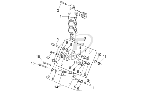

Am servicing the Connecting rod - rear shock knuckle. I notice there is only one ‘T’ bush on the spares list above. Mine is fitted to to the outside but the diagram suggests to me this should be from the inside. There certainly appears to be enough room. If it is not fitted from the inside then there is a large gap for you know what to get in there. Advice please.
The “T bush” - 10 on the diagram goes into the swing arm from the inside to support the hex screw that links the “double conrod” =3 on the diagram to the swing arm.
Thank you, mine is on the outside on dismantling and I could not believe that to be correct.
Much appreciated.

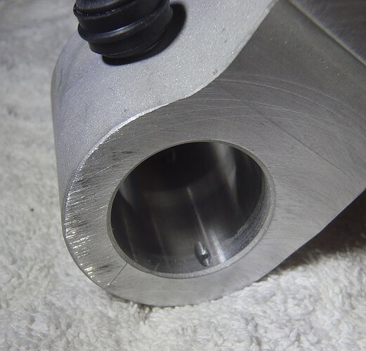

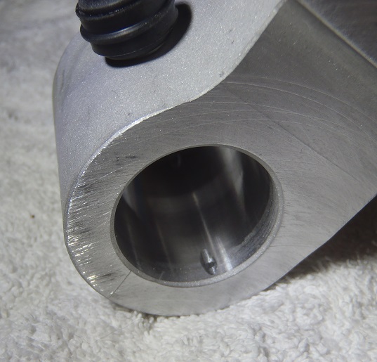

As for Grease Nipples, they can be fitted easily enough, but you have to place them accurately, to feed the Grease in-between the two pairs of side-by-side Bearings, and between the Seals and the Bearings, for the single Bearings.
You also need to drill some tiny (<1mm) holes to allow the old Grease to escape when you’re pumping fresh stuff in, otherwise you’ll just dislodge the Seals, even a mediocre Grease Gun can generate several hundred psi pressure.
The holes are sealed by the grease drying out in them, and need to be positioned as far away from, and diagonally opposite the Grease Nipples, so the Fresh Grease covers as much of the Bearing Surfaces as possible.

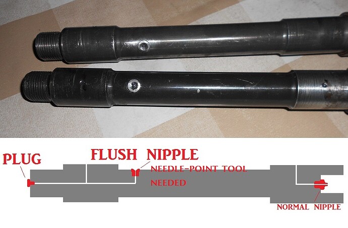

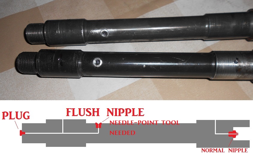

I also modified a few Swing-Arm Spindles, so the Swing-Arm Bearings can be greased in-situ, but again, as it’s such an easy job to strip and clean them, I’d recommend doing that.
A Grease exit hole on one side of a Double-Bearing, Nipple situated opposite, in the centre between the two Bearings.
Modified Spindles for the Swing-Arm.

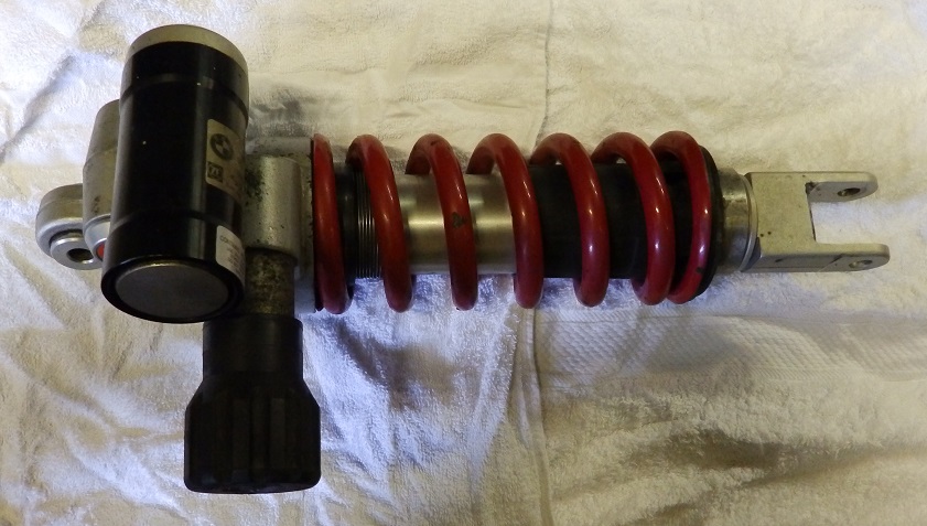

The Link is the one I made to fit a BMW S1000R Shock to my Stelvio.
I managed to fit the Stelvio Spring to it, along with the Stelvio’s Hydraulic Pre-Load Adjuster Assembly.
Just needed a different Collar machined up for the Base of the Spring Retainer.
The S1000R Shock has separate Comp & Rebound Damping Adjusters.
